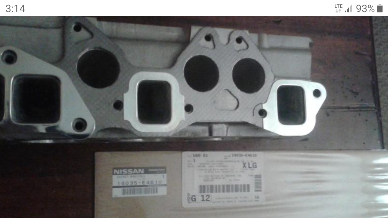

August 6, 20213 yr comment_626405 14 hours ago, DuckManNK said: Just wanted to share what the gasket looked like. That gasket isn’t correct for use with a header. It looks like an OEM gasket with a sandwich of metal and fiber. The header gasket is all fiber, with no metal embedded in it. Link to comment https://www.classiczcars.com/forums/topic/65682-grind-off-material/#findComment-626405 Share on other sites More sharing options...
August 6, 20213 yr comment_626419 You'll want to check the flatness and quality of the surface on the head. Maybe have both surfaces skimmed. There's another Datsun site out there with a couple of guys that say they don't use any gasket at all. They just mill both surfaces and bolt it up. They say it works but who knows. Anyway, the head surface is often overlooked. Link to comment https://www.classiczcars.com/forums/topic/65682-grind-off-material/#findComment-626419 Share on other sites More sharing options...
August 6, 20213 yr comment_626422 5 hours ago, Racer X said: That gasket isn’t correct for use with a header. It looks like an OEM gasket with a sandwich of metal and fiber. The header gasket is all fiber, with no metal embedded in it. I've never heard that before, what is the rational behind having no metal in the gasket? Link to comment https://www.classiczcars.com/forums/topic/65682-grind-off-material/#findComment-626422 Share on other sites More sharing options...
August 6, 20213 yr comment_626425 Mine's got a lot! Not in it but outside of it. Link to comment https://www.classiczcars.com/forums/topic/65682-grind-off-material/#findComment-626425 Share on other sites More sharing options...
