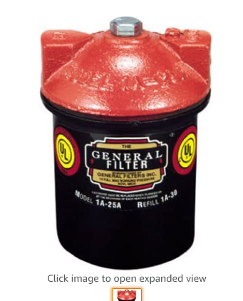

Depends also on the fuel rate you are expecting.
These are made for vacuum, pull-through, applications.  Furnace oil.  Kind of kidding but if you needed something to get you by until you could fix the tank, they'll hold a lot of crud and don't hinder flow.  Put a ball valve in front and it's easy maintenance.
https://www.amazon.com/General-Filter-1A-25B-Standard-8-Inch/
Edited by Zed Head
