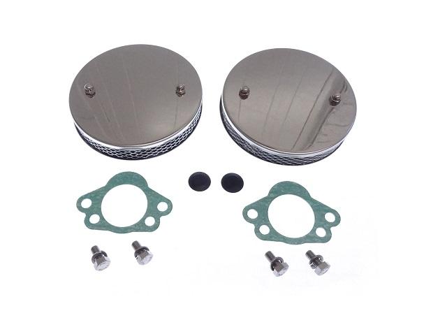

Notice I said cleaner”S”. They look more or less like this.
I did not take pictures of the actual situation.
Anyway, These flat pancake air cleaners fit just fine, AND they have a knipple ob the back for a rubber hose to run to the fuel bowl vents. I had faithfully put these back on with the air cleaner bodies of course, good little boy that I am. Little short black vacuum like thick walled hoses.
