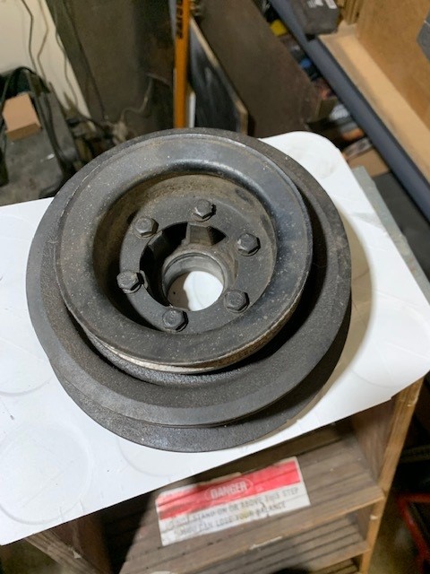

I think I may have a spare 2 row oem damper.   Will have to check in garage.
If you have one in good condition you are willing to sell I am all for it.

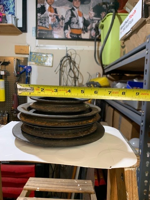

I was tearing the garage apart looking for some lost parts I had put in a "safe place" this morning, came across this boat anchor and thought of your post. Some of the valleys are rough and I don't know the history of the part, but I wont be putting AC on my car so PM me if needed.
