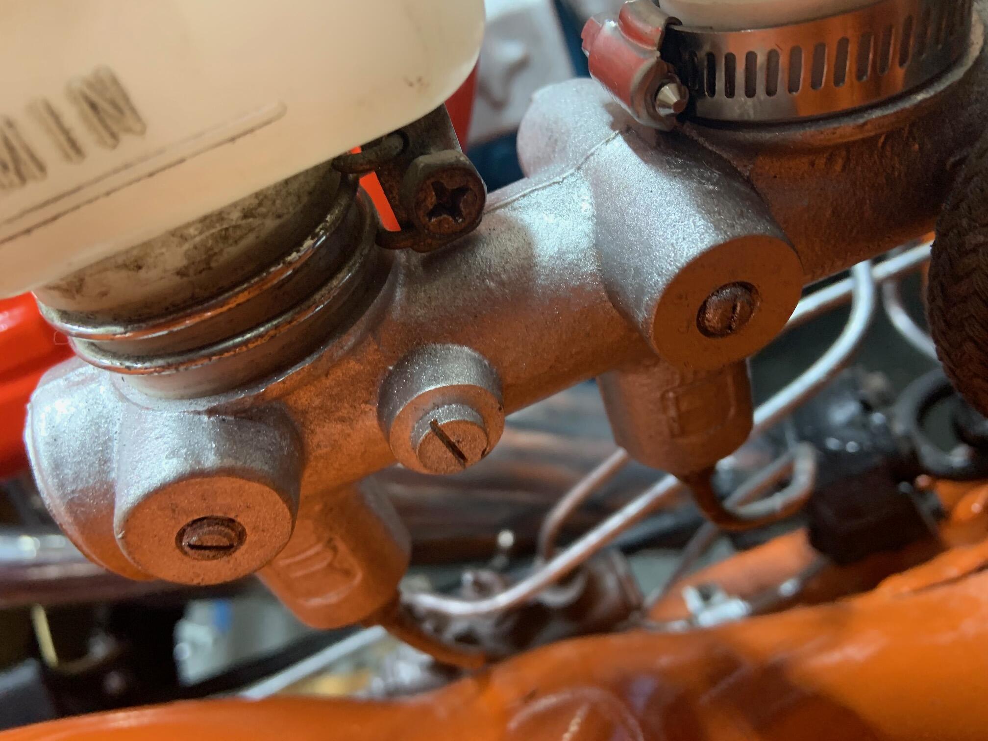

August 27, 20213 yr comment_627641 Bad bleeders bud. Bummer. New MC maybe? Yours seems oddly shaped. Where did it come from? Looks it might even have ports, or the bosses for ports, on the other side. Are they drilled and tapped? Maybe just swap them. Link to comment https://www.classiczcars.com/forums/topic/65707-air-cleaner-housing-connections/?&page=3#findComment-627641 Share on other sites More sharing options...
August 27, 20213 yr comment_627650 These are good points about the master cylinder. What brake booster and master cylinder do you have in the car? Link to comment https://www.classiczcars.com/forums/topic/65707-air-cleaner-housing-connections/?&page=3#findComment-627650 Share on other sites More sharing options...

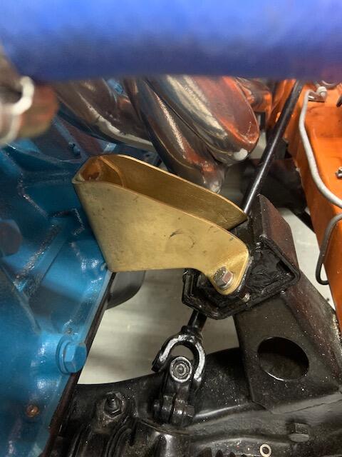

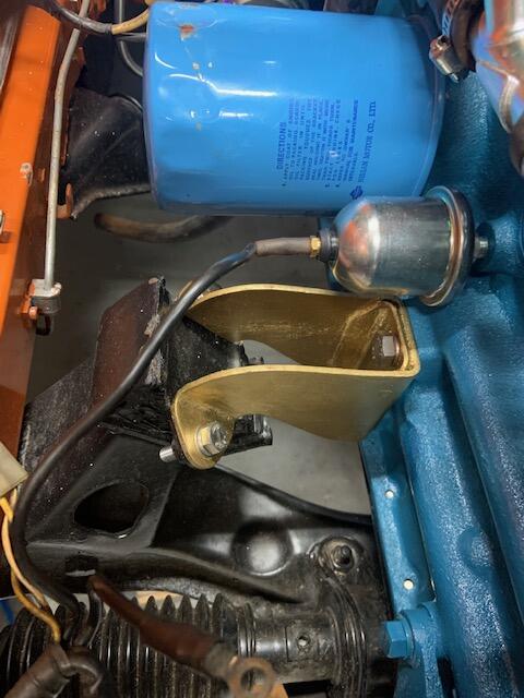

August 27, 20213 yr Author comment_627656 On 8/27/2021 at 1:43 AM, Zed Head said: Any chance you have a motor mount problem? I like to browse around the BAT site to compare to other cars. They take a lot of pictures. I took a few looks and it does seem like they have more room than you do. Here's a 71. https://bringatrailer.com/listing/1971-datsun-240z-187/ https://bringatrailer.com/datsun/240z/?q=240z So i have owned (a long time ago) a 72 and 73 240z. I never had this kind of issue with them. I was thinking a motor mount issue could be the problem too but i cant see any issue.... Here are the left and right...not sure if you can tell anything from the images though? Maybe i should put my big floor jack underneath and lift up the engine and one at a time try to loosen and "reset" each mount? Link to comment https://www.classiczcars.com/forums/topic/65707-air-cleaner-housing-connections/?&page=3#findComment-627656 Share on other sites More sharing options...

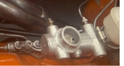

August 27, 20213 yr Author comment_627657 On 8/27/2021 at 2:32 AM, CanTechZ said: My 7/70 looks to have similar clearance to the shock tower as yours but my Brake M/C has the bleeders on the opposite side. Here are a couple of captures from a video I did of my car before I took it apart for the resto I currently working on. I be danged! So i am looking closer at my M.C. that came with the car. Image is on other side near fender wall. Looks like you can switch screws and bleed valves to opposite sides? Doesnt it? this would 100% fix my issue. Looking at images of other MC my doesnt look right. The fluid holding compartment, the rear is usually a straight tube. If i cant switch valves around i will buy a new MC and see. Edited August 27, 20213 yr by Wally Link to comment https://www.classiczcars.com/forums/topic/65707-air-cleaner-housing-connections/?&page=3#findComment-627657 Share on other sites More sharing options...
August 27, 20213 yr comment_627658 That's good news, hopefully the threads are the same. Let us know how it works out. Link to comment https://www.classiczcars.com/forums/topic/65707-air-cleaner-housing-connections/?&page=3#findComment-627658 Share on other sites More sharing options...
August 27, 20213 yr Author comment_627668 threads were same. just moved things around... there was a tiny round ball that goes in first on side you are sealing off, then put set screw in and tighten. Finally something is an easy fix Link to comment https://www.classiczcars.com/forums/topic/65707-air-cleaner-housing-connections/?&page=3#findComment-627668 Share on other sites More sharing options...
August 27, 20213 yr comment_627669 On 8/27/2021 at 6:15 PM, Wally said: Finally something is an easy fix Make sure you can bleed the brakes before you say that. Link to comment https://www.classiczcars.com/forums/topic/65707-air-cleaner-housing-connections/?&page=3#findComment-627669 Share on other sites More sharing options...
August 27, 20213 yr Author comment_627678 On 8/27/2021 at 6:38 PM, SteveJ said: Make sure you can bleed the brakes before you say that. dang. you just burst my bubble. Yeah.... i put some fluid in the resevoirs and turned that bleed valve on the brake MC and nothing came out. I am thinking it should? i understand why and how to bleed and the brake lines but I am not sure why you bleed the valve from the MC? Link to comment https://www.classiczcars.com/forums/topic/65707-air-cleaner-housing-connections/?&page=3#findComment-627678 Share on other sites More sharing options...
August 27, 20213 yr comment_627680 On 8/27/2021 at 10:52 PM, Wally said: i understand why and how to bleed and the brake lines but I am not sure why you bleed the valve from the MC? Same reason, you can have air in the master cylinder that gets 'stuck' in there rather than passing into the lines and ultimately to the corners of the car. I ran into this with in replaced all my brake components a few months back. After bleeding the master cylinder I was able to get enough pressure to then bleed the corners and all was good. Link to comment https://www.classiczcars.com/forums/topic/65707-air-cleaner-housing-connections/?&page=3#findComment-627680 Share on other sites More sharing options...
August 28, 20213 yr comment_627681 On 8/27/2021 at 10:52 PM, Wally said: dang. you just burst my bubble. Yeah.... i put some fluid in the resevoirs and turned that bleed valve on the brake MC and nothing came out. I am thinking it should? i understand why and how to bleed and the brake lines but I am not sure why you bleed the valve from the MC? You should be able to push fluid through the bleeder screws at the MC. It's just like pushing brake fluid through the calipers and wheel cylinders. Link to comment https://www.classiczcars.com/forums/topic/65707-air-cleaner-housing-connections/?&page=3#findComment-627681 Share on other sites More sharing options...
