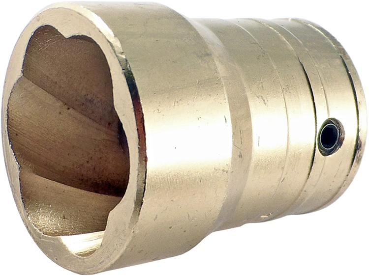

August 18, 20213 yr comment_627155 On 8/16/2021 at 10:47 AM, Shawninvancouver said: It’s a 9 spline. I do not have a welder. It’s not a full spline down the whole length of long lug. It’s smooth like a cone most of the way then tiny grooves at the bottom. I have hammered a socket on there so bloody hard. Then tried to hammer the socket wrench. It keeps slipping off as it’s on a smooth lug. I will try to dremsl flat sides on the end to get an open ended wrench on. I would just like to find the bloody key. Not on Amazon or eBay or even in the 16 part key set. If it is a puzzle lock, the only way to get a replacement key is to have the code that came with the locks when new, then contact the manufacturer and request a replacement key. Otherwise a replacement will be impossible to get. The reason you can’t get a socket hammered on to work is because the nut is smooth, so there isn’t anything for the socket to bite into. You may find success using a dremel to cut some flats into the nut and then force a socket on to try and remove it. If you are going to keep trying to work on your car yourself, you need to invest in some good quality tools, and I’m not talking Harbor Freight. At this point you will be better off taking it to a shop where an experienced mechanic can get it done. Link to comment https://www.classiczcars.com/forums/topic/65709-what-spline-lug-lock-is-this/?&page=6#findComment-627155 Share on other sites More sharing options...
August 18, 20213 yr comment_627156 https://www.gorilla-auto.com/replacement-keys "A Wheel Lock Registrations Key is required to identify the unique key for all Original Gorilla Wheel Locks, X2 Locks, Gorilla Guard or Small Diameter Wheel Locks. Replacement Small Diameter Lug Nut and Hex Lug Nut Sockets can also be ordered using Key Registration Number or Part Number stamped on your Gorilla socket. Why do I need my Wheel Lock Key Registration Number? We are the leading wheel lock manufacturer for good reason, your unique wheel locks and key are nearly impossible to identify through simple visual inspection. Your unique key/lock combination is one of thousands of possible combinations which means your investment is protected." Link to comment https://www.classiczcars.com/forums/topic/65709-what-spline-lug-lock-is-this/?&page=6#findComment-627156 Share on other sites More sharing options...
