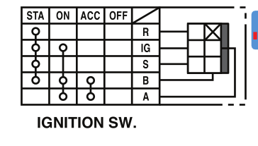

I had this same issue on my 1971 240Z, albeit after a complete rewire of the entire car. The car would start and run fine but the tach was completely dead, turns out I had the two B/W wires backwards. Skimming through the thread I believe some of the others have already addressed the diagnostics really well, and if I remember correctly how the circuit works the ballast resistor gets switched out of the circuit when the key is in the Start position so that the coil can be connected to the full battery voltage for starting the engine. It gets switched back into the circuit in the run position to keep the coil operating at a reduced voltage, since it would get burned out operating at full voltage for an extended period of time. Someone correct me if I am wrong, but the ballast resistor is actually there to protect the coil, and the points condenser on the distributor is for protecting the points themselves.
Anyway, sounds like it could be an issue with the Tach itself but might be worth swapping the two B/W wires just for kicks. Pretty quick way to rule out the issue I had.
That's interesting.  It implies that 2 and 5 are both powered at Start, otherwise there would be no power to the coil at Start if the wires were switched.  I thought that 2 switched off at Start.  The diagram seems to show that every pin is powered on the bottom position which should be Start, which doesn't seem right.  Usually accessories are disconnected for Start.  5 is shown as bypassing the resistor which should be the Start circuit.  Kind of confusing.
Switching the wires would bypass the tach and the resistor at Run.  Makes sense that the engine would run but the tach would not work.
Edit - looking more closely at the grainy drawing I think I see small circles at 1, 3, and 5.  Matching AnvilZ's post below.  Doesn't answer the question though.
Yes, I have my doubts about the swapping of the wires. I'll have to test that this weekend. Anyway, I believe the OP has his car wired correctly, so I hope he didn't swap wires.
It might start as soon as the key is let back from Start to On, wired that way.
I recall some old posts about early ignition switches being different.  There was discussion about losing power during starting, to radios or AFR gauges or or Megasquirt controllers or something.
I agree that it doesn't make sense from a schematic standpoint that the car would start with the wires swapped, and I seem to recall being confused by what the original schematic was saying compared to what I was actually seeing on the car. Sorry I can't remember all the details this was almost a year ago, but I specifically recall switching the two and that fixing my tach issue. Take it with a grain of salt, I completely rewired my car myself so good chance something got messed up along the way. Still works perfectly for now, fingers crossed it stays that way.
Like I said it is most likely an issue with the tach itself in this case, but I would just be curious to see if swapping the B/W fixes the problem on this car as it did on mine (or even allows the car to start and run).
