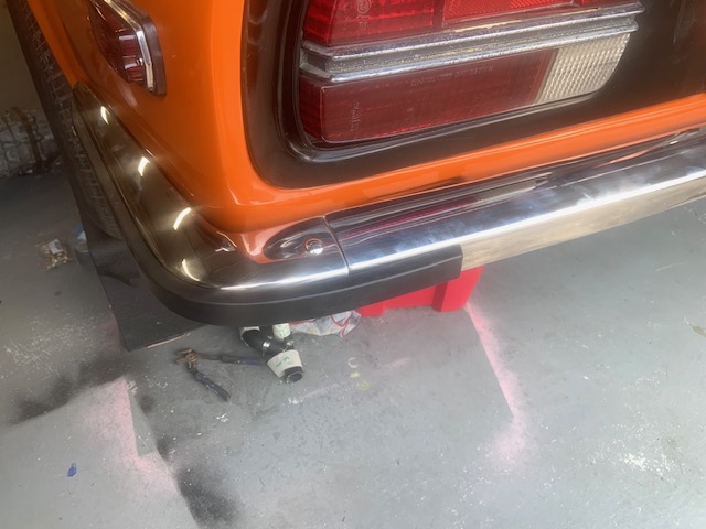

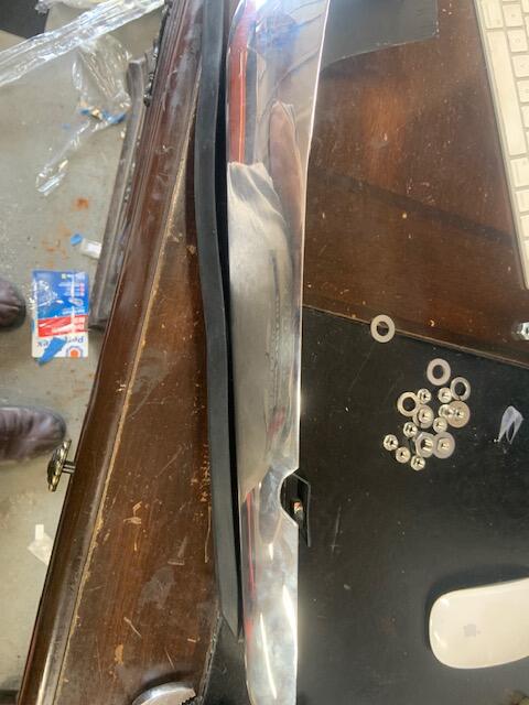

Posted August 14, 20213 yr comment_626922 I am just not getting to putting on my new bumpers. I am on the back sides currently. the rubbers are on and tightened up but look bad. they dont hug the bumper. I am not supposed to use some type adhesive am I? Link to comment https://www.classiczcars.com/forums/topic/65717-bumper-rubber-issue/ Share on other sites More sharing options...
August 14, 20213 yr comment_626926 22 minutes ago, Wally said: I am just not getting to putting on my new bumpers. I am on the back sides currently. the rubbers are on and tightened up but look bad. they dont hug the bumper. I am not supposed to use some type adhesive am I? A project dear to my heart as I'm doing the same with my '71. No adhesive required. I think if you loosen nuts on the mounting studs on the rubber pieces just a bit, you'll find that there is a little "slop" in how the studs fit through the mounting holes in the bumpers and over riders. That gives wiggle room to adjust the fit and remove the gap between trim and bumper before tightening the nuts on the studs. My front bumper was easy and the rear is a nightmare. The mounting studs on the trim are rusted and I have to use a hacksaw between the trim and bumper face to cut the mounting studs. Link to comment https://www.classiczcars.com/forums/topic/65717-bumper-rubber-issue/#findComment-626926 Share on other sites More sharing options...
August 15, 20213 yr Author comment_626965 So i had the rear and front rubbers on wrong ends. It was easy to do. Anyway when i changed them and realized they cover up one of the chrome bolt holes it looked much much better. almost no gap Link to comment https://www.classiczcars.com/forums/topic/65717-bumper-rubber-issue/#findComment-626965 Share on other sites More sharing options...
August 15, 20213 yr comment_626973 58 minutes ago, Wally said: So i had the rear and front rubbers on wrong ends. It was easy to do. Anyway when i changed them and realized they cover up one of the chrome bolt holes it looked much much better. almost no gap Success! No rear bumper over riders? Link to comment https://www.classiczcars.com/forums/topic/65717-bumper-rubber-issue/#findComment-626973 Share on other sites More sharing options...
August 15, 20213 yr Author comment_626985 the S.S. repros dont have them. I do have my old over riders though. When i am done with the car i will assess if i want to go back and "add" them. Link to comment https://www.classiczcars.com/forums/topic/65717-bumper-rubber-issue/#findComment-626985 Share on other sites More sharing options...
