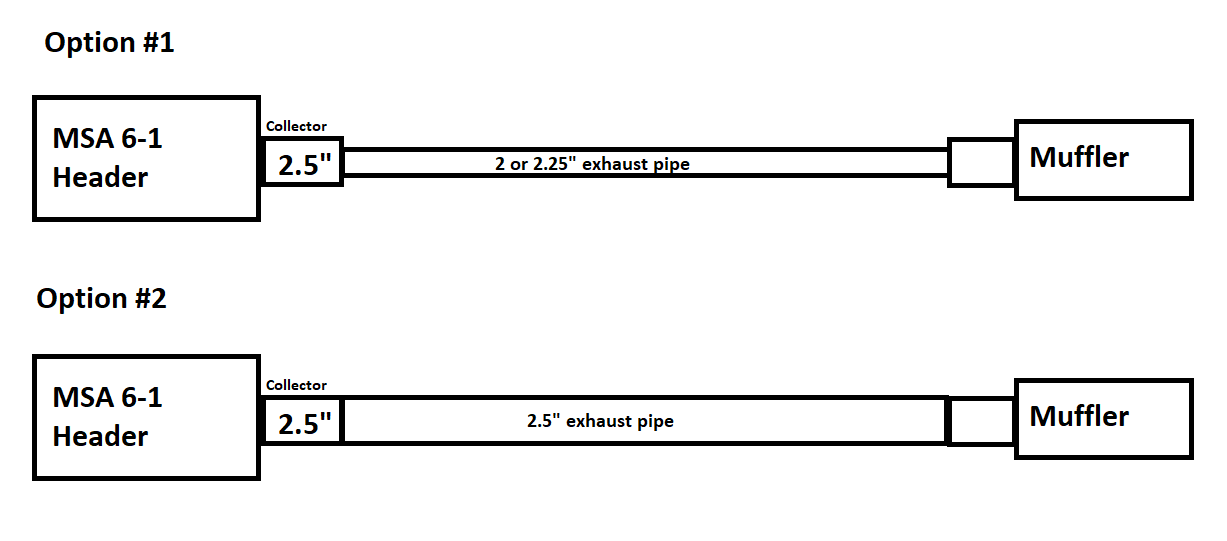

Hi Guys,
Need a little help understanding scavenging and the impact of changing pipe size through an exhaust setup. Is there a negative or positive impact to reducing exhaust pipe diameter after a header collector?
Context:
I have a stock 1977 280z with L28 and no modifications. I will be installing a new exhaust later this year. I have an MSA 6-1 which features a 2.5" collector and am planning on buying a Zstory muffer which also features a 2.5" inlet.
I read on the forums that for an unmodified setup, the 2" or 2.25" setup is ideal for torque due to scavenging/velocity and that 2.5" may have a positive impact on high RPM HP, but at the expense of my wonderful low end torque. If I dropped down to a 2" or 2.25" pipe immediately after the header collector and ran that back to the muffler, would that provide the scavenging required to maintain torque for an unmodified engine? Or would that negatively impact exhaust velocity and therefore is a bad idea?
Basically, at any point that the exhaust gasses encounter a change of diameter larger than where they came from, they expand (lose energy / velocity) and send a shock wave back up the exhaust tract.
Now, in your situation you are not expanding but taking an existing travelling pressure wave and compressing it - in effect, this is creating a bottle neck / back pressure.
For proper scavenging, you ideally want the pipework to be the same diameter from the collector point all the way back to a resonator / muffler to avoid suffocating (smaller pipe) or introducing new expansion harmonics (larger pipe).
I had an MSA 6-3-2 header with 2.5” pipe all the way back to a turbo muffler with no resonator in between. The torque curve was utterly delicious.

On both your drawings, you're missing a resonator which'll not only eliminate the exhaust drone from your 6-1 but will increase the scavenging effect. Fit one of my complete lines without the resonator and not only will it be noisier (no better sound, just more decibels to p*ss off your neighbours and the cops) but should be down as much as 30-40hp on a mildly-tuned performance engine.
I'm not advocating buying one of my systems so this is what I'd reccommed :
MSA (no-smog) 6-2 (Code: 15-6001 Price:$252.87) 2.5" pipe then convert that 2-1 pipe to become 1x pipe at the rear of the transmission then fitting a resonator before continuing out to your muffler. The header isn't expensive, sell off your 6-1 to recover something, get MSAs Performance exhaust (Code: 15-6021 Price:$174.95)
With selling off the 6-1, it should cost you about $350 then spend some on extending that secondary pipe and fitting a resonator. You won't get better performance for less !
@Sean Dezart Thanks for the feedback! Yeah, from what I heard the resonator is a must. Had the opportunity to see one of your mufflers in action a couple of months ago. Love your stainless setup so that is where I am headed. Might try to put the headers up for sale this winter and see if I get any takers.
