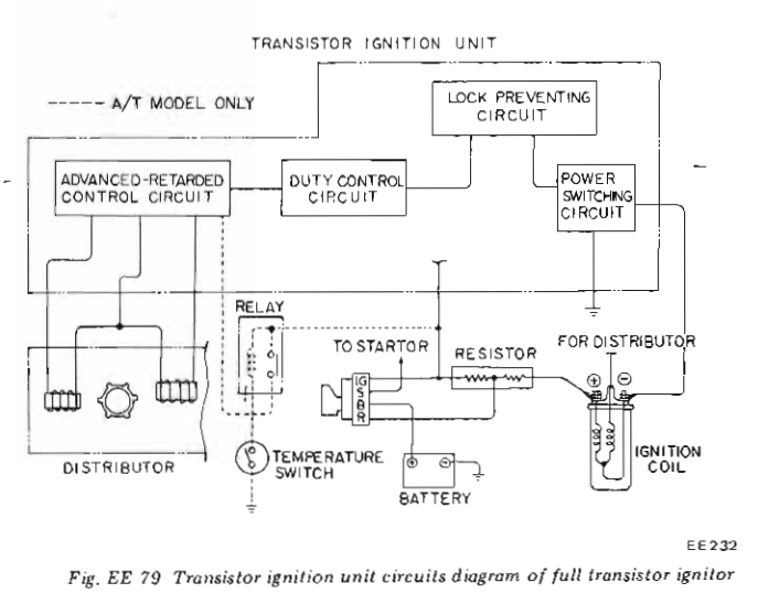

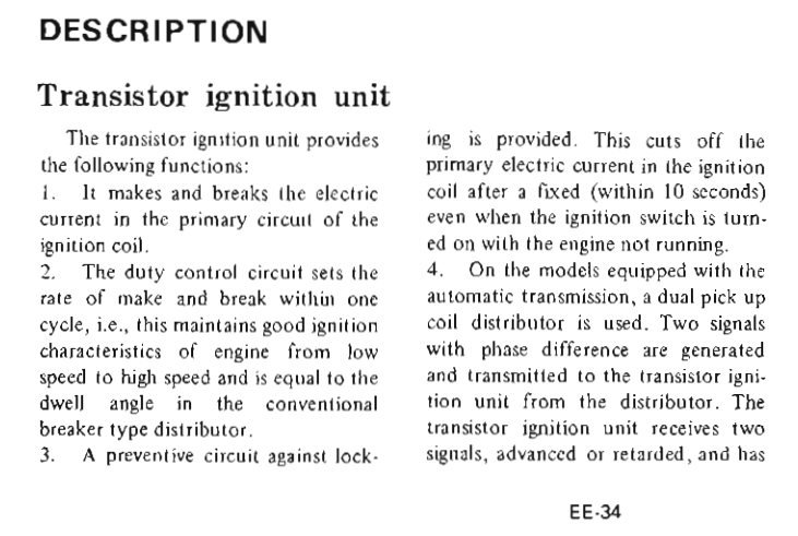

November 10, 20213 yr comment_631289 54 minutes ago, Dolfinz said: it wouldn't start. I determined there was no spark and the voltage at the coil was around 5vdc. If you have the factory ignition module you should see battery voltage minus resistance drop, then it should go to battery voltage after 10 seconds (no current). For what it's worth. Not really sure why they call it "locking". Link to comment https://www.classiczcars.com/forums/topic/65733-battery-drain/?&page=4#findComment-631289 Share on other sites More sharing options...
November 10, 20213 yr comment_631292 31 minutes ago, Zed Head said: If you have the factory ignition module you should see battery voltage minus resistance drop, then it should go to battery voltage after 10 seconds (no current). For what it's worth. Not really sure why they call it "locking". "Locking" means it is locking out the power switching circuit, so the coil never gets grounded. This is similar to why you don't want to leave the key in ON with the engine not running when you have points, only you are protecting other components. Link to comment https://www.classiczcars.com/forums/topic/65733-battery-drain/?&page=4#findComment-631292 Share on other sites More sharing options...
November 10, 20213 yr comment_631293 5 minutes ago, SteveJ said: "Locking" means it is locking out the power switching circuit, so the coil never gets grounded. It says "lock preventing". I know it's just a translation error. Interesting though. There are better terms - current lockout? Current cut? Link to comment https://www.classiczcars.com/forums/topic/65733-battery-drain/?&page=4#findComment-631293 Share on other sites More sharing options...
