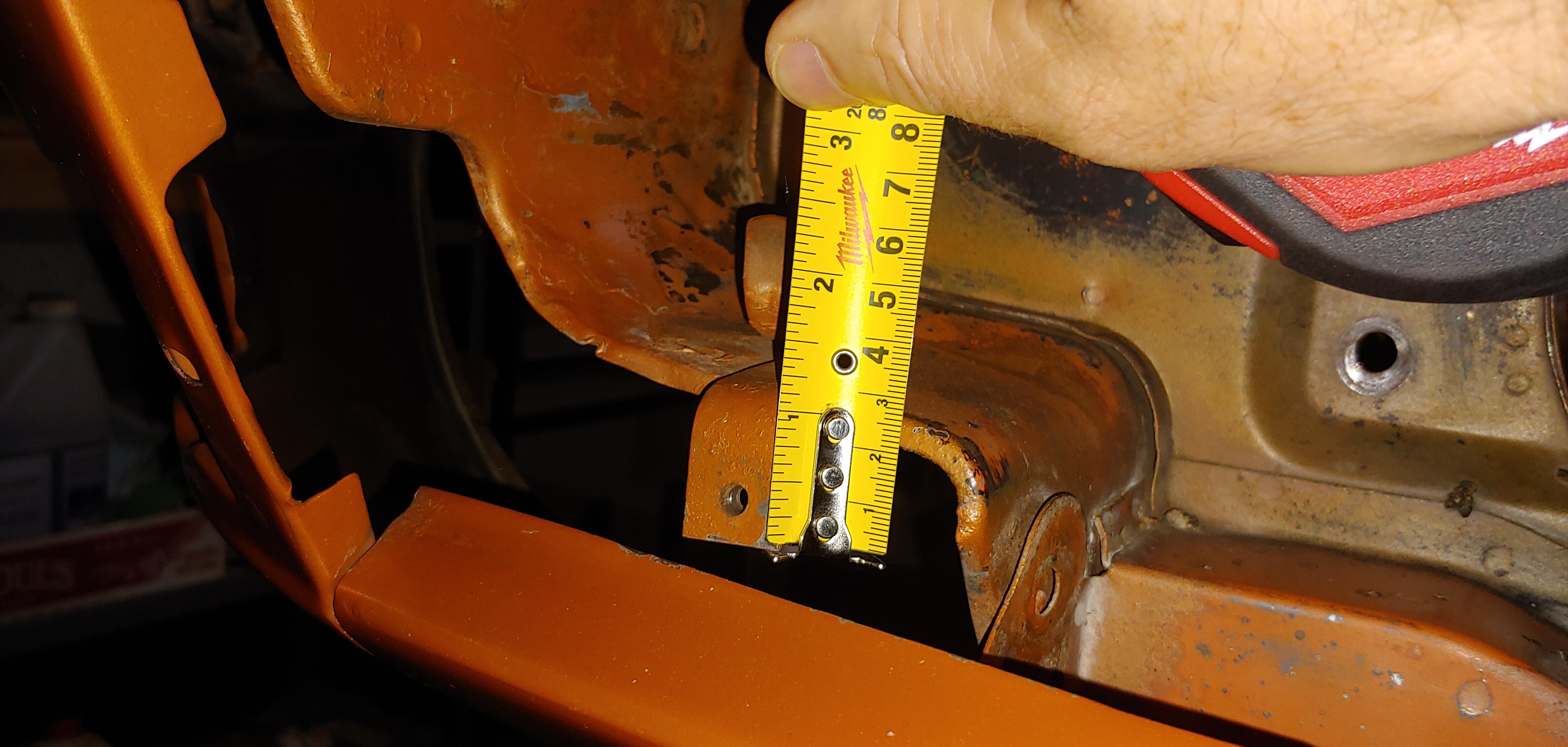

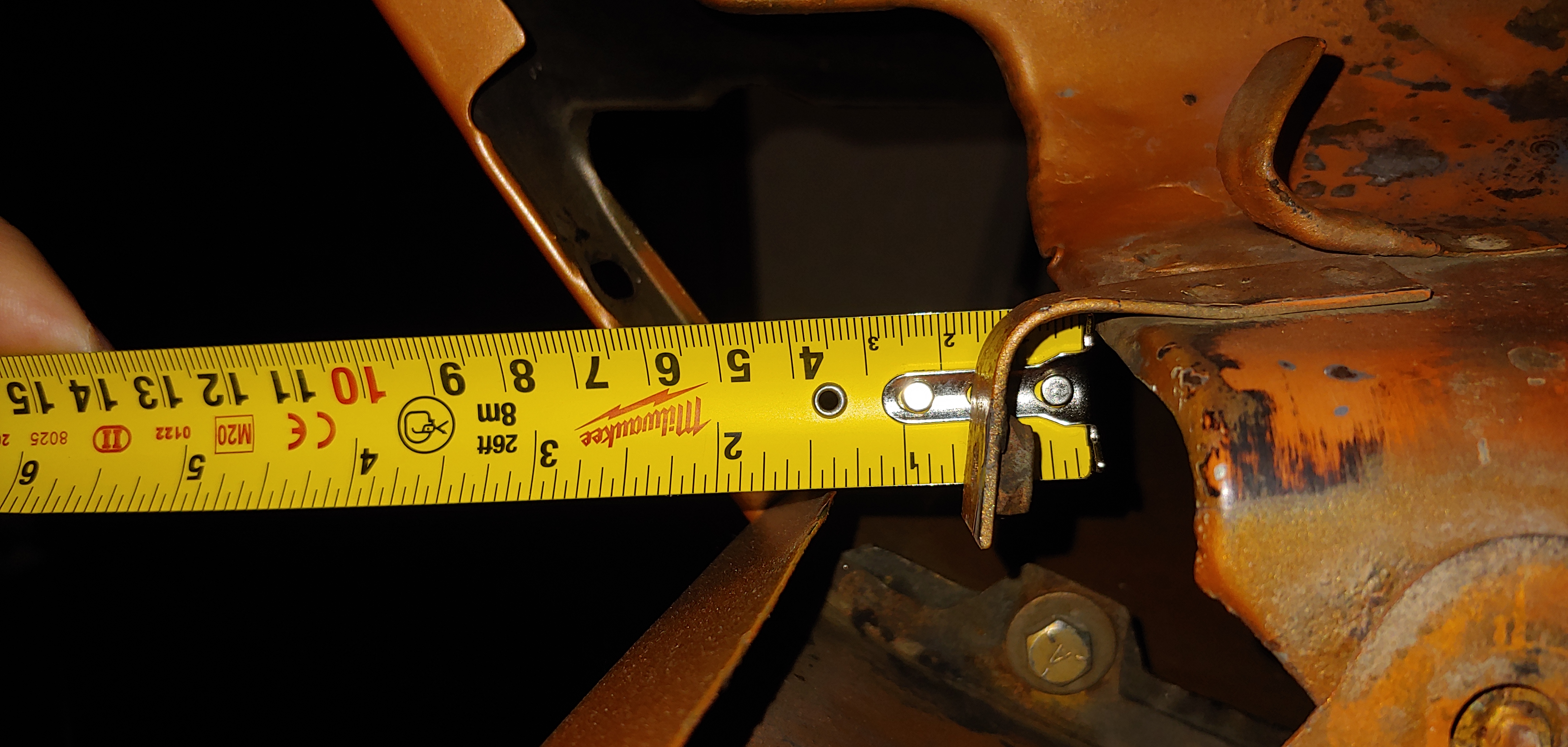

Well that's interesting. It appears as though the 73 (my car) has a slightly different grille as the mounting tabs on my car clearly bend up.  And...the parts catalog bears that out: 62300-E4601 is for the 70-72 and 62300-N3301 is for the 73. The different grille accommodated the 73's bumper mounts.
16 minutes ago, Patcon said:
It looks like his tabs are on upside down. When he bends them up the nuts will be on the front facing side of the tab. Not on the rear side like the examples
I think Wally's car is a 1971 so he will be bending the tabs down and the nut will be correct. @Wallycan you confirm that.
yes 1971. I did bend upward.  I did have to make some "Adjustments" to get them to fit snugly but its all on tight now. The hole was too high so i made a new hole lower.
