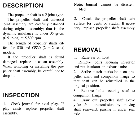

Ok, removing the driveshaft is not as easy as it sounds. Whats the trick.
Do you mean the propeller shaft?  The driveshafts are the two to the wheels.  It's a Nissan thing.
Find a wrench that fits the nuts tightly and will wedge against the body if you turn the shaft.  Then turn the shaft to break the nuts loose.  You should have the D head bolts so all you have to worry about is the nuts.  Find wrench, fit wrench in right place on nut, stick screwdriver in u-joint to turn shaft, wedging wrench against body.  X 4.
Once you get the nuts off you might have to tap/beat on the flange to break it loose.  There's a raised centering circle that fits a recess in the diff.  It's a tight fit.
