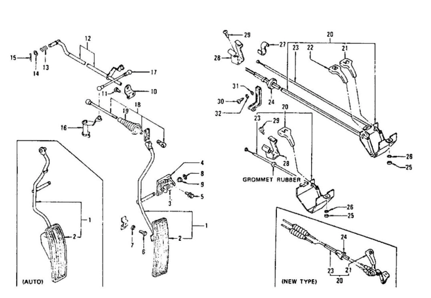

Removed the center console to replace the shifter boot and found this retainer bracket laying under the fuse block. Does it go under this bolt to hold up the choke cables?
There is a L shaped piece shown in the diagram. It does look to be a different shape though. No reference number for that one of course.
As it was just laying there, It might have come from further up in the dash. I am sure others will know.
