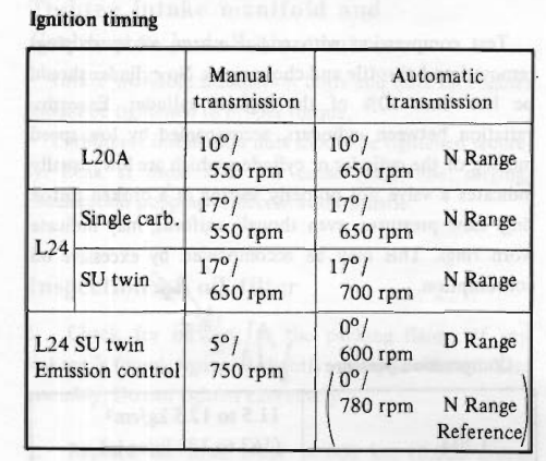

May 19, 20222 yr comment_640569 I run 93 pump gas with a ZX distributor and full advace on my '72 2.4. If I remember right it's 17 and 34 at 3,000 rpm. Link to comment https://www.classiczcars.com/forums/topic/65780-new-membernew-to-zs/?&page=6#findComment-640569 Share on other sites More sharing options...
May 19, 20222 yr comment_640570 Is your advace hose hooked to the front carb? Link to comment https://www.classiczcars.com/forums/topic/65780-new-membernew-to-zs/?&page=6#findComment-640570 Share on other sites More sharing options...
May 19, 20222 yr Author comment_640572 Yes Link to comment https://www.classiczcars.com/forums/topic/65780-new-membernew-to-zs/?&page=6#findComment-640572 Share on other sites More sharing options...
May 19, 20222 yr comment_640574 I think the factory setting for a 240 is about 5 Degrees. But it has been a LONG time since I was stock 2.4 liter. My initial timing is about 12 degrees now with a max of 36, but I am running an MSD dizzy with an all mechanical advance due to triples. You are blessed with a factory stock car so lets get the settings back to stock. I think you should be at 5 degreed BDTC with no the Vac Advance plugged. Correct me guys on this if I am misspeaking. Lets get our friend back on track. If you are running 20 degrees on your stock car, it may be aiding your high idle. Link to comment https://www.classiczcars.com/forums/topic/65780-new-membernew-to-zs/?&page=6#findComment-640574 Share on other sites More sharing options...
May 19, 20222 yr Author comment_640580 I haven’t put a timing light on it yet but I seriously doubt it has 20 initial. Link to comment https://www.classiczcars.com/forums/topic/65780-new-membernew-to-zs/?&page=6#findComment-640580 Share on other sites More sharing options...
May 20, 20222 yr comment_640581 Link to comment https://www.classiczcars.com/forums/topic/65780-new-membernew-to-zs/?&page=6#findComment-640581 Share on other sites More sharing options...
May 20, 20222 yr Author comment_640592 Thanks Zed! Link to comment https://www.classiczcars.com/forums/topic/65780-new-membernew-to-zs/?&page=6#findComment-640592 Share on other sites More sharing options...
May 20, 20222 yr comment_640600 That's right! Thanks for posting that Zed!!! See my memory is getting horrible. Link to comment https://www.classiczcars.com/forums/topic/65780-new-membernew-to-zs/?&page=6#findComment-640600 Share on other sites More sharing options...
