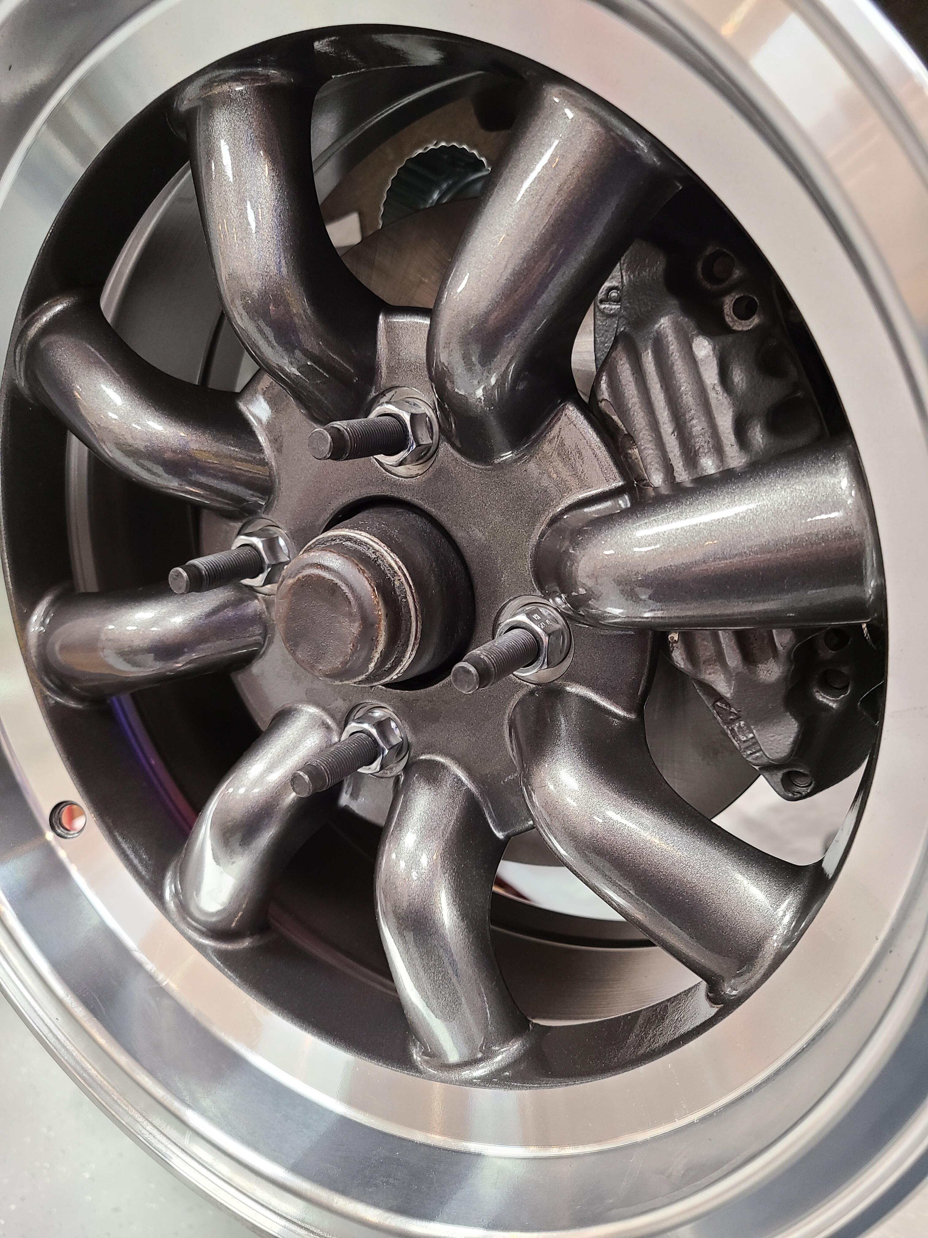

I had to do that to fit my 14” rims and took off a full 5mm off the fins. The way I figure it is that those callipers were designed to stop a two tonne truck and my Z will never stress them enough to need the fins.
Yes, the Rewinds don't come close to fitting over the S12 + W calipers.  They only need to be ground down at the inner corner, the rest of the fins can stay in place.  I also needed to install longer studs to get proper thread engagement on the Rewinds.  Make sure you have enough threads engaged.

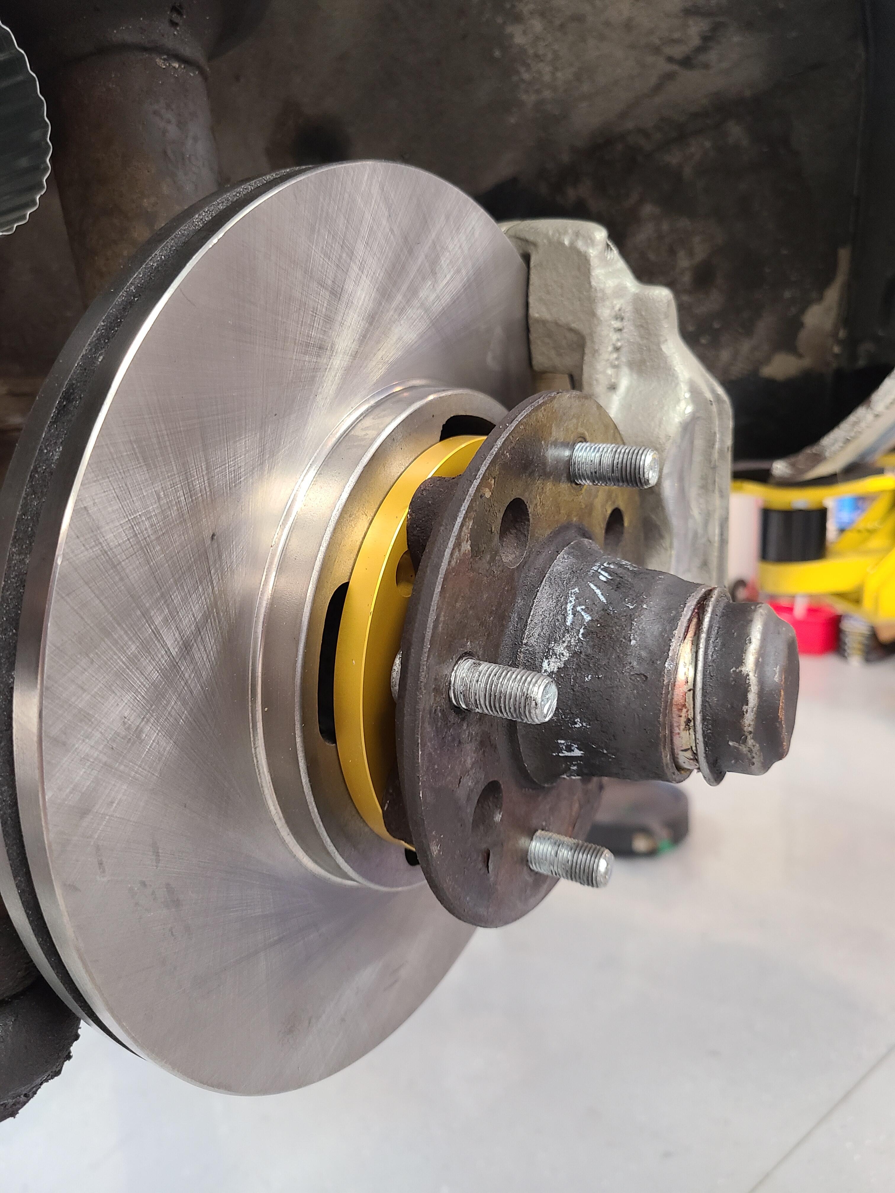

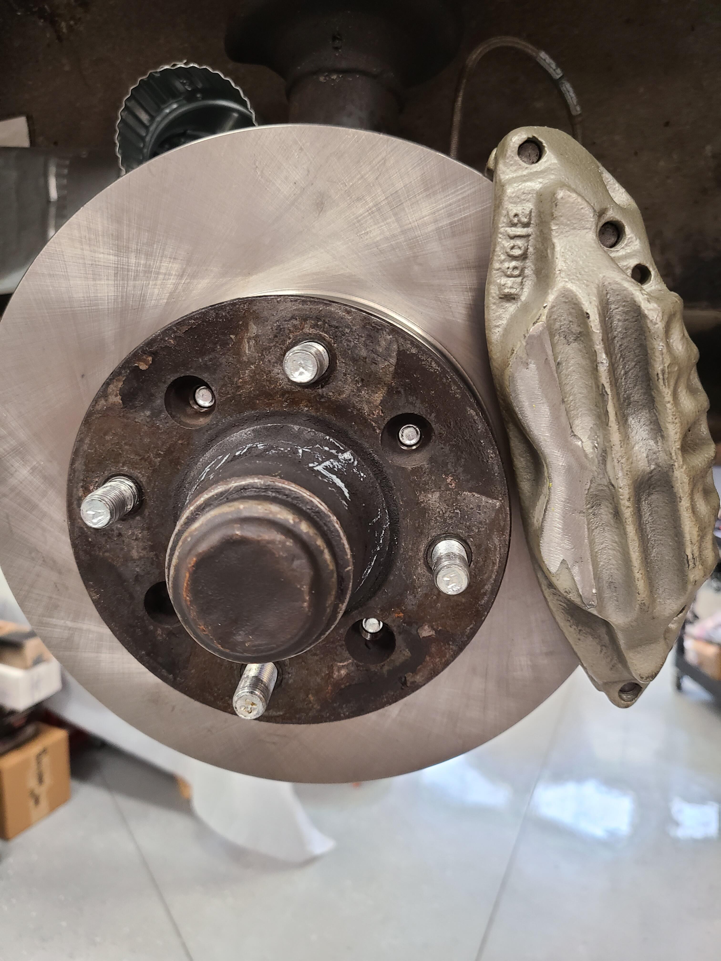

Thank you that worked I took a flap disk to it and now I got rim clearance. Now my other clearance issue is the rotor to caliper. It’s equally tight on both sides should I file the caliper down slightly to get a little wiggle room. It even rubs a tiny bit on the caliper.

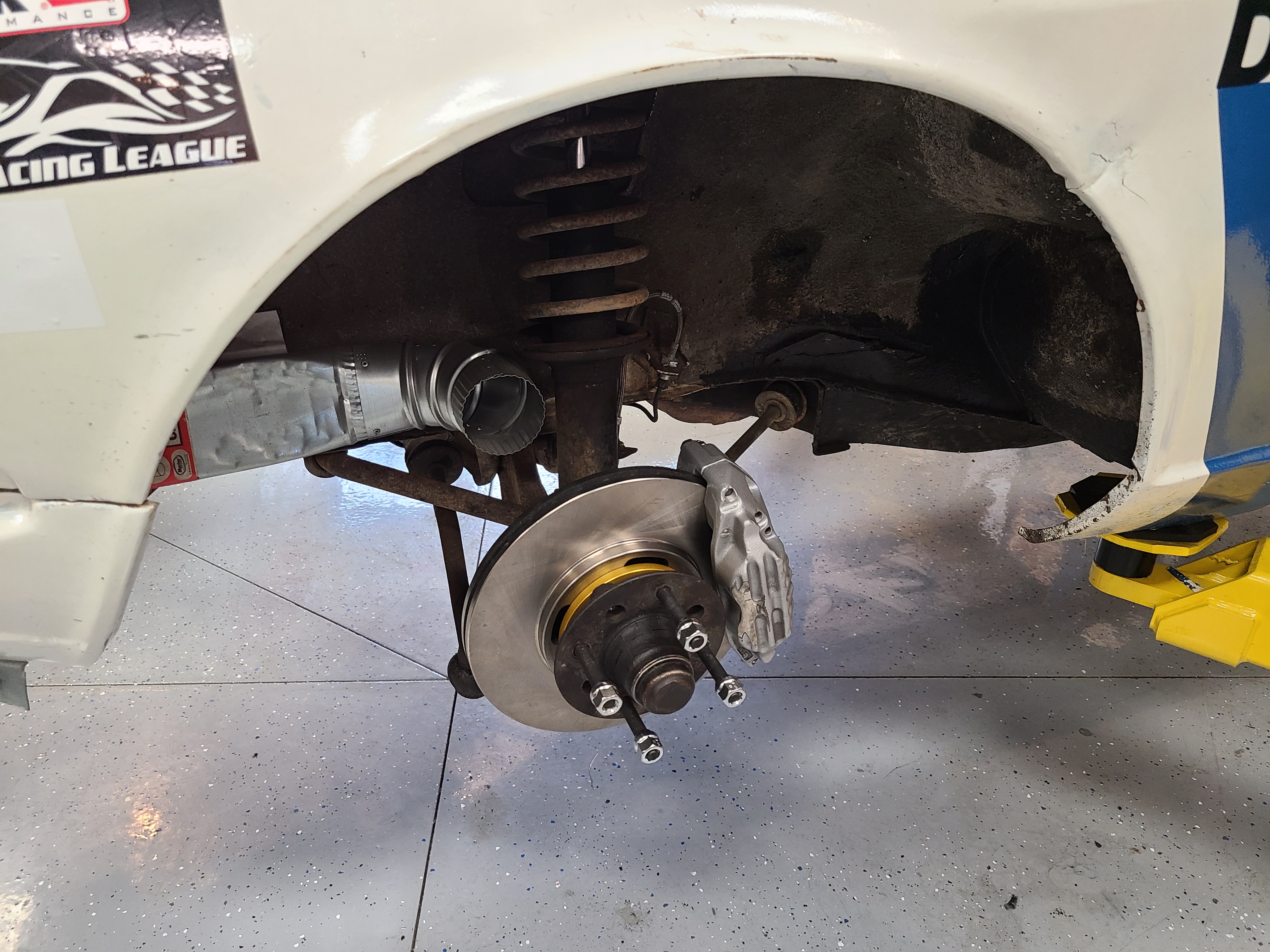

Are those calipers for solid rotors, or vented rotors?
I think there are two versions, aren’t there?
It doesn’t look like you have the brake pads in there.

Yes they are stamped s12w on them
I purchased the following from rock auto.  Are these the right rotors?
1989 Toyota 4Runner v6 calipers nugeon 9701550A (97-01550A) and 9701550B (97-01550B)
and
1984 NISSAN 300ZX 3.0L V6
DYNAMIC FRICTION 60067074(600-67074)
