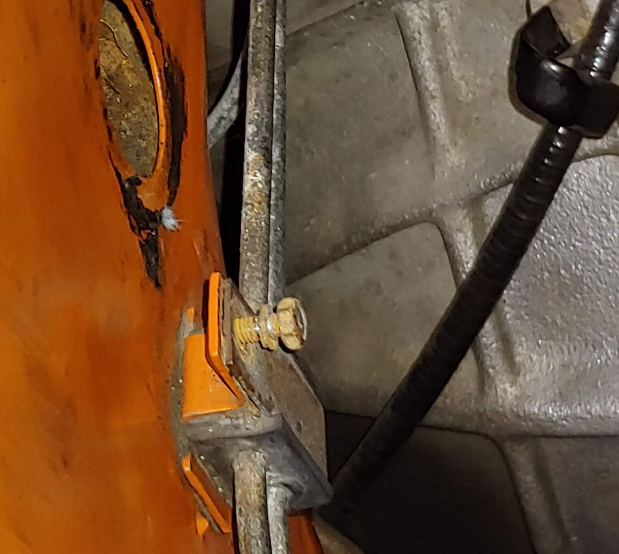

Hi Jerry,
I did a quick check on my car - the tiny bolts are a 7mm hex head with a phillips slot. Checking with Belmetric, it looks like they are called SEMS Hex Phillips altho these have a flat washer installed. They carry it in a 6mm head but not 7mm. https://www.belmetric.com/sems-hex-phillips-c-10_2345/?zenid=2tdb29vtv11hqsruk3uf0dsk12
Interesting that Nissan used a odd number mm head when everything else is even number.
Jim

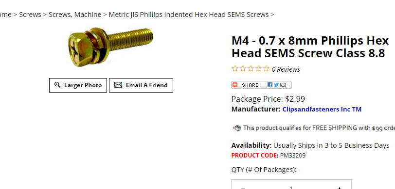

I thought all of my screws were deep in my crawl space but I found one, length is  12mm and it is an M4 x 0.7 with a 7mm hex plus JIS phillips head as @jfa.series1 mentioned. Jim I think the screws you linked to are M6, not 6mm hex head. It does seem they are like SEMs but with a lockwasher only, at least it is that way on my 7/70.
Just checked and Clips and Fasteners has them in 12mm long as well.
https://www.clipsandfasteners.com/M4-0-7-x-12mm-Phillips-Hex-Head-SEMS-Screw-p/pm33211.htm

You are correct. In my haste I misread the specs as a 6mm head but it is indeed a M6 screw dia. Thanks for catching my mistake.

You're welcome. Funny thing is when I was doing a quick search for these, that was the first link I found and almost posted it as well.
35 minutes ago, Patcon said:
Is clear zinc the correct finish?
It seems that clear zinc is correct. At least that is what is on the 70 - #00869 in my driveway. JLP
