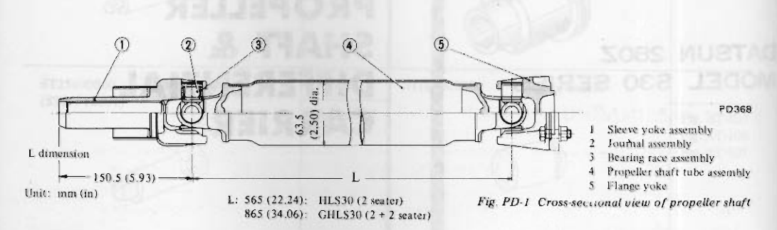

October 20, 20213 yr Author comment_630241 According to this they are the same. Everything i have seen on forums, the people say different. As far as the length, they all look about 30". https://zcardepot.com/products/transmission-driveshaft-slip-yoke-input-240z-260z-280z Ā Link to comment https://www.classiczcars.com/forums/topic/65860-280z-propeller-shafts-with-4-speed/#findComment-630241 Share on other sites More sharing options...
October 20, 20213 yr comment_630243 Link to comment https://www.classiczcars.com/forums/topic/65860-280z-propeller-shafts-with-4-speed/#findComment-630243 Share on other sites More sharing options...
