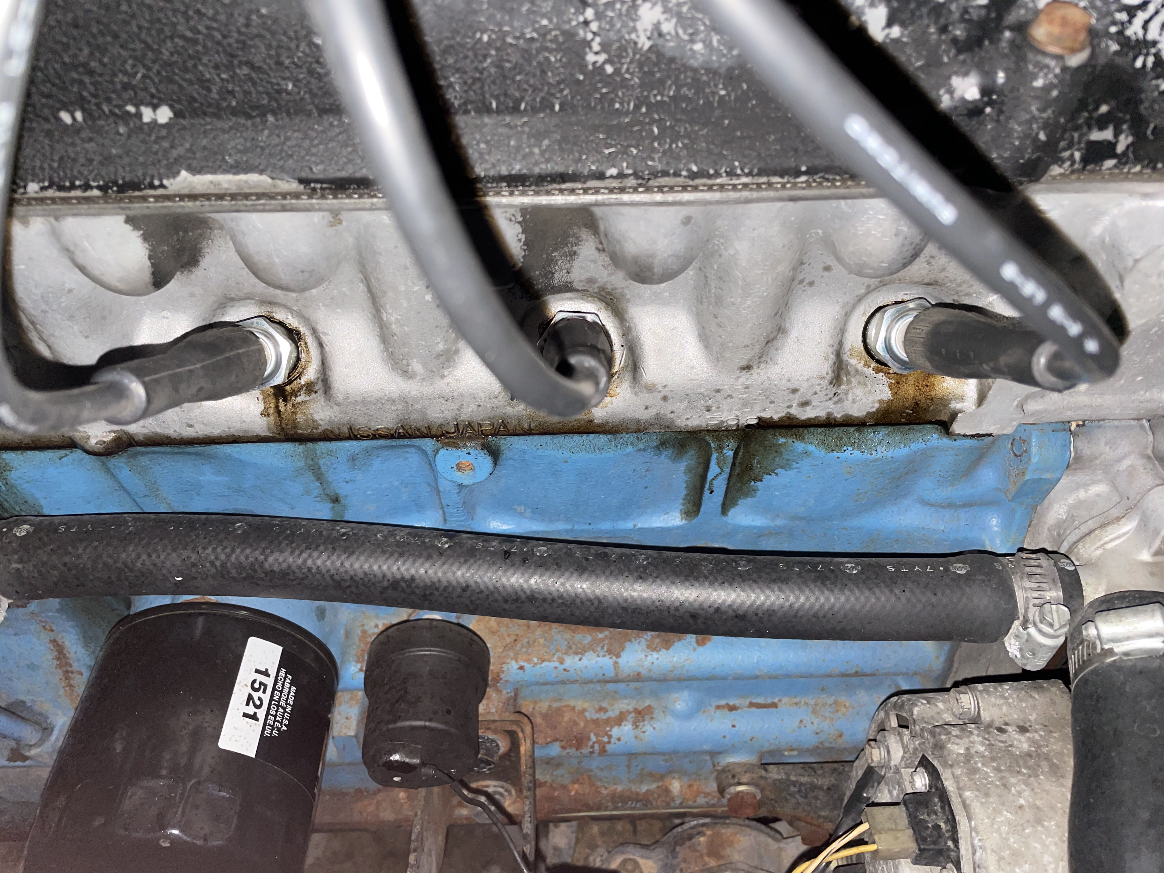

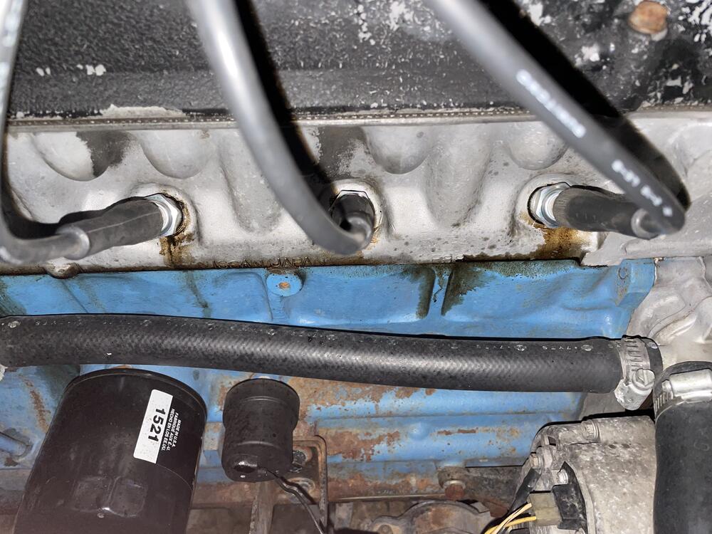

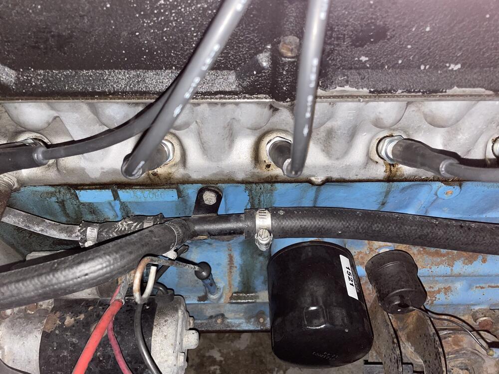

Posted September 30, 20213 yr comment_629243 Hey guys, I noticed what I assume is oil leaking from my spark plug sockets. What does that mean? Should I be concerned? I’ve attached a couple photos. As always, any help is greatly appreciated. Link to comment https://www.classiczcars.com/forums/topic/65866-leaking-from-spark-plug-sockets/ Share on other sites More sharing options...
September 30, 20213 yr comment_629246 check and confirm its not water/coolant. Take the spark plugs out - are they coroded? what do the tips look like? (post a pic) have you had the valve cover off? it could be oil thats run down from the top. try cleaning it all up running again to see if more emerges. Link to comment https://www.classiczcars.com/forums/topic/65866-leaking-from-spark-plug-sockets/#findComment-629246 Share on other sites More sharing options...
September 30, 20213 yr comment_629247 If the spark plugs were not torqued to spec, that could give you that result. If the same plugs have been taken out and put back many times, the sealing washers could be compromised. However, there could be some contributing factors, like failing oil rings. In addition to what @jonbillsuggested, do a compression test per the directions in the factory service manual. Link to comment https://www.classiczcars.com/forums/topic/65866-leaking-from-spark-plug-sockets/#findComment-629247 Share on other sites More sharing options...
September 30, 20213 yr comment_629250 Like Steve said, are the plugs properly torqued? Also, it looks like the head gasket is leaking. Have you checked the head bolts to be sure they are properly torqued? Link to comment https://www.classiczcars.com/forums/topic/65866-leaking-from-spark-plug-sockets/#findComment-629250 Share on other sites More sharing options...
