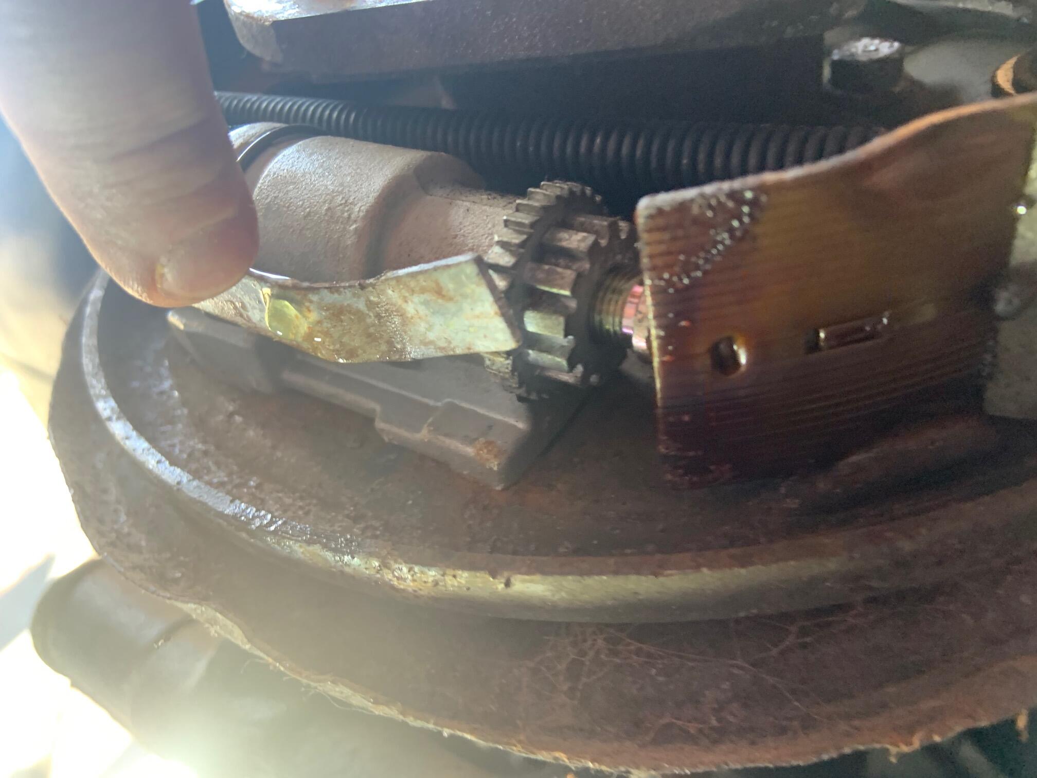

October 18, 20213 yr comment_630151 can i tag onto this thread... was bleeding all my front and back and read right looks bad. You can see in image about where fluid is coming out. i assume just replace the wheel cylinder. Is it that difficult to do? Link to comment https://www.classiczcars.com/forums/topic/65897-bleeding-rear-brakes/?&page=3#findComment-630151 Share on other sites More sharing options...
October 18, 20213 yr comment_630153 Easy to do but recommended you change both sides. Pressure differential sometimes will blow the other side. Check your shoes to see if they are wet. Link to comment https://www.classiczcars.com/forums/topic/65897-bleeding-rear-brakes/?&page=3#findComment-630153 Share on other sites More sharing options...
October 18, 20213 yr comment_630167 It's not too difficult. A screw or two on the backside, some brake line fittings. If you're handy I think it might be possible to do without removing the shoes. Shoe installation is more difficult, with all of the springs and clips. Edited October 18, 20213 yr by Zed Head Link to comment https://www.classiczcars.com/forums/topic/65897-bleeding-rear-brakes/?&page=3#findComment-630167 Share on other sites More sharing options...
October 18, 20213 yr Author comment_630174 YARB is right. Change them both. For a start if you haven't done the the job before, the first one will take too much time. After that, the second one will take half the time. Also, if one cylinder has failed, there is no reason to expect its twin has much, if any life left. Link to comment https://www.classiczcars.com/forums/topic/65897-bleeding-rear-brakes/?&page=3#findComment-630174 Share on other sites More sharing options...
October 20, 20213 yr comment_630246 Don't know which wheel cylinders you have? If you have the early wheel cylinders ($290.00) you can replace them with the later model ($50.00) with a little rebending of the hard line on the back plate. Early / Late Wheel Cylinders? - Wheels & Brakes - The Classic Zcar Club (classiczcars.com) Motorsport! Drums & Wheel Cylinders - The Z Store, Nissan-Datsun 240Z-260Z-280Z-280ZX-300ZX(Z31/Z32)-350Z-370Z Parts Link to comment https://www.classiczcars.com/forums/topic/65897-bleeding-rear-brakes/?&page=3#findComment-630246 Share on other sites More sharing options...
October 21, 20213 yr comment_630272 not sure. i did see the $59ish dollar ones. It says on listing they will "fit" so i will likely buy a set of them. The oem's are $320 which is ridiculous Link to comment https://www.classiczcars.com/forums/topic/65897-bleeding-rear-brakes/?&page=3#findComment-630272 Share on other sites More sharing options...
October 21, 20213 yr comment_630299 I found switching the short hardlines from passenger's side to driver's side & vise versa lessened the bending required. When you get into it give that a look. May be helpful? Was for my car. Link to comment https://www.classiczcars.com/forums/topic/65897-bleeding-rear-brakes/?&page=3#findComment-630299 Share on other sites More sharing options...
