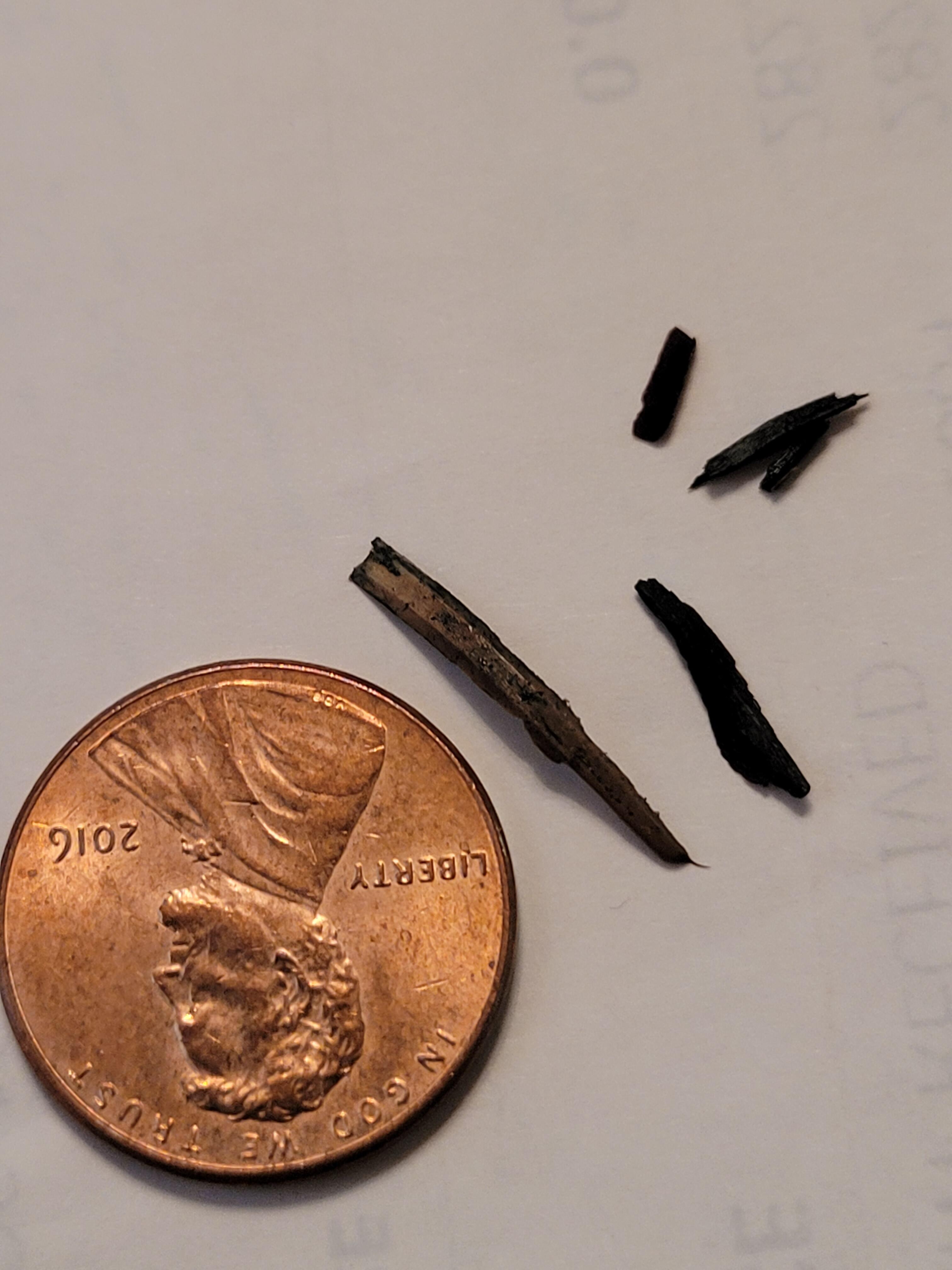

Found these in the oil strainer. Magnified one and its the shape of an isosceles trapezoid. Size of a tooth pick tip. Magnetic. Its not shrapnel because it has a formed shape.

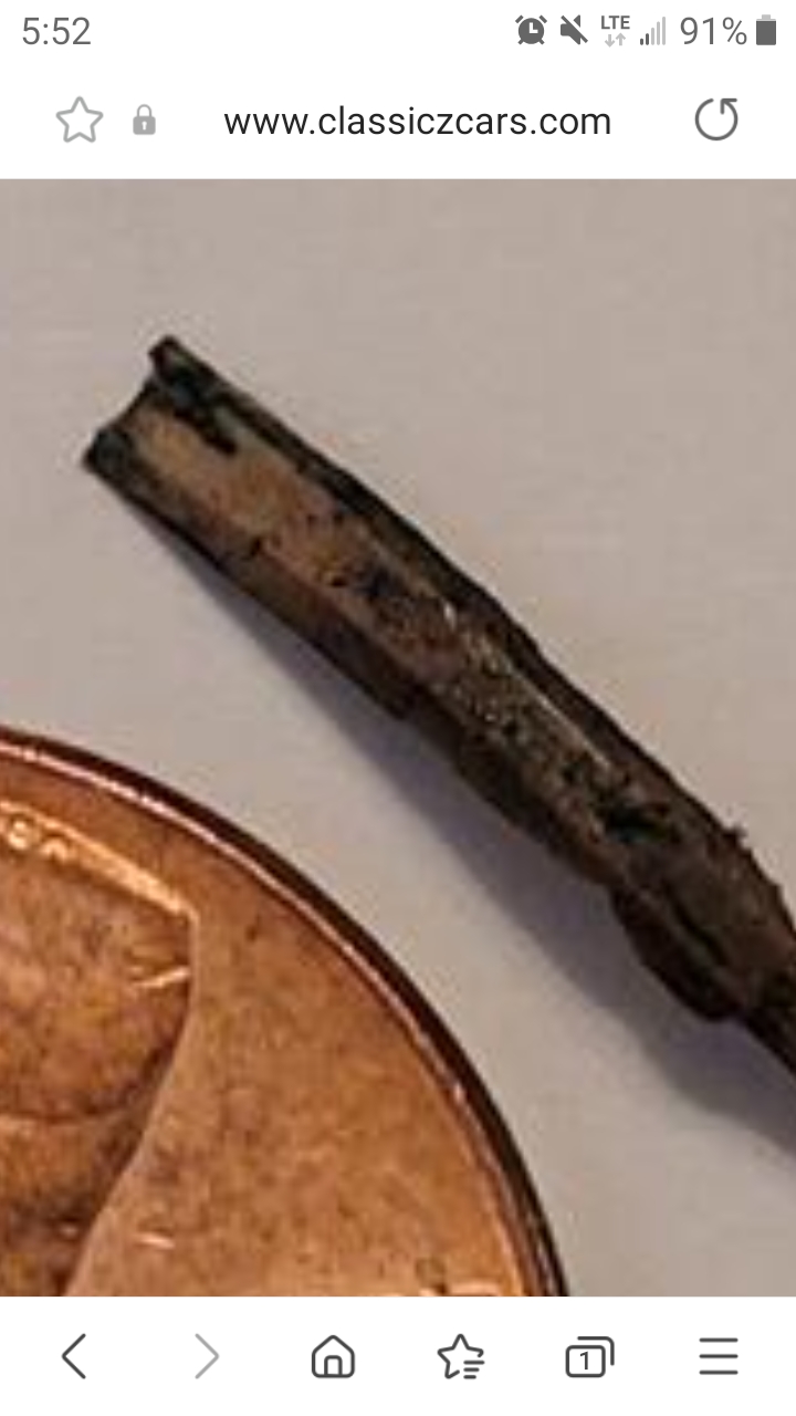

I can see that too. The beveled edges in this screen grab is what makes me think that.

The rings aren't beveled on both sides. I forgot about that. Sorry.

I don't see how piston ring parts get out of the ring groove and down the length of the piston skirt to the crankcase without major piston damage.
I'm voting that it's cast iron flashing from inside the block.
I just de-flashed mine because I was able to break off a piece with light finger force.  Broke out the die grinder and had at all of it.  While I was at it, I smoothed up some cast holes for better coolant flow.

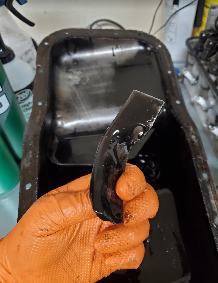

I had first-hand experience of chain tensioner parts finding their way to the oil pan. Found this in my L20b when I took it apart to rebuild a couple years ago. Not certain if that's what you are looking at, but yours look much smaller and hopefully didn't do as much damage on their journey between the front cover and oil pan if so.
