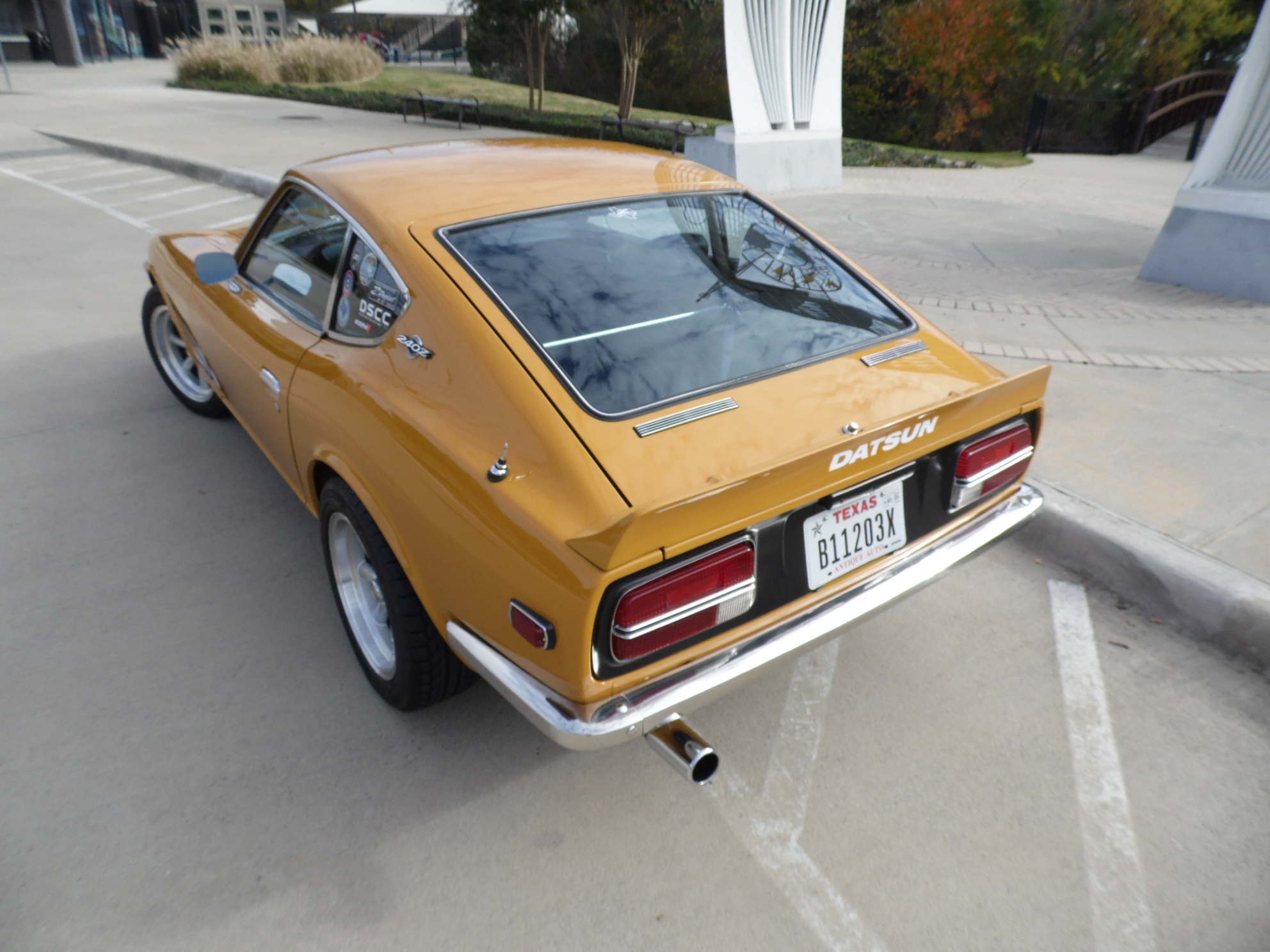

I have this one from Vietnam on the rear, SS and a pefect fit. They have choices of with or without rubber.

Got mine from Bumper Automobile as well. Had to adjust the tabs on front and rear to get it to sit how I wanted, but otherwise no issues with fitment.

The center piece was a perfect fit to the OE bumper mounts, also a perfect match to the curve of the rear valance. That was a significant problem I previously had with the Taiwan-sourced bumpers sold by MSA and Futofab (I tried both) - the arc of the center piece was too shallow to fit the valance.  On the Vietnam unit, the welded-on mounting tabs on the end pieces required a bit of adjusting to line up with the bolts that go thru the fenders and tuck in to the fender grooves. Luckily no scratches or other issues but then my car is more garage queen than driver. 😉
