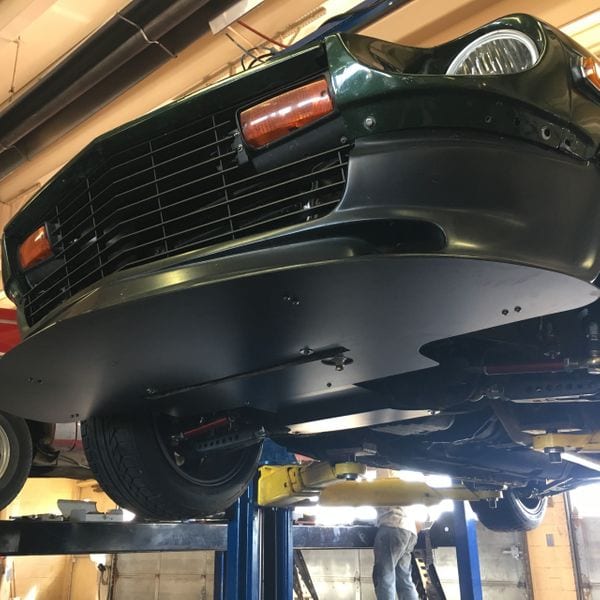

Cliff, I didn’t know that was possible, I’d love to see some pics .  I know you can put on the Skillard lower splitter and it apparently really stiffens up the Xenon Valance, see first pic.

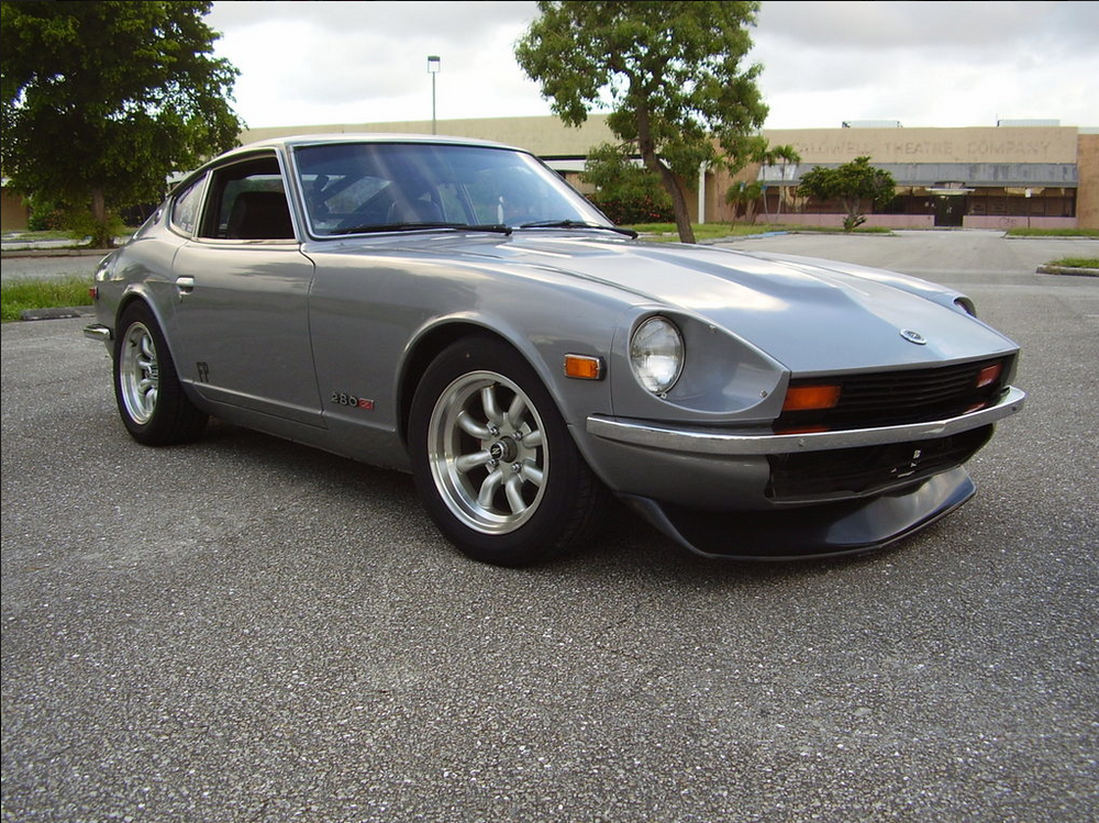

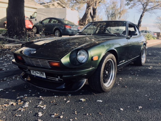

The problem with the BRE lower lip is it hangs very low and is too big,  anyone know of a smaller lower lip?  See other two pics.  I’d rip this off the first drive.
