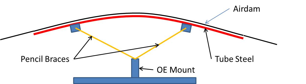

November 2, 20213 yr comment_630851 I have a Xenon airdam, but I have not yet installed it, so this might or might not be 100% feasible. I might change course, but here is what I plan to do. Knowing that the Xenon airdam is known to flex down at speed and also knowing that the whole point of the flexible airdam is to not get destroyed all the time, I plan to make a sacrificial brace. I hope to bend some small tube steel to fit into the back side of the lower front lip and weld two tabs onto it where two pencil braces will go back to the stock center valence mount. The pencil braces will be thin with a V-shaped cross section. If the airdam strikes a curb, it will flex and cause the sacrificial pencil brace(s) to buckle. A simple removal and straightening or replacement of the damaged brace will be easy. The braces will be just strong enough to keep the airdam in place at all vehicle speeds. It won't take much strength. Alternately, the pencil braces could be stiff with a spring in the center which will allow buckling with an automatic spring-back feature. The spring design might take some trial and error to get right. Here is a sketch (not to scale or proper shape) of what I plam to make. Edited November 2, 20213 yr by Jeff G 78 Link to comment https://www.classiczcars.com/forums/topic/65957-280z-bumper-conversion-who-kept-280z-lower-valence/?&page=4#findComment-630851 Share on other sites More sharing options...

November 2, 20213 yr comment_630858 On 11/2/2021 at 5:27 AM, Jeff G 78 said: I have a Xenon airdam, but I have not yet installed it, so this might or might not be 100% feasible. I might change course, but here is what I plan to do. Knowing that the Xenon airdam is known to flex down at speed and also knowing that the whole point of the flexible airdam is to not get destroyed all the time, I plan to make a sacrificial brace. I hope to bend some small tube steel to fit into the back side of the lower front lip and weld two tabs onto it where two pencil braces will go back to the stock center valence mount. The pencil braces will be thin with a V-shaped cross section. If the airdam strikes a curb, it will flex and cause the sacrificial pencil brace(s) to buckle. A simple removal and straightening or replacement of the damaged brace will be easy. The braces will be just strong enough to keep the airdam in place at all vehicle speeds. It won't take much strength. Alternately, the pencil braces could be stiff with a spring in the center which will allow buckling with an automatic spring-back feature. The spring design might take some trial and error to get right. Here is a sketch (not to scale or proper shape) of what I plam to make. Jeff, I had a similar idea, but less thought out. I thought of glueing in strips of aluminum along the inside edges on the valance to stiffen it up. Your idea is probably better. The Skillard splitter seems to really tighten it all up but then you have a 2” strip sticking out the bottom. Some may not like this look. Here are some pics of that splitter and how it ties in. You can adjust how much the splitter stick out too. Link to comment https://www.classiczcars.com/forums/topic/65957-280z-bumper-conversion-who-kept-280z-lower-valence/?&page=4#findComment-630858 Share on other sites More sharing options...

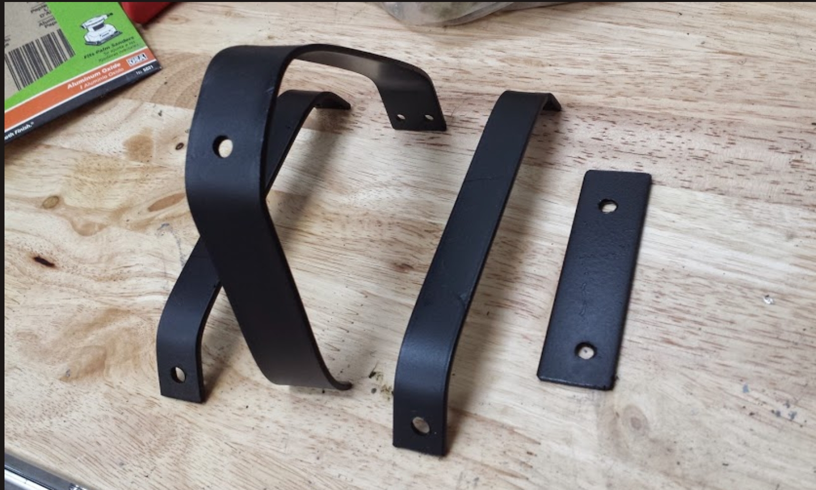

November 2, 20213 yr comment_630869 After some searching finally found his thread. It was 6 years ago..... I could remember the build thread well, because we were both going through the same drama purchasing really crappy bumper brackets and then making our own. In the photo the two identical bars go from the mounting points for the old lower two bar grill. The big bracket is in the center section. You can read all about it in his thread. Link to comment https://www.classiczcars.com/forums/topic/65957-280z-bumper-conversion-who-kept-280z-lower-valence/?&page=4#findComment-630869 Share on other sites More sharing options...
