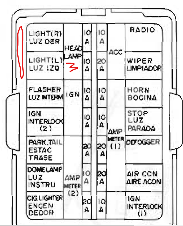

Well, if the relay setup has one fuse, have you tried changing that fuse?

Don't forget the obvious.  There's a left and a right.  They might be bypassed in your setup or they might not be.
