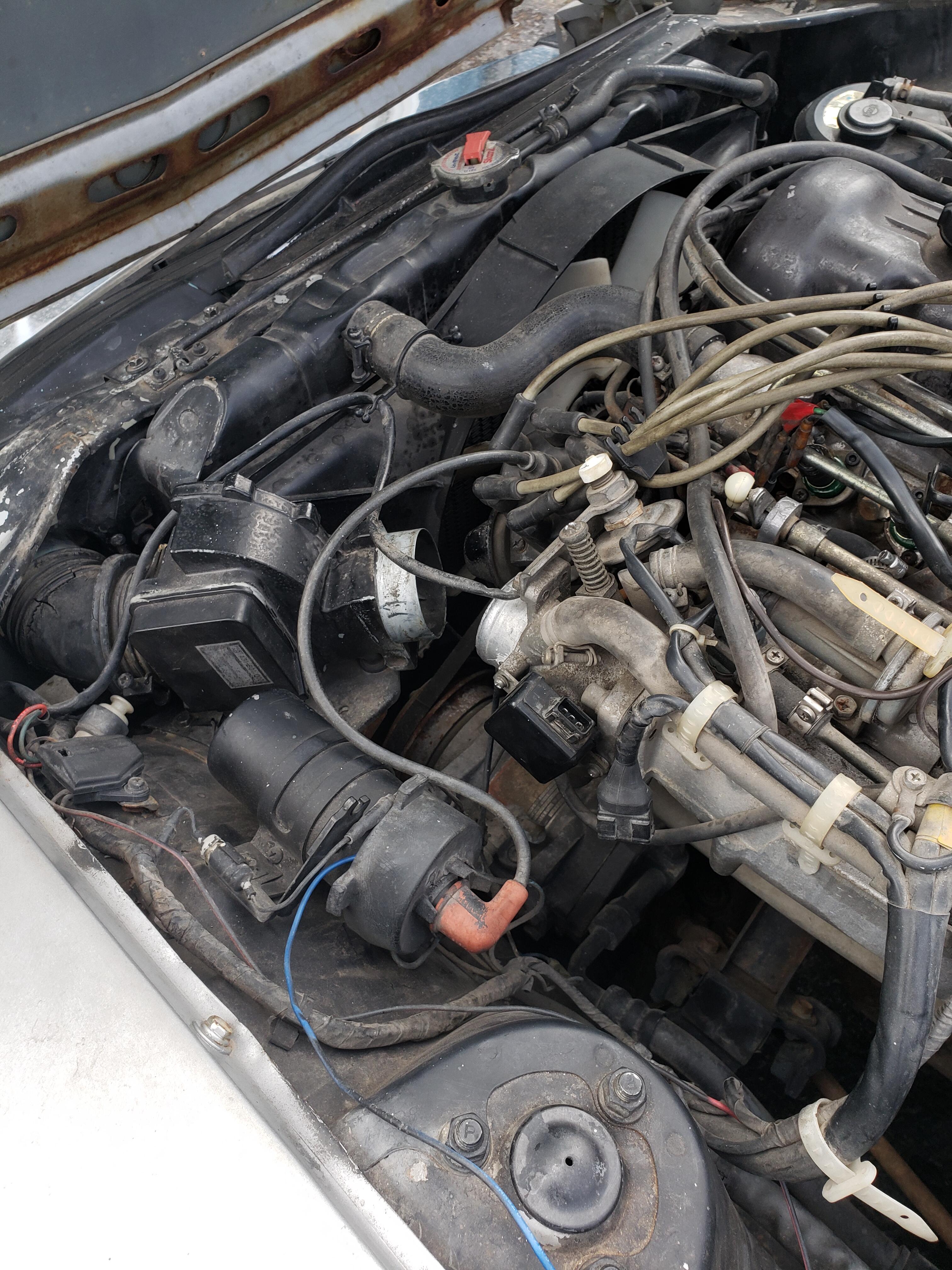

Hey people, I'm new to this page. I just bought a 280z and I ive been working on it. I had it running for the past 3 days. I noticed it had a Air leak after the air flow meter so I drove to the parts store got some hose, then drove back installed it. now the car won't even start. I need help! I have tried everything I can to get it to run,20211023_141332.jpg20211023_141420.jpg it wont even start on starting fluid. Have spark in all the plugs.

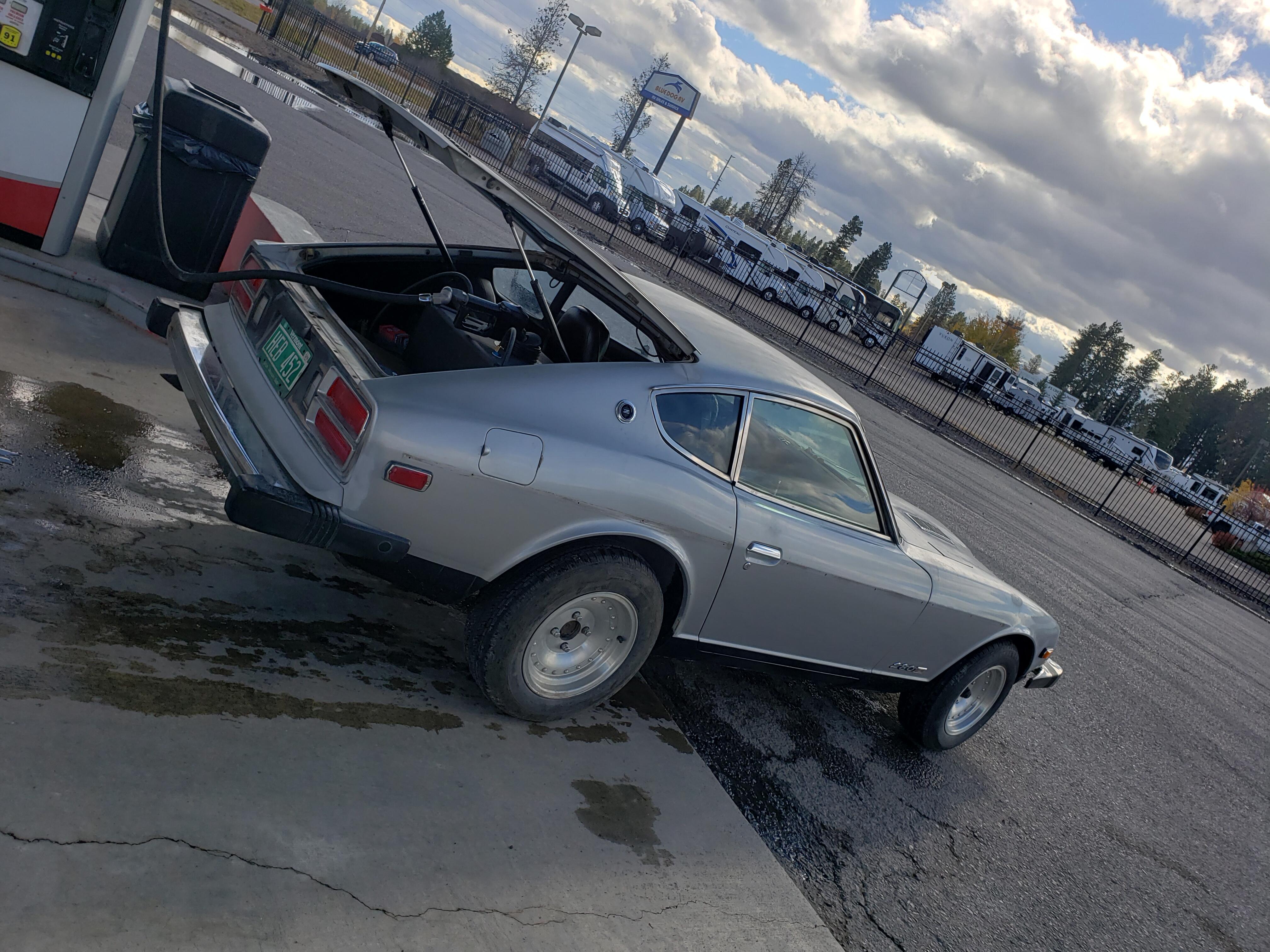

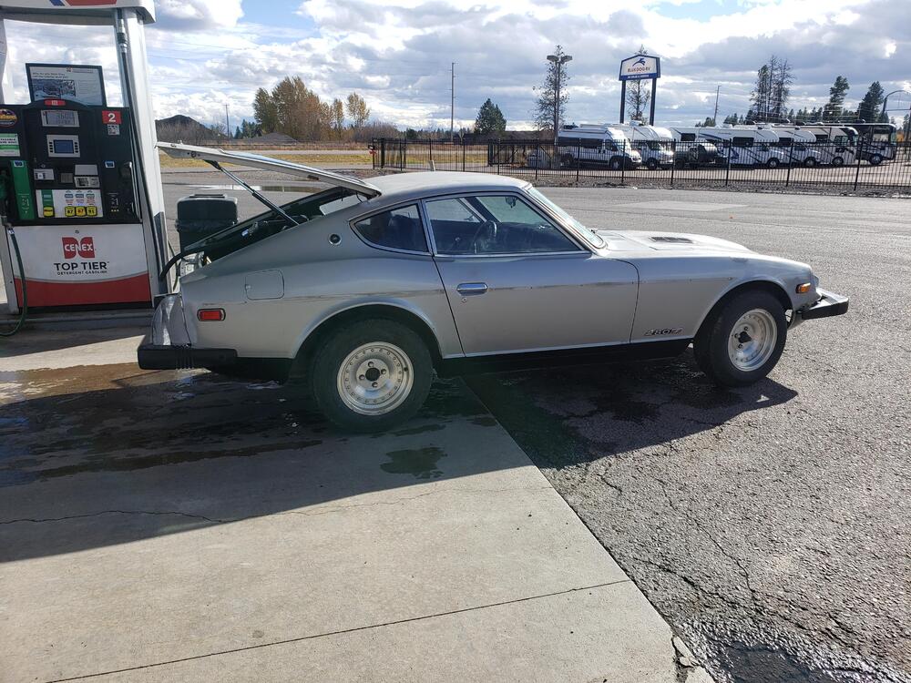

not sure what is going on with the gas station filling up. I presume its some kind of fuel cell? If that is the case are there any other modifications? if there are help will be limited to statements like "have you got spark" etc...

If it ran before it seems like nothing major would have happened just from disconnecting and reconnecting the AFM hose.  I don't know that I would start messing with things that you haven't touched.  Focus on the area you were working in.
Looks like you disconnected the throttle valve sensor for some reason.  What else did you disconnect?  One strong possibility is that you disconnected the water temperature sensor and are flooding it.  That would be one reason starting fluid doesn't work.
I agree with Dave, that internal fuel tank looks scary.  Reminds me of what I saw in a wrecking yard once.  A full size fuel tank strapped inside the car, a Z, with hoses running through holes up to the engine.  A firebomb waiting to happen.

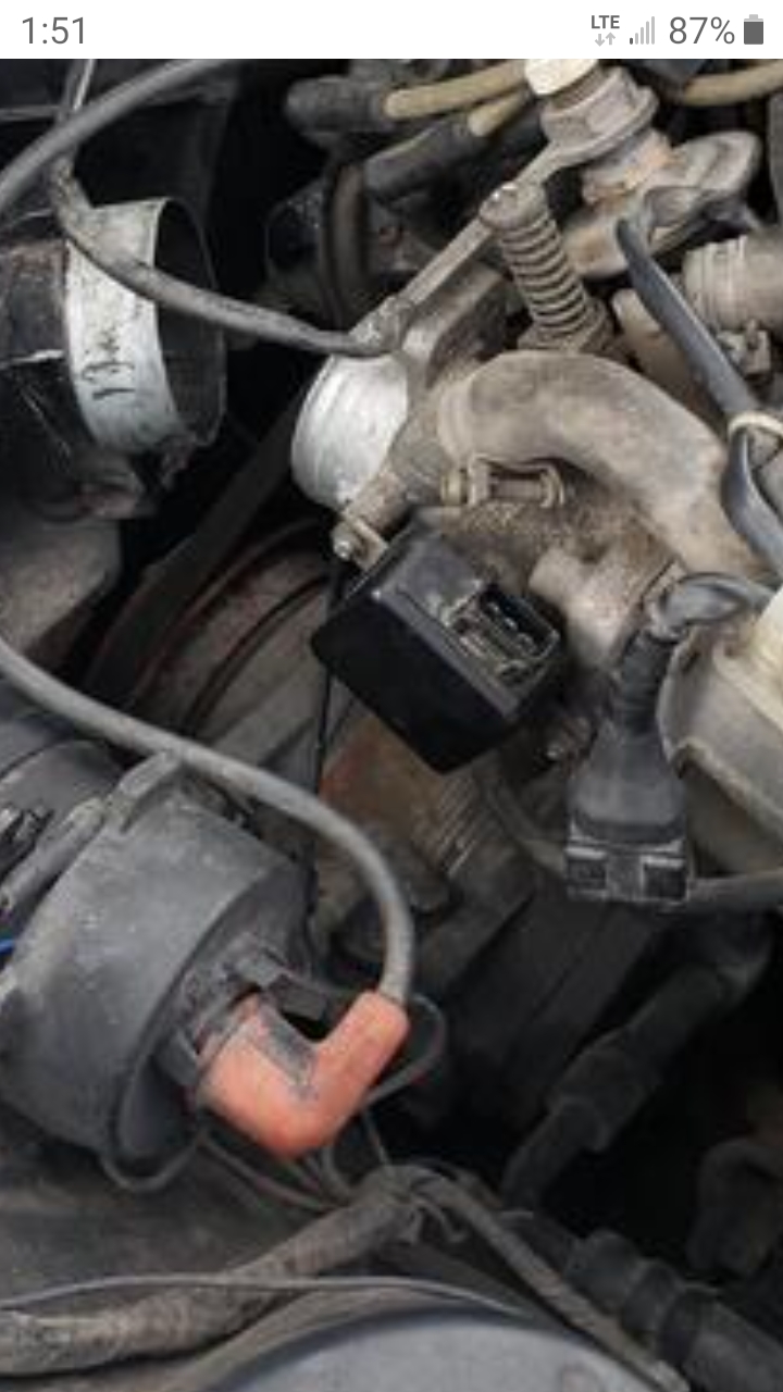

You need that accordion hose from the AFM to the throttle plate. Is that where you're squirting start fluid?
Also the TPS needs to be plugged in like Zed Head mentioned.
Both are in this picture.

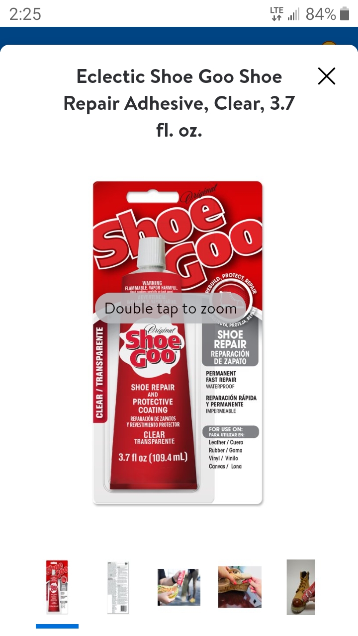

I've seen flexible aluminum hose used before. Can't remember if it was cloths dryer exhaust hose or water heater vent pipe, sorry. If the original rubber one isn't too bad you could seal it with silicone. We used Shoe Goo back in the 80s bought at sporting goods stores for fixing tennis shoes. Walmart has it online, not sure about in store.
