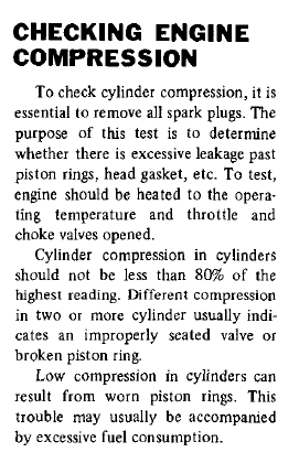

October 26, 20213 yr comment_630518 Why not go with what Nissan recommended to do for compression testing? (In this case, you can find it on page ET-5 of the 76 FSM) Link to comment https://www.classiczcars.com/forums/topic/65970-checking-psi-of-cylinders/#findComment-630518 Share on other sites More sharing options...
October 26, 20213 yr comment_630522 Yes, it's not so much "I must have X# PSI", it's the difference between the high and low cylinders. 125 PSI is 86% of 145 PSI. You're good according to the manual, although since the alternative is rather extensive work, I wouldn't mind if pressure was less than 80% of the high cylinder. I usually do a wet & dry test to have some idea whether any lower pressures are due to rings, or to valves. Edited October 26, 20213 yr by Pilgrim Link to comment https://www.classiczcars.com/forums/topic/65970-checking-psi-of-cylinders/#findComment-630522 Share on other sites More sharing options...
