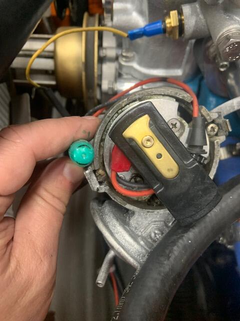

October 29, 20213 yr comment_630660 1 minute ago, Wally said: working way thru list stuff here. rotor is quite bit off...should be pointing where green top is. I did remove oil pump and distributor.... does this mean i put it back in wrong? Well, if you have #1 at TDC on the compression stroke, yes, you put the oil pump and distributor back in wrong. Link to comment https://www.classiczcars.com/forums/topic/65981-car-will-not-start/?&page=2#findComment-630660 Share on other sites More sharing options...
October 29, 20213 yr comment_630661 It looks off, and probably one crankshaft revolution. It has to sync with the oil pump so there is some trial and error involved. You can verify the compression stroke on #1 by taking off the valve cover and checking that the cam lobes are not opening the valves on #1. Get the engine on the #1 compression stroke and rotate the engine, by hand with the plugs out until the timing mark on the damper is between 0 and 10 degrees on the timing tab then set the distributor back in place with the rotor pointing at the # 1 plug wire. Link to comment https://www.classiczcars.com/forums/topic/65981-car-will-not-start/?&page=2#findComment-630661 Share on other sites More sharing options...

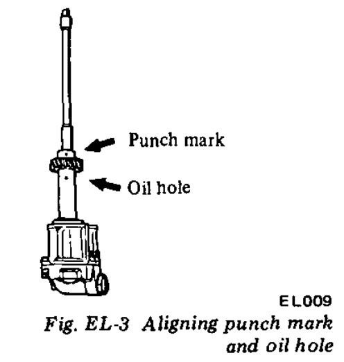

October 29, 20213 yr comment_630662 From the EL section of the FSM: Not having done that before, I would say you're looking for a mark like on the shaft in the view on the left. Or this: Link to comment https://www.classiczcars.com/forums/topic/65981-car-will-not-start/?&page=2#findComment-630662 Share on other sites More sharing options...

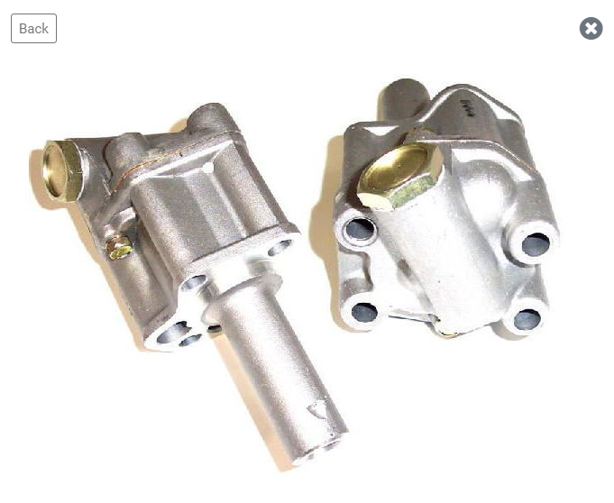

October 29, 20213 yr comment_630664 Here's an image that @Zed Headposted in a thread a few years ago: And here's one of how the oil pump shaft should look from the top before you install the distributor (courtesy of @siteunseen) Link to comment https://www.classiczcars.com/forums/topic/65981-car-will-not-start/?&page=2#findComment-630664 Share on other sites More sharing options...

October 30, 20213 yr Author comment_630691 18 hours ago, SteveJ said: Here's an image that @Zed Headposted in a thread a few years ago: And here's one of how the oil pump shaft should look from the top before you install the distributor (courtesy of @siteunseen) just checked. you are right. this tang isnt aligned like image here. Link to comment https://www.classiczcars.com/forums/topic/65981-car-will-not-start/?&page=2#findComment-630691 Share on other sites More sharing options...

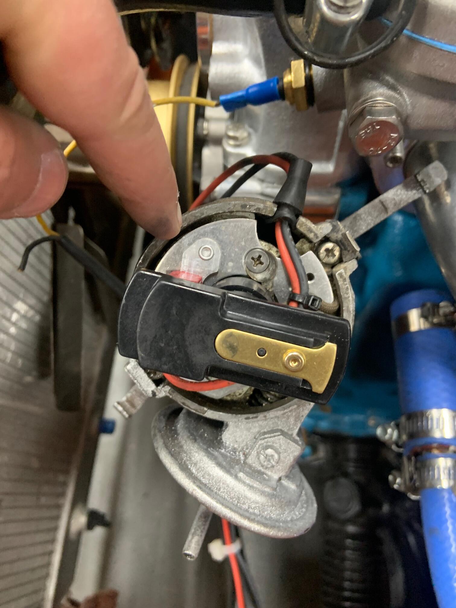

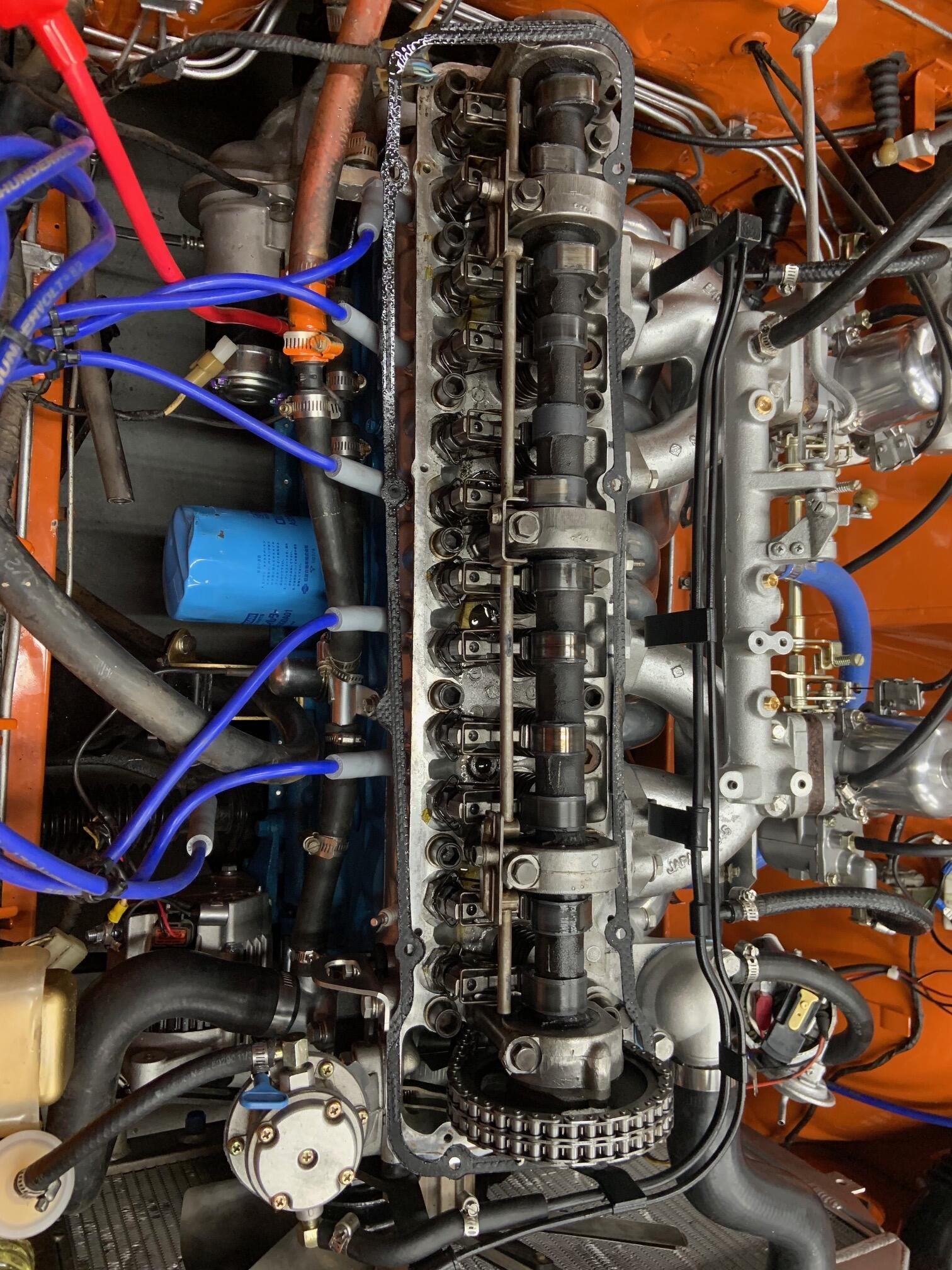

October 30, 20213 yr Author comment_630697 I put rubber plug into #1 spark plug and had wife turn key. Holy crap heck....that thing shot out like a cannon. It missed me thankfully. So i guess that means #1 is TDC now? or compression stroke? not even sure if they are the same thing? After that i took off the valve cover. Lobe 1 appears straight down. Not sure what all this means or what to do from here but its an update on where i am. Also i took image of where rotor is now. My finger is area where #1 plug would be with cap on Edited October 30, 20213 yr by Wally Link to comment https://www.classiczcars.com/forums/topic/65981-car-will-not-start/?&page=2#findComment-630697 Share on other sites More sharing options...
