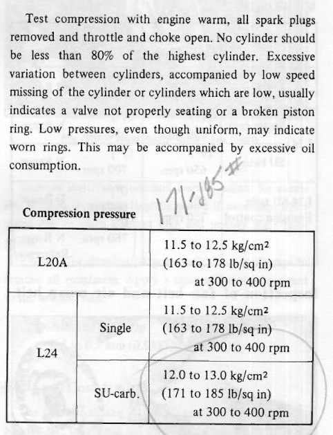

November 11, 20213 yr comment_631402 From the FSM on compression testing. Of course, you'll have to do it cold right now, but follow the rest. Note that the compression ratio will probably be lower with the engine cold, but there should not be a lot of variation in readings. Link to comment https://www.classiczcars.com/forums/topic/65981-car-will-not-start/?&page=7#findComment-631402 Share on other sites More sharing options...

November 11, 20213 yr Author comment_631404 2 minutes ago, SteveJ said: From the FSM on compression testing. Of course, you'll have to do it cold right now, but follow the rest. Note that the compression ratio will probably be lower with the engine cold, but there should not be a lot of variation in readings. thanks for that SteveJ. if i redo the compression test with all the plugs out at same time do you think i will get different results? Link to comment https://www.classiczcars.com/forums/topic/65981-car-will-not-start/?&page=7#findComment-631404 Share on other sites More sharing options...
November 11, 20213 yr comment_631405 It is possible your readings will go up since the other cylinders won't be pushing as hard against the cylinder under test. Link to comment https://www.classiczcars.com/forums/topic/65981-car-will-not-start/?&page=7#findComment-631405 Share on other sites More sharing options...

November 11, 20213 yr comment_631414 Along with pulling all the plugs, I open the throttle all the way during the test. Link to comment https://www.classiczcars.com/forums/topic/65981-car-will-not-start/?&page=7#findComment-631414 Share on other sites More sharing options...
