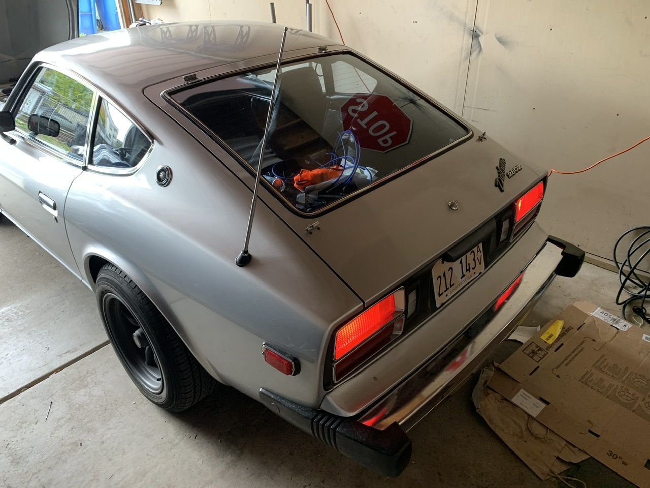

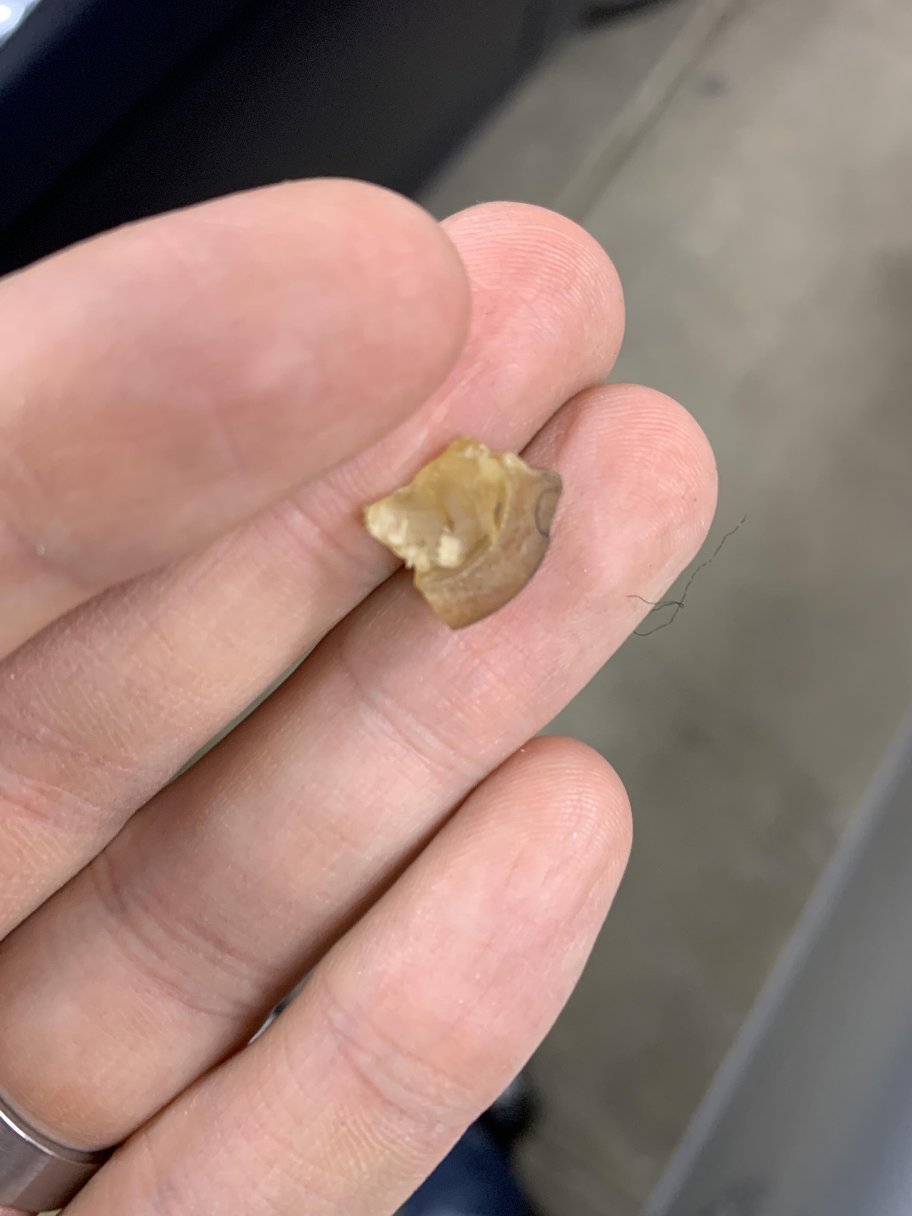

Posted October 31, 20213 yr comment_630759 Hi Guys, 1977 280z. Just got back from a drive and I can’t get the rear tail lights to turn off even when the car is off and the key is out. The headlights and side markers turn on and off as expected, just the tail lights are having an issue. Not sure what fuse this is linked to, but I tried pulling a few to see if I can turn it off to no avail. 1. Any idea what fuse tail lights are linked to so I can at least get them off so they are not running down the battery? 2. Any advice on where to start with troubleshooting? Edited October 31, 20213 yr by Muzez Link to comment https://www.classiczcars.com/forums/topic/65992-resolved-tail-lights-stuck-on/ Share on other sites More sharing options...

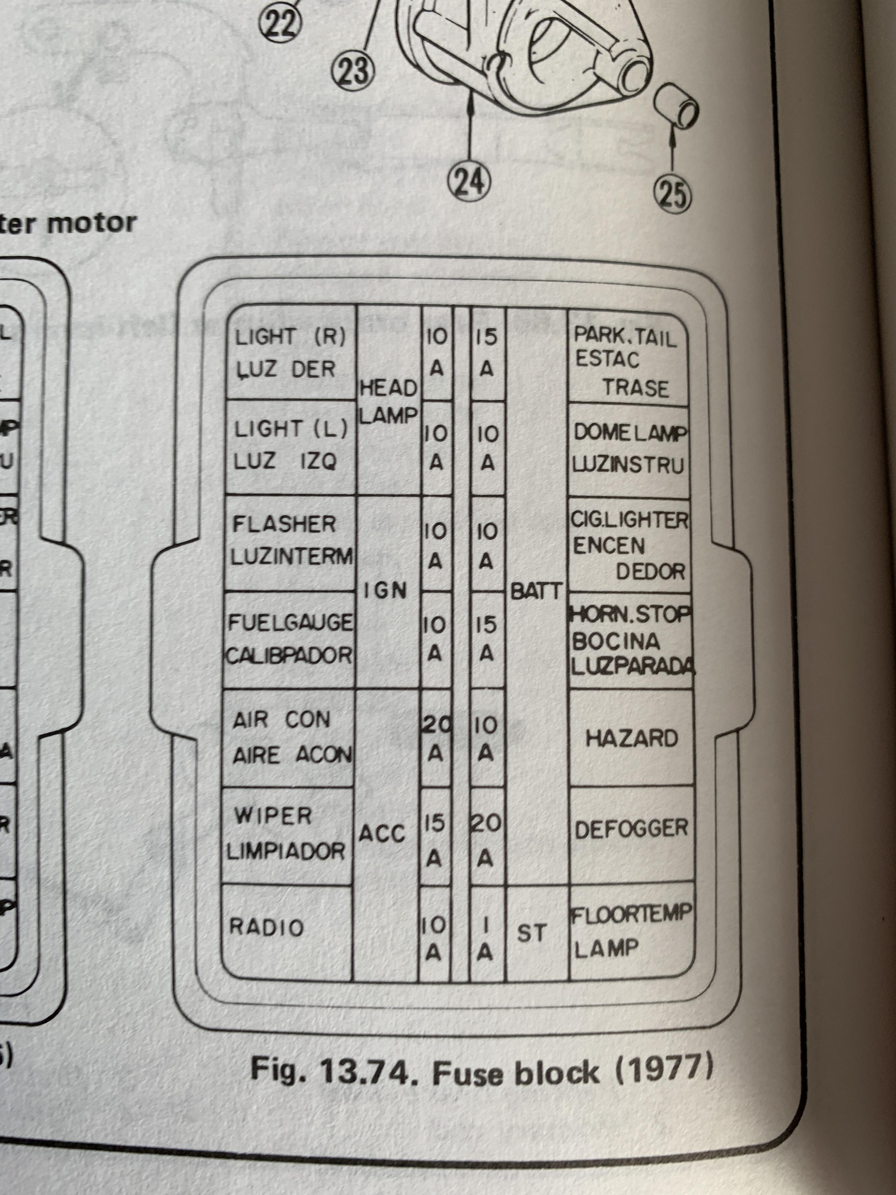

October 31, 20213 yr Author comment_630761 I have tried the light (r), light (l), hazard, and park, tail estac fuses, but no luck getting it to turn off Link to comment https://www.classiczcars.com/forums/topic/65992-resolved-tail-lights-stuck-on/#findComment-630761 Share on other sites More sharing options...

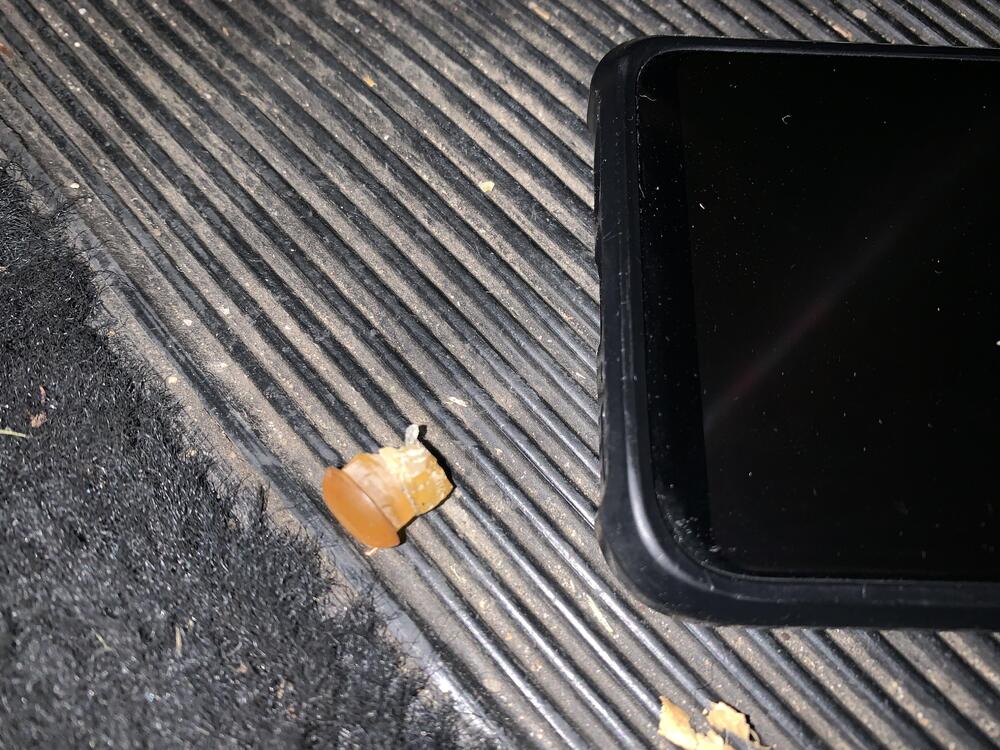

October 31, 20213 yr Author comment_630764 @Patcon good call, it was the little rubber stopper on the brake pedal that engages with theswitch. It disintegrated. Put a shim in it until I can get a new one. Not sure what they are called though lol. Link to comment https://www.classiczcars.com/forums/topic/65992-resolved-tail-lights-stuck-on/#findComment-630764 Share on other sites More sharing options...

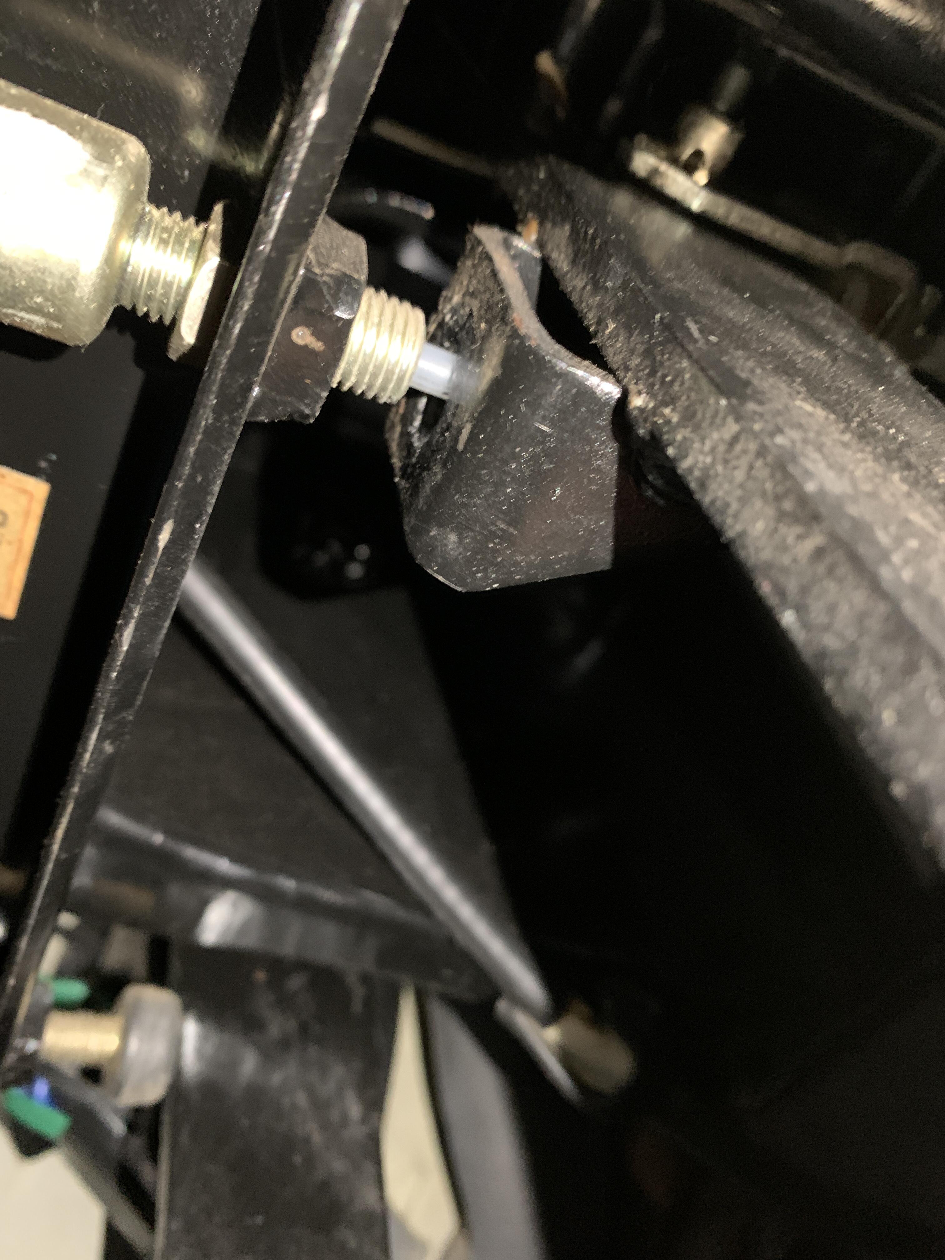

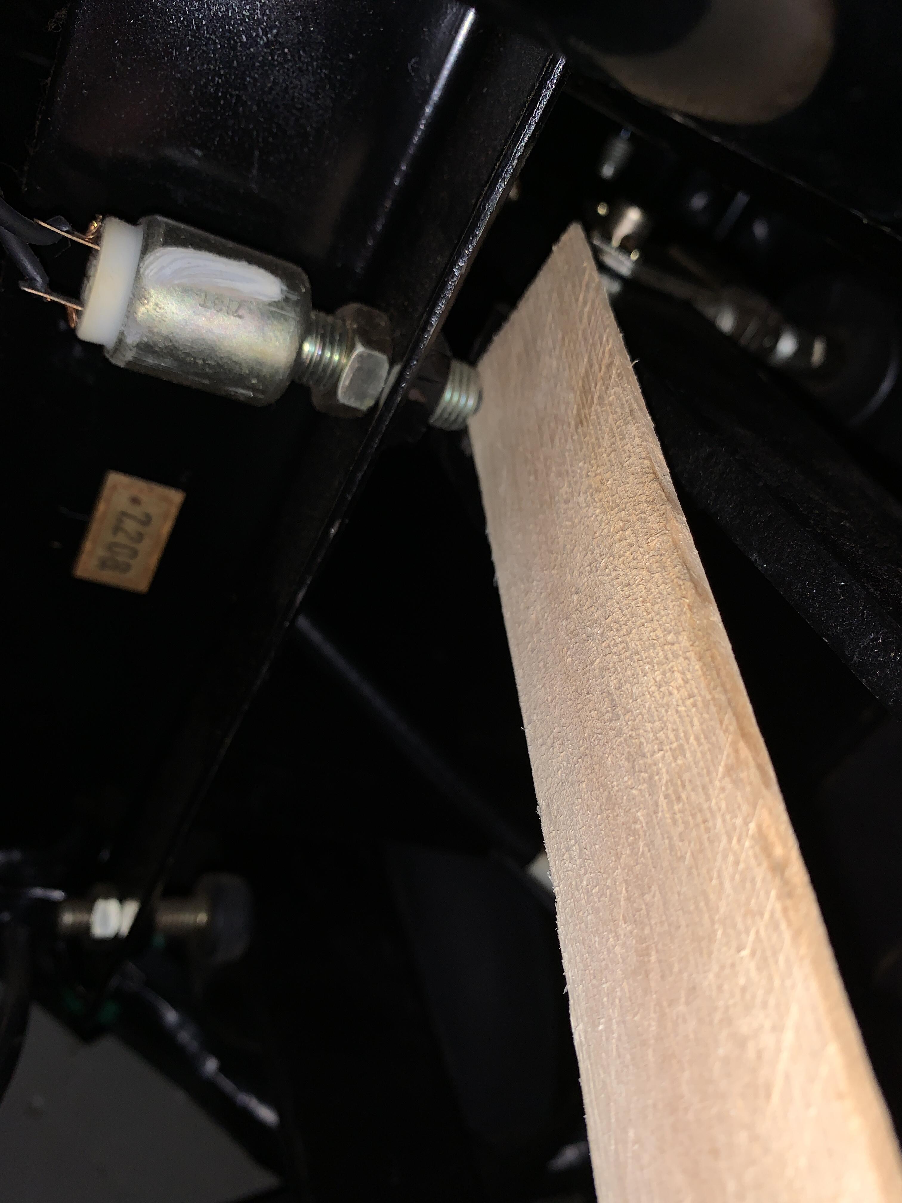

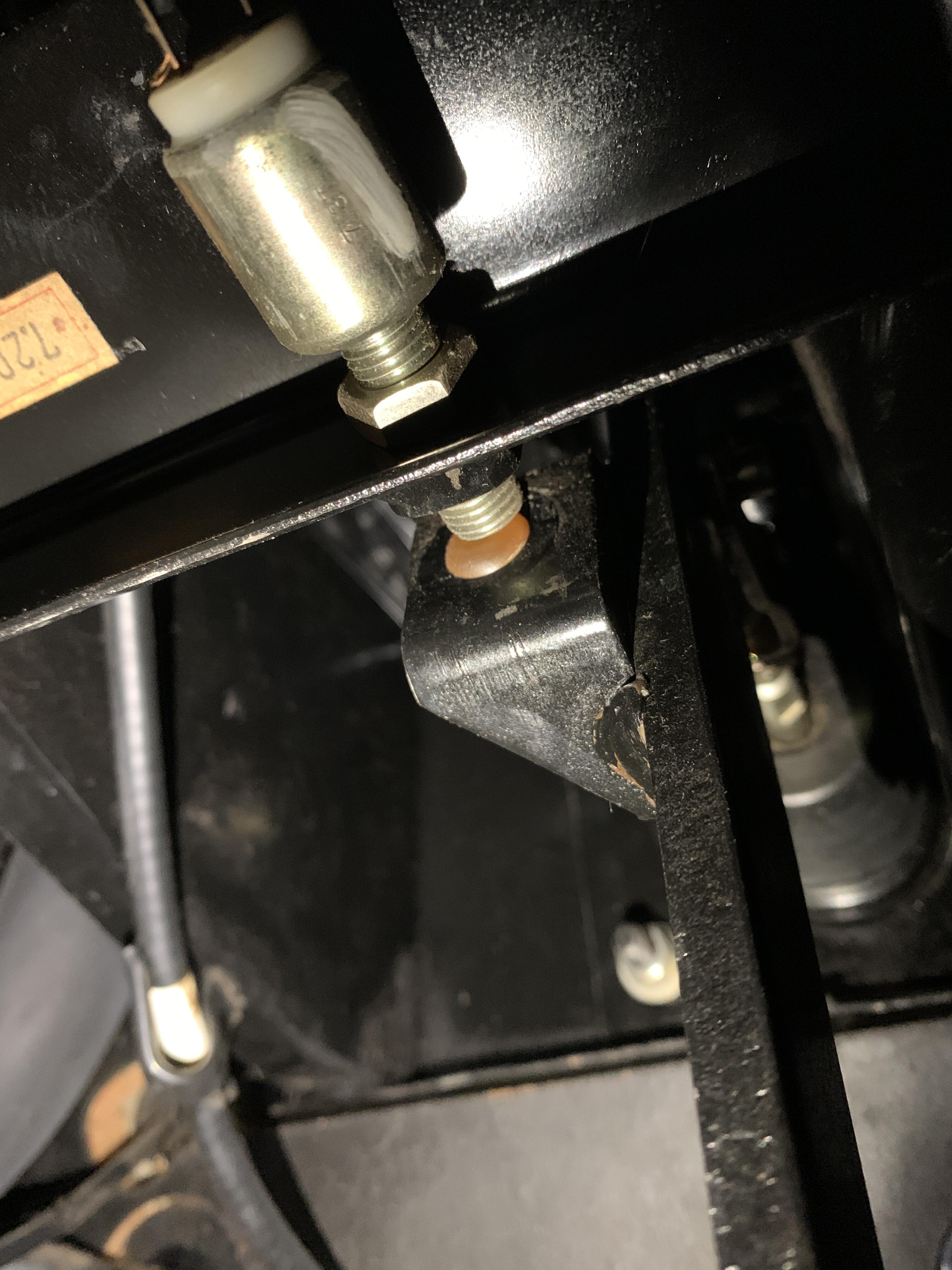

October 31, 20213 yr Author comment_630778 2 hours ago, SteveJ said: You didn't see something like this on your brake pedal? The issue is with the little rubber stopper. I don’t see it in your diagram. This is what it looks like with the piece missing This is the rubber piece that popped out, it’s missing a backer piece which holds it in place. This is what it looks like glued in as a temporary fix Link to comment https://www.classiczcars.com/forums/topic/65992-resolved-tail-lights-stuck-on/#findComment-630778 Share on other sites More sharing options...
October 31, 20213 yr comment_630779 It's plastic rather than rubber, but machts nichts. As a temporary fix, you can tape a quarter over the hole until you get a replacement plug. Link to comment https://www.classiczcars.com/forums/topic/65992-resolved-tail-lights-stuck-on/#findComment-630779 Share on other sites More sharing options...
