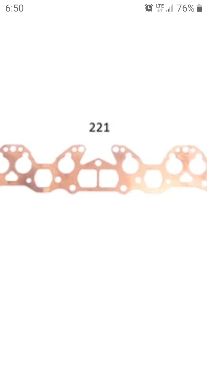

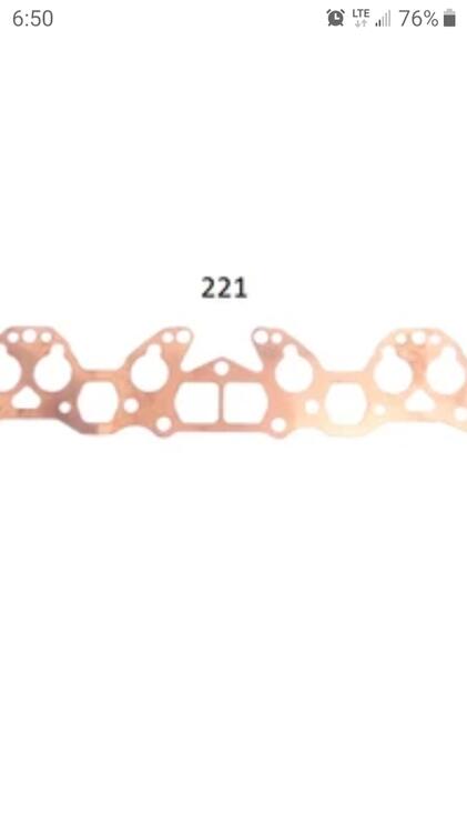

November 8, 20213 yr Author comment_631161 You have way more skills than i do, we all know that, going that deep. I can't even imagine how I would get the flange that hot then back on a cold head without pulling the whole left side off. "Take my wife from me please". I'm thinking the ambient temp aluminum head's threads will allow me a bit more tightening down. I'm sure it'll do it again sooner or later but I may go with 2 gaskets? Zcardepot.com has the copper diamond ports with injector holes I could probably Dremel out to match the square ports on my N42. Uh...I'm not so sure that's doable now after seeing how close I'd be to the stud holes. Oh well Yellowstone season premire in a minute. Time to veg and watch the Duttons raise hell. Link to comment https://www.classiczcars.com/forums/topic/66016-header-leak-question/#findComment-631161 Share on other sites More sharing options...
