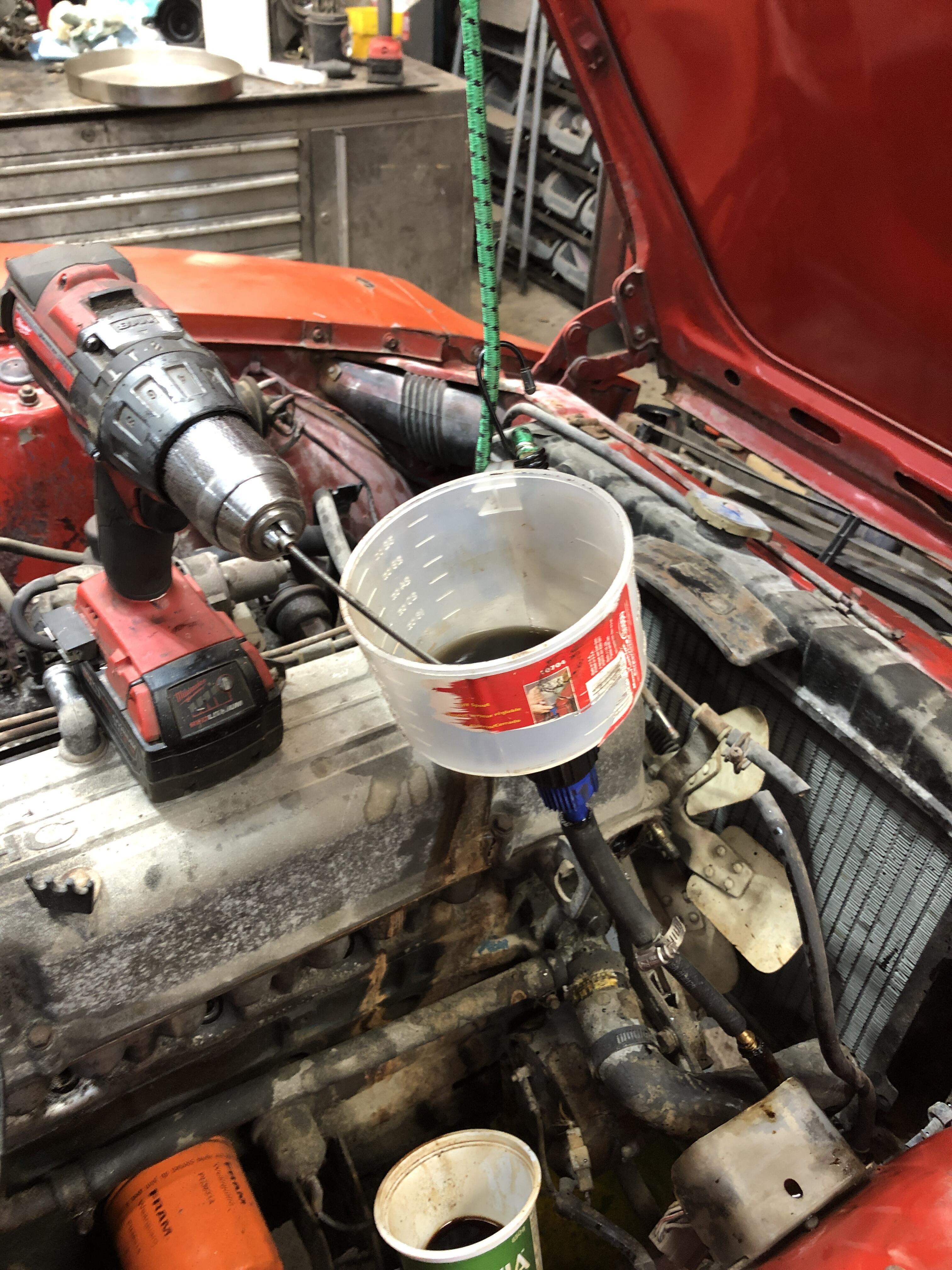

So my usual approach with fuel line blockage is Lacquer Thinner. That stuff eats fuel deposits like nothing I’ve seen. With a blocked line, you hang up a funnel with a hose into the hard line in the engine bay, fill it with lacquer thinner and wait. And wait, and wait. Eventually the stuff will eat through the goo and clear the line. Eventually

Then I start thinking about the rotating core wire. You don’t suppose……..   I go grab it, and have a look. Its pretty long, like about 7 feet long, and has a diameter of about 1/8” or so. real flexible, but the end has stiff part about 1” long that ground down square, like they welded that section to lock the spiral outer core to the center so it would grind down without fraying. It’s too long to make any decent turn in the fuel pipe. Dang it. But if I cut it down to about 1/4” of hard square end it might!
Chopped it off, and I chuck the other end of the thing in a drill, and start stuffing the chopped off end down my fuel line.
Well I’ll be horn swaggled! That thing digs in and heads on down the line making all the bends along the way.

Now I have to explain something. While I could drill the line, it didn’t clear it. I had to then move to stage two, which was to hook up my lacquer thinner soak funnel and line, then drill down through that, which got the thinner down into and distributed through the fuel line. B0283215-EEC1-403D-BBA0-85CB3BA70CEB.jpeg

After about 15 minutes of drilling, and pushing it in and pulling it out, I saw some magic at the other end of the line. A slow and steady drip of goo coming out of the other end!
Pretty soon a stream of lacquer thinner started to flow. I ran a litre or so of the stuff through a couple of times and called it good.
