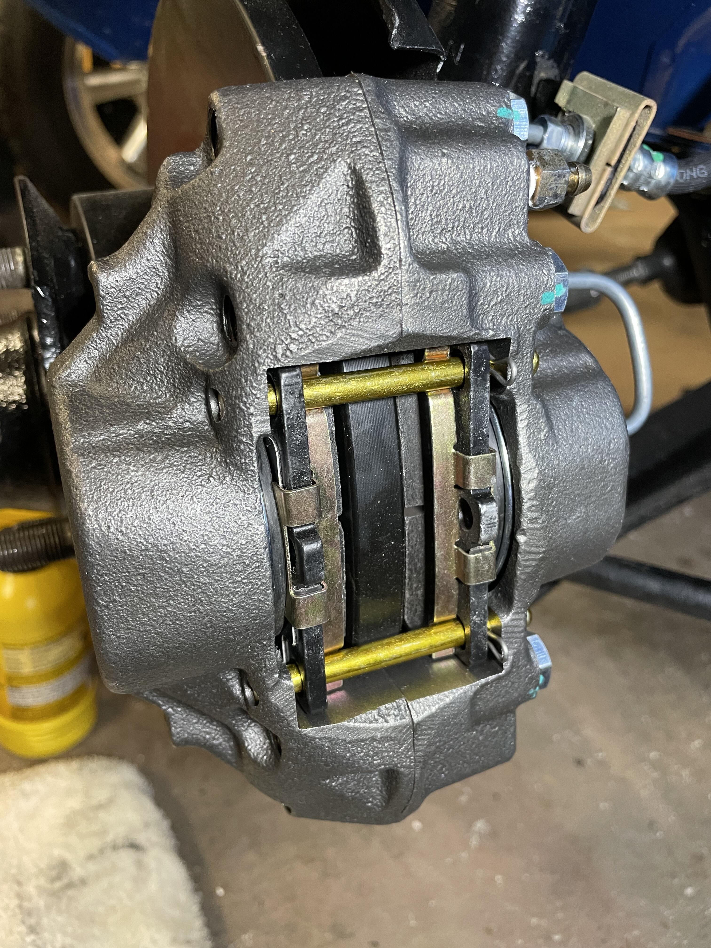

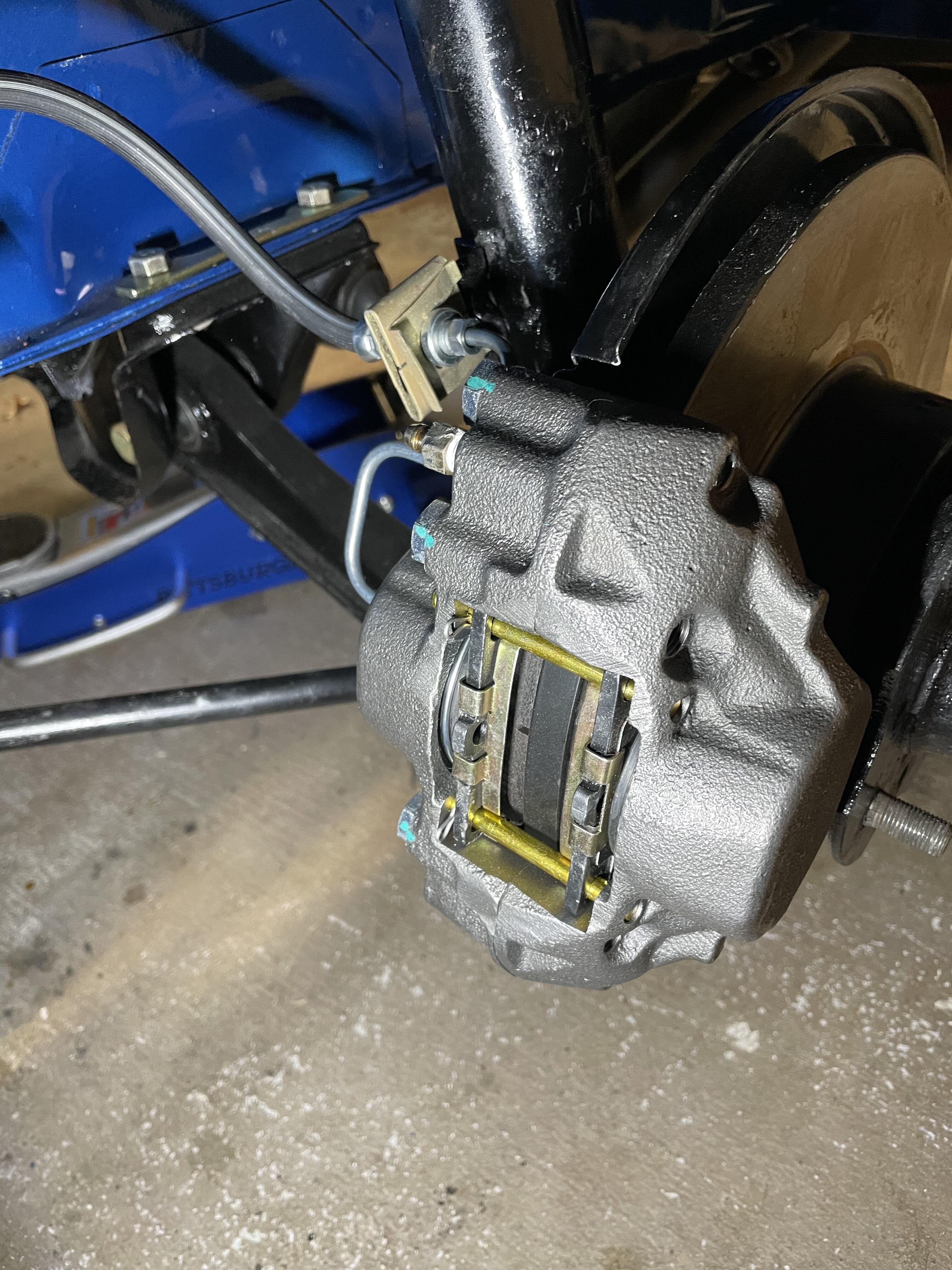

I am struggling to get sufficient brake pressure at the front calipers on a 72 240Z.
I have a rebuilt booster, new master cylinder, new (rebuilt) calipers at both wheels. The rear drum brakes work. After much work and brake bleeding, I have fluid at both front calipers. However, when the brake pedal is pressed, the cylinder pistons don't move at all. I would suspect that I have a leak somewhere that doesn't allow sufficient pressure to engage the brakes but I don't see any fluid leaking anywhere in the system.

I did check the length of the booster rod vs the depth to the piston. I adjusted the booster rod length so that they are within a few 1/10s of an inch of each other. I haven't checked the reaction disk in the booster. I assume that I need to open the booster to check that? When the MC is removed and I depress the brake pedal, the booster rod extends, although I haven't attempted to measure the force. The booster was rebuilt by Prior Brake Products in Mesquite, TX.

Another data point - When I push the brake pedal to the floor, the brake pressure differential warning light comes on. Also, sometimes there is an audible "poof" that allows the pedal to go lower. Not sure if that's a pressure relief of some sort in the booster?
