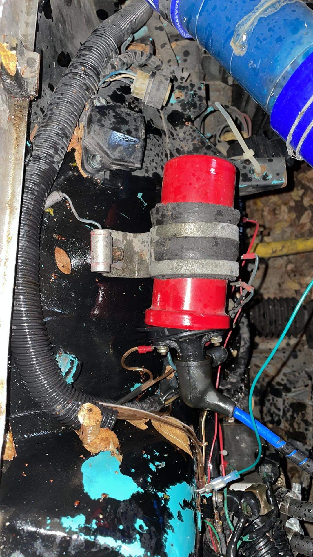

November 18, 20213 yr comment_631780 Do you have a picture of the exploded coil? I've never seen one or heard of it happening. An internal short could pass enough current through to heat it up rapidly but even then the negative terminal wire and positive terminal wire would have to pass the current, and the negative terminal would have to supply a ground path. If the ignition module was shorted or the negative post wire shorted to ground, the coil could heat up more slowly and maybe get hot enough to smoke or something. Either way, the coil itself would only be the cause of the "explosion" if it was internally shorted, and there was a path to ground on the negative post side.. More likely that the source of the failure is somewhere else. Better check the other components before you get carried away with new parts. Heat comes from current and current only happens when the circuit to and from the battery is complete. Link to comment https://www.classiczcars.com/forums/topic/66049-ignition-coil-exploded/#findComment-631780 Share on other sites More sharing options...
November 18, 20213 yr Author comment_631783 19 minutes ago, Zed Head said: Do you have a picture of the exploded coil? I've never seen one or heard of it happening. An internal short could pass enough current through to heat it up rapidly but even then the negative terminal wire and positive terminal wire would have to pass the current, and the negative terminal would have to supply a ground path. If the ignition module was shorted or the negative post wire shorted to ground, the coil could heat up more slowly and maybe get hot enough to smoke or something. Either way, the coil itself would only be the cause of the "explosion" if it was internally shorted, and there was a path to ground on the negative post side.. More likely that the source of the failure is somewhere else. Better check the other components before you get carried away with new parts. Heat comes from current and current only happens when the circuit to and from the battery is complete. I attached the picture but it basically just blew the cap off and sent oil flying. The wiring is not the best so I’m going to go through it and make sure it won’t happen again, but the coil was 17 years old so I don’t know what could’ve caused it. Link to comment https://www.classiczcars.com/forums/topic/66049-ignition-coil-exploded/#findComment-631783 Share on other sites More sharing options...
November 18, 20213 yr comment_631784 Was the engine running, or the key on? I'd guess the P.O. connected the blue coil negative wire to a ground terminal or shorted it out by accident, you turned the key on, the coil overheated and popped it's top. Is that a Blaster or did the PO just paint the stock coil red? Download the 1980 EFI book, and the Factory Service Manual if you want to figure things out quickly. Replace and hope doesn't do well on the EFI cars. No offense intended. If the PO bypassed the ballast resistor then he/she probably did something with the ignition module. Might even have a ZX distributor on there. 14 hours ago, Reid280z said: The po bypassed the ballast resistor Link to comment https://www.classiczcars.com/forums/topic/66049-ignition-coil-exploded/#findComment-631784 Share on other sites More sharing options...
November 18, 20213 yr Author comment_631787 43 minutes ago, Zed Head said: Was the engine running, or the key on? I'd guess the P.O. connected the blue coil negative wire to a ground terminal or shorted it out by accident, you turned the key on, the coil overheated and popped it's top. Is that a Blaster or did the PO just paint the stock coil red? Download the 1980 EFI book, and the Factory Service Manual if you want to figure things out quickly. Replace and hope doesn't do well on the EFI cars. No offense intended. If the PO bypassed the ballast resistor then he/she probably did something with the ignition module. Might even have a ZX distributor on there. So the car actually wasn’t running and off but I was hooking the battery back up before. And I’m not entirely sure what the po did before me, so it’s kinda hard to figure out what coil to use. Link to comment https://www.classiczcars.com/forums/topic/66049-ignition-coil-exploded/#findComment-631787 Share on other sites More sharing options...
