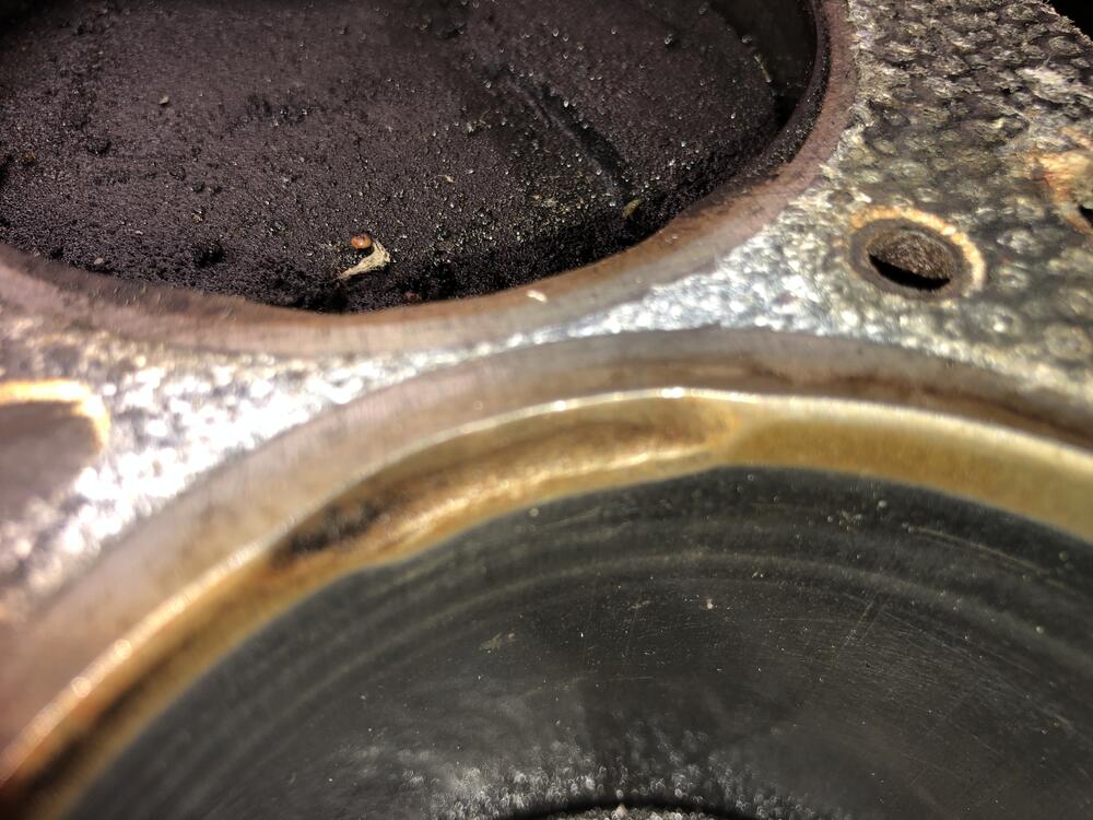

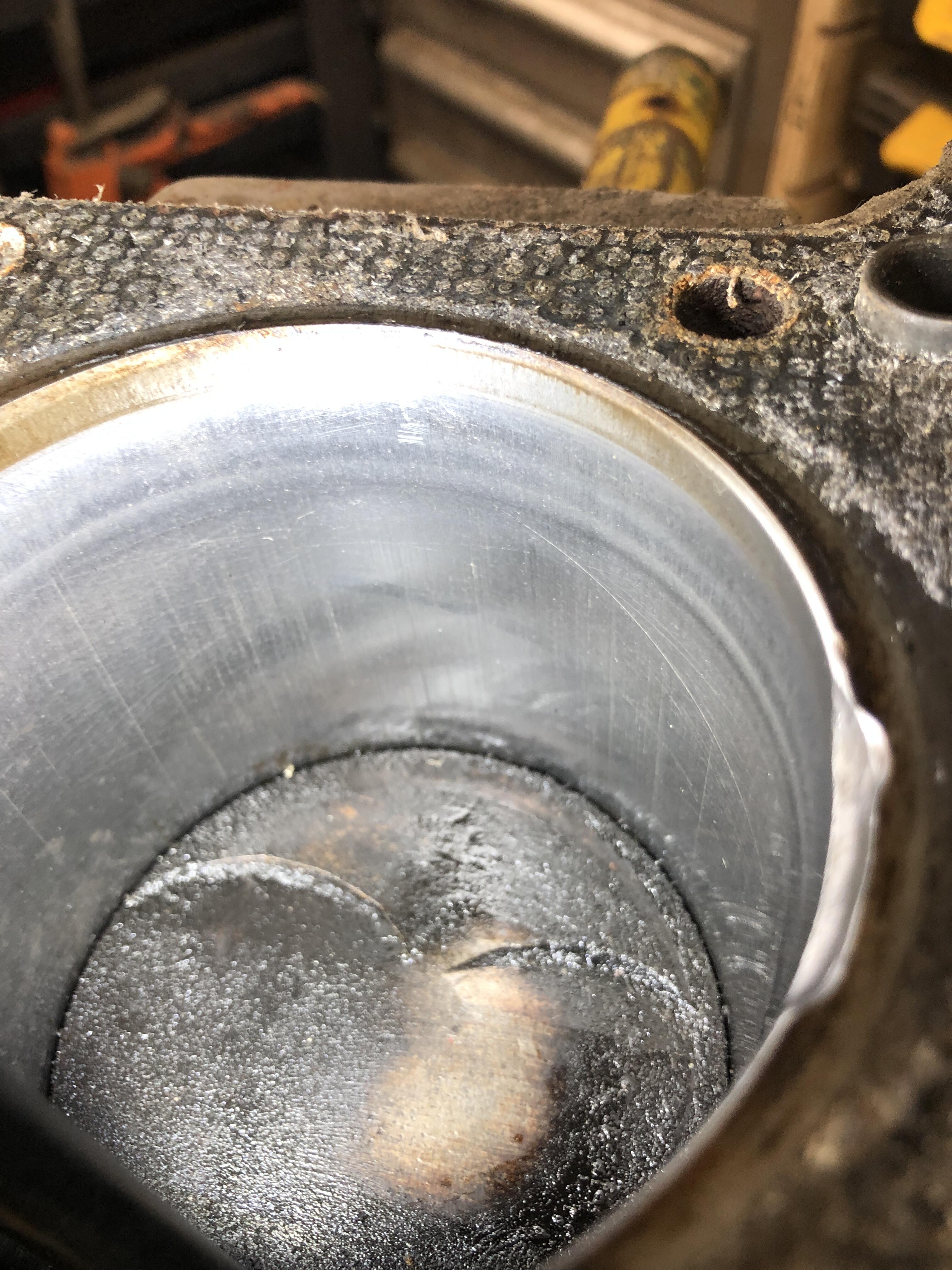

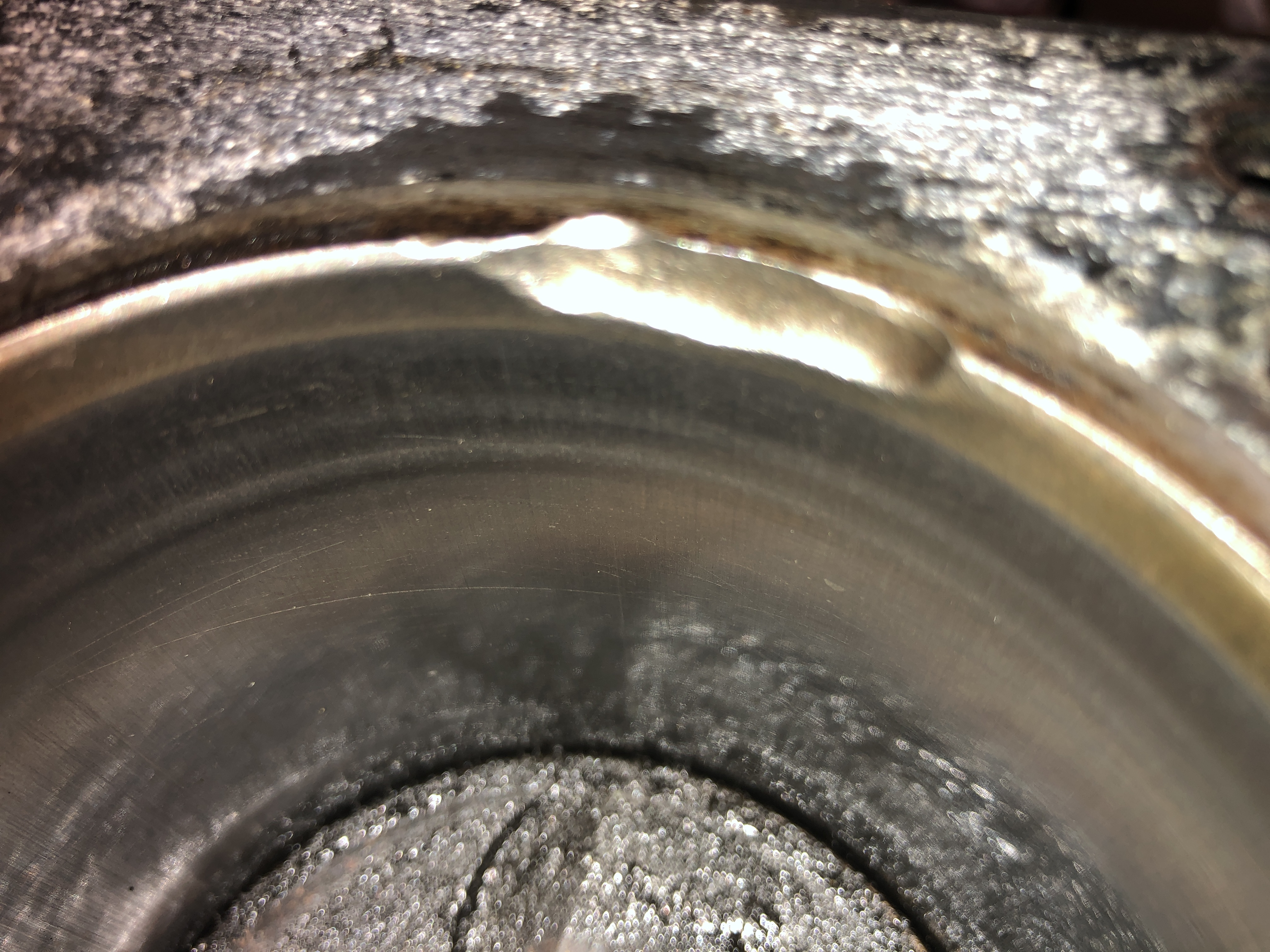

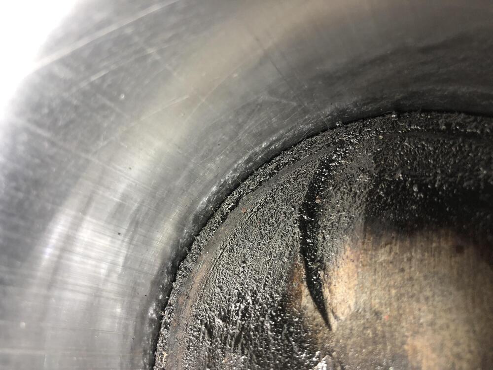

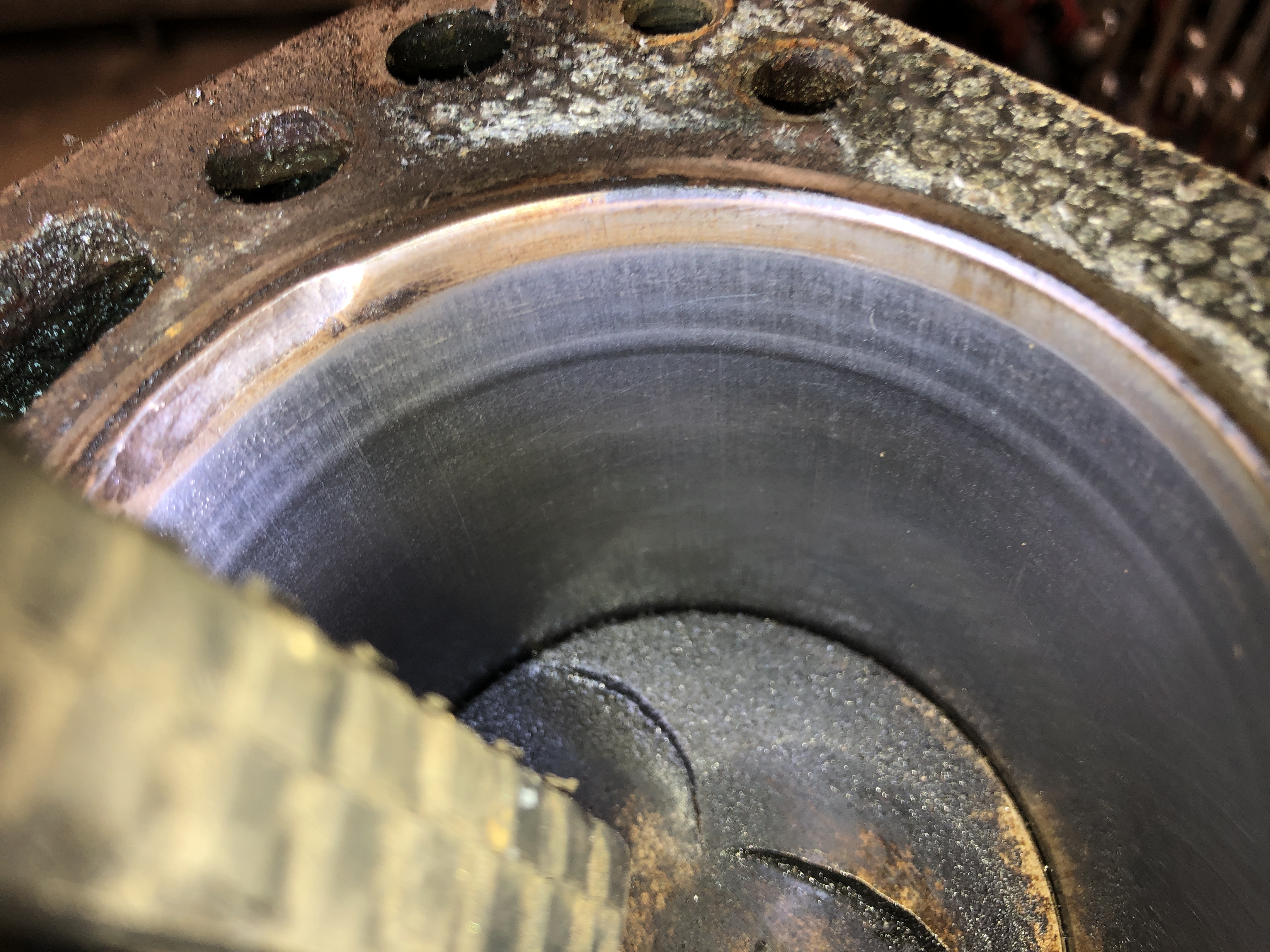

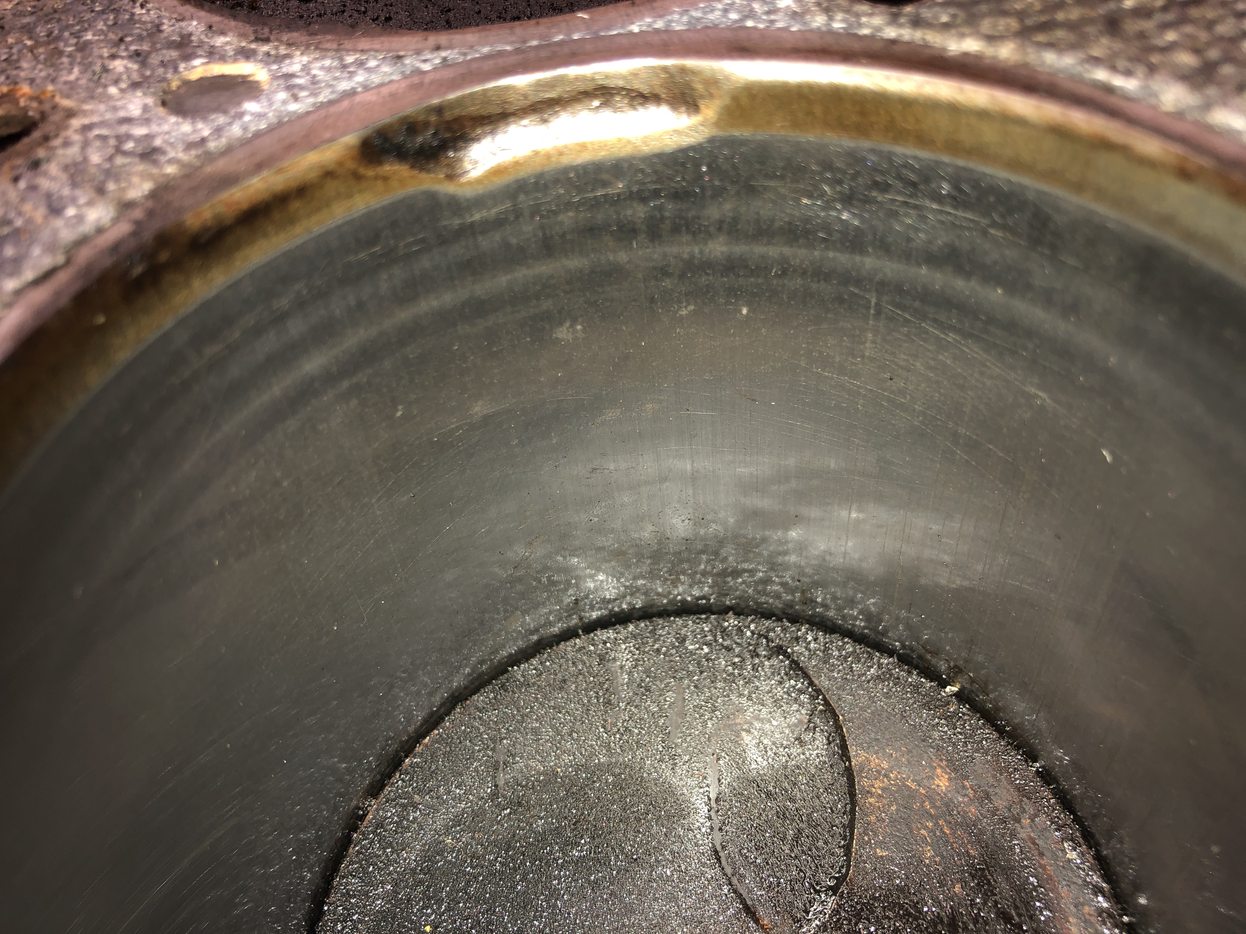

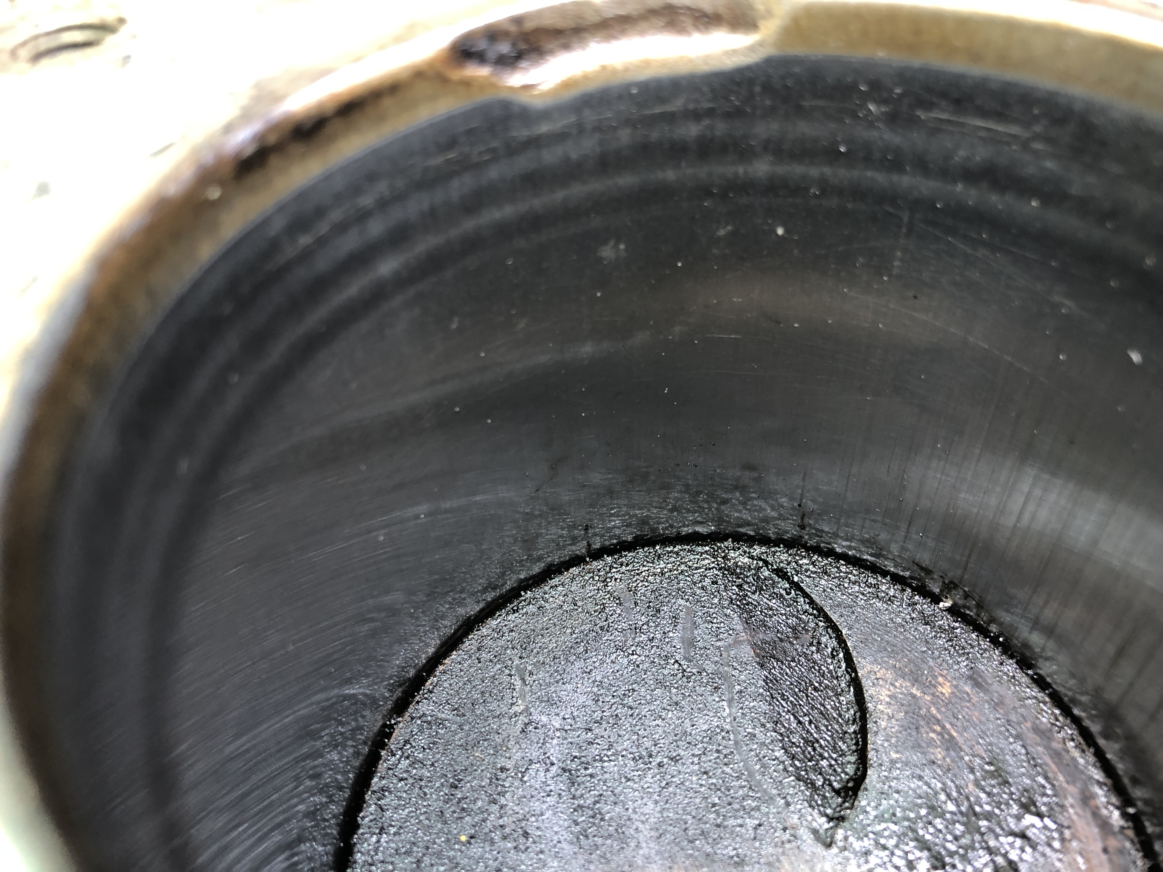

Back to the original topic (harumph….). I’ve a L24/N42 combo in a 72 with crap for compression. 100-20-20-20-50-90. Oh oh…. This was an engine free spinning but not run for 10 or 20 years, cold with 10cc of oil added through plug holes, cranked until engine got oil pressure, which was almost immediately.
Not number matching block, so something someone stuffed in. Block number is 90xxx, chassis has 160xxx mi. What’s left of it…
So why the poor or absent compression? Did someone not notch the L24 block for the N42 exhaust valves? Bent valves? Not likely, #1,5,6 has SOME compression.
Pulled the N42 head, its been rebuilt at some point, clean, all new exhaust valves some new intake valves, AND!!!
the SHINIEST smoothest almost 99% no more hatching on the cylinder walls that I have ever seen. Stock 83.00 bore.  This thing must have 500,000 miles on the short block. No matter what block I’ve seen (not rebuilt) the stock hatching is plain for all to see., Not this thing.
Good new might be, fresh hone, fresh rings, and it might just drive away happy.
Oh, and bores had been notched. Someone new enough to do that when this N42 head was put on, but didn’t bother to check the state of the bottom end. I suppose that’s why I’m parting out a rusty 72 now…..

If thats so uncommon, you must have made a pic of it?  I  (we?)  want to see a poor cylinder.. how does it look? 😮

Yes pictures are definitely in order here. Will comply shortly, I hope they convey the smoothness.
Long block is block/pistons + head, short block is block/pistons only.

Not sure this is helpful.
Under just the right conditions of light and angles, I can see remnants of home marks, but overall they are remarkably smooth.
First four are all cylinder 1.  Last two are the notches cut in #1, and 3td last is cylinder 6
