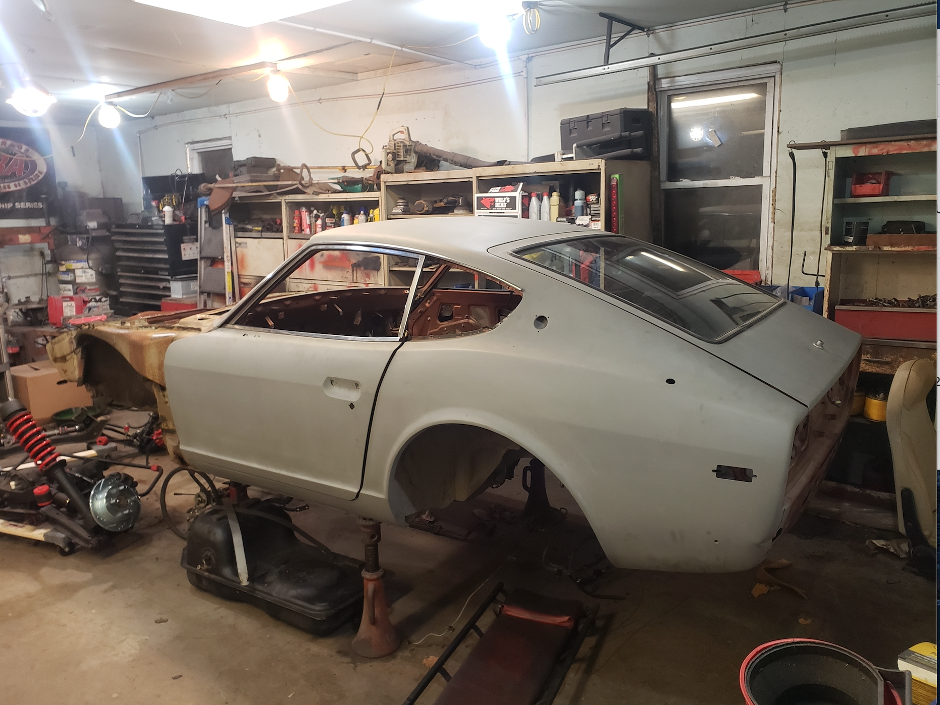

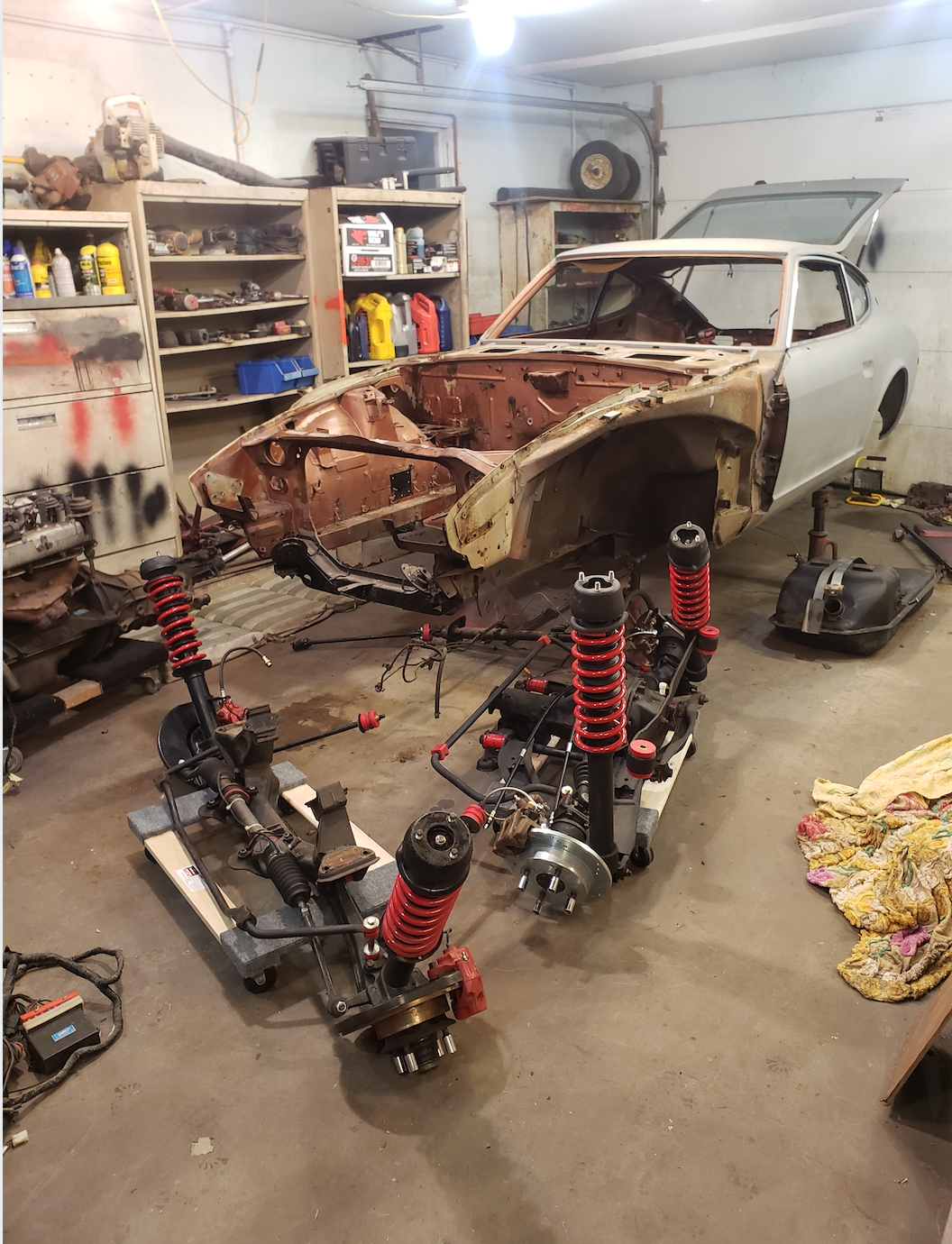

Made some good progress today.. the car is now basically stripped with the exception of the doors and the hatch. I'll pull those off after I finish the bodywork and get the car ready for paint.

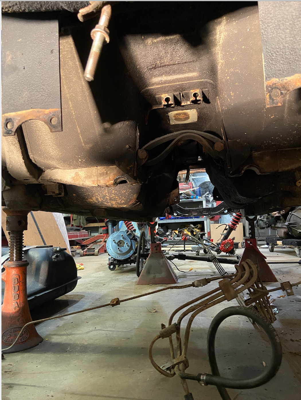

On the underside, I intend to tackle any visible surface rust. I'll use a wire wheel to get to the bottom of it, repair what needs to be repaired, and POR15 the rest. Then undercoat the bottom to make it uniform... any suggestions from any other builders?
The disassembly is complete... only took 2 weeks, basically weekends only, lets hope the rest of the process moves along just as quickly😂
Patch work of rotted out areas has started... There are a few that I've found during disassembly, notably on the rockers under the front fenders, under the battery tray, under the passenger seat, and on the front and backside of the passenger side rear wheel well. All in all, not too bad but there was bondo on the front part of the rear passenger wheel well and as I grinded it out, it went right through to the lower portion of the quarter panel... oh well.. Luckily its a small and simple patch.

I'll next turn my focus on the underside of the car.... still not sure if I want to media blast it... I go back and forth daily. while I would like to, I am not sure if I want to awake sleeping dragons although I like the look of the underside of a car when its clean and rust free. I currently have a good layer of undercoating.
What have some of y'all done? did you blast the bottom and not put undercoating and just primer and paint? or put undercoating regardless? Just trying to figure what's best for this build... I know its up to me in the end, but would love to hear some opinions/experiences. any help or advice is appreciated.
I would put some primer/grounding paint and a layer of clear wax on the underside. That way you can always see in what condition your floor is..
The trouble with that black undercoating is you can't see anything until it's to late..
