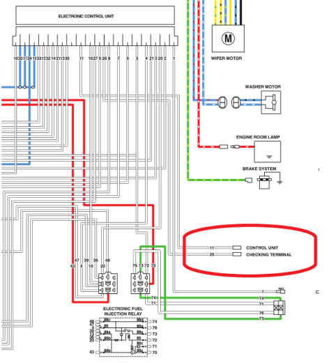

Can someone help in telling me where these connectors are supposed to go? The two white wires come off the ecu. The other connector is under the passenger seat. Thanks in advance. 20240115_130258.jpg20240115_130228.jpg
