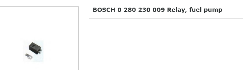

@Zed Head thanks for the links. I’ve narrowed down the other connector to the floor temperature relay. Does anyone have a picture of it to help me locate it in my bin of parts? I found the attached that fits but not sure if it’s the correct one. Any help is appreciated.

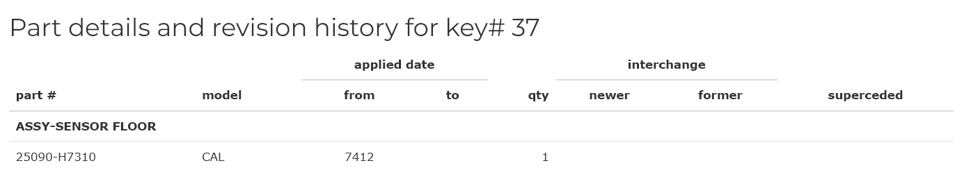

I found what seems to be the part number but can't find it in the drawing.  Might be that the Bosch part has the same function.  Seems like it would have a bimetallic strip inside that moves as temperature changes.  If there's no strip it's probably the wrong part.

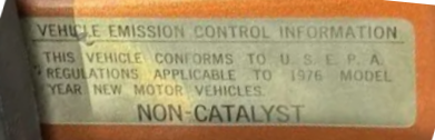

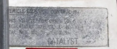

By the way, I think that if the car is a Federal model it won't have the sensor because it won't have the catalytic converter.  If the car is a California model the label on the door jamb will say "CATALYST".  If it's Federal it will say "NON-CATALYST".  Not sure if they left the sub-harness in anyway if it doesn't have a converter.
