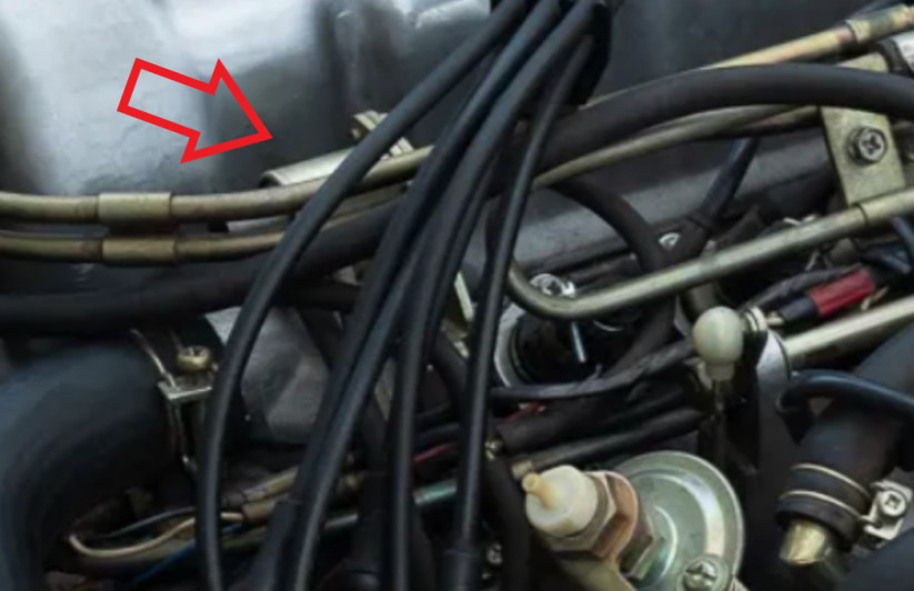

Can someone help identify where these connectors go? The yellow wire goes into the thermal transmitter but I can't figure out the red, white, or black. For the white and black the manual says vacuum switch solenoid. I can't find it, maybe I'm missing parts. The red is supposed to go to a water temp switch, I can't find anything to connect it to. Photos would help. For reference, it's a 76 280z. The red circle in the Pic below is where the loom connects.

The vacuum switch might be for top gear timing advance.  It opens vacuum to the vacuum advance canister on the distributor in high gear.  Retarded ignition timing is cleaner than advanced.  It's an emissions thing, some people remove it.
The water temp switch is also emissions related.  It switches to the more advanced timing pickup in the distributor when the engine gets warm.  If you don't have the dual pickup distributor it doesn't matter.
I think that cars with catalytic converters might not have either of those,  CA vs Federal.  I had both.
Too many pages to go through and figure out what exactly your collection of parts is.  But you don't really need either of those things, by the labels you gave them.  Just make sure that any loose wire ends aren't powered and/or are protected.

A followup - The water temperature switch is in the thernostat housing.  There's a wire to an eyelet that is supposed to attach to a mounting screw for grunding.  The wire often breaks right at the junction with the switch body.
The vaccum solenoid would be mounted somewhere near the front of the engine above the intake runners of the first two cylinders.  Notice that the black wire is a separate wire with a bullet connector and an eyelet, to connect to a screw for ground.  Easy to lose, it's just a short little wire.

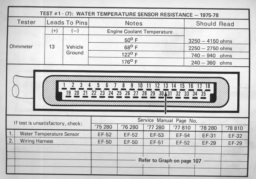

Baeed on some things i have done so far, seems to be a fuel delivery issue. I am troubleshooting with the EFI Bible and am wondering if anyone can point me to the ignition lead wire. See photo with highlighted sentence. Thanks in advance.

The fact that it runs best with the throttle wide open kind of implies that it might be super rich.  That could be from a hole in the fuel pressure regulator diaphragm or if the coolant temperature senosr circuit is open/high resistance.  You might do the Pin 13 resistance measuremnet at the ECU and see if it's in the right range.  And pull the vacuum hose to the FPR to look for fuel.  It should be dry.
