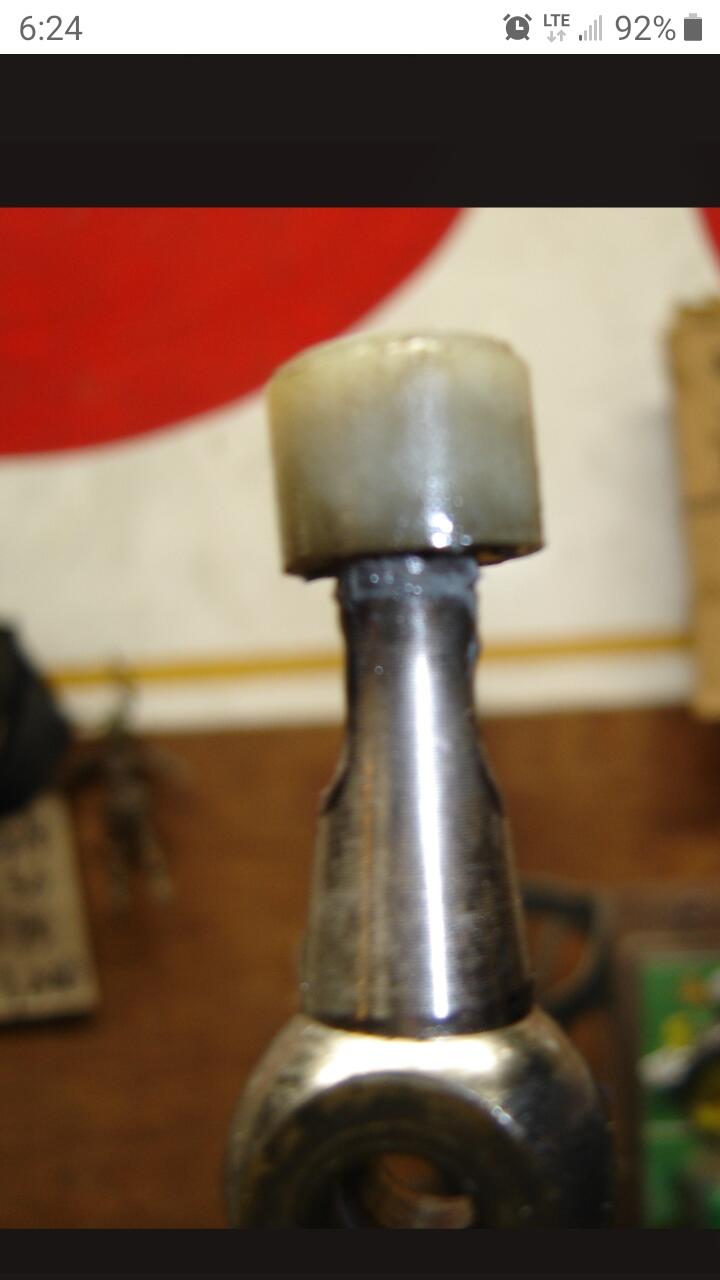

Just a heads up on the wide 5 in my 240. It would pop out of gear. Finally figured out the shifter was hitting the tunnel and going completely into some gears.
Post #16 shows the nicks on the shift rod I found. Some light grinding fixed me up, no more issues.

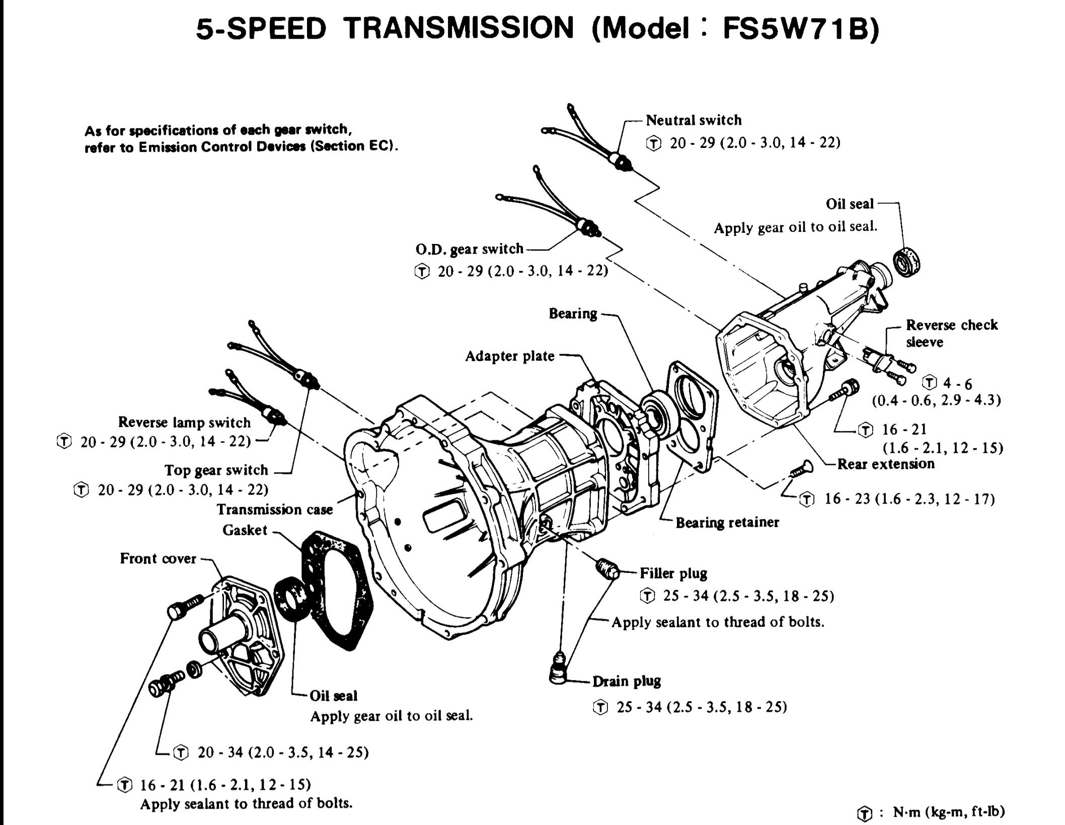

Hey, I wanted to piggy back my question on this recent thread.   These transmissions can get confusing and especially telling exactly which one you have.  I pulled a 5 speed out of my car (wasn’t original - had yellow marker with 280Z 5 speed written on it).  I assumed it was a wide ration 5 speed from an early ZX or late Z.   This transmission had two electrical switches near the filler plug.  I assume one was reverse light and the other a neutral safety switch.   The transmission I got off a 82 or 83 ZX, can’t recall, only has one switch and I assume it’s the reverse light switch.   When I looked at the 82 FSM it shows four switches on that transmission?  Other 2 say  “top gear” and O.D switch.  Wondering Is it possible I don’t have a close ratio ZX tranny since it only has the one switch?   My car wiring harness only has one connection too, which. I Image again is the reverse light  switch.   So I have two 5 speeds and I’m not 100% sure which ones they are.
My propeller shaft and transmission were not original it appears noted by the yellow marker.  No idea what Easter egg I’ll find with the differential because I bought an 82 ZX diff too…..it’s possible there is one already on my car?  II want to get the right combo of transmission and diffs as well so ID’ing everything I have properly is critical.   Time to crack open diff cases I guess.  Too bad I leave for work for 11 days on Monday.  Doesn’t my job know I’ve got work to do on the Z?
This image below is from the 82 FSM
I don't think that I've ever seen all four switches on a ZX transmission.  I think that two is more common.  But it's easy to tell close and far apart by the exhaust hangers on the back and the reverse lockout plate on the side, among other clues.
