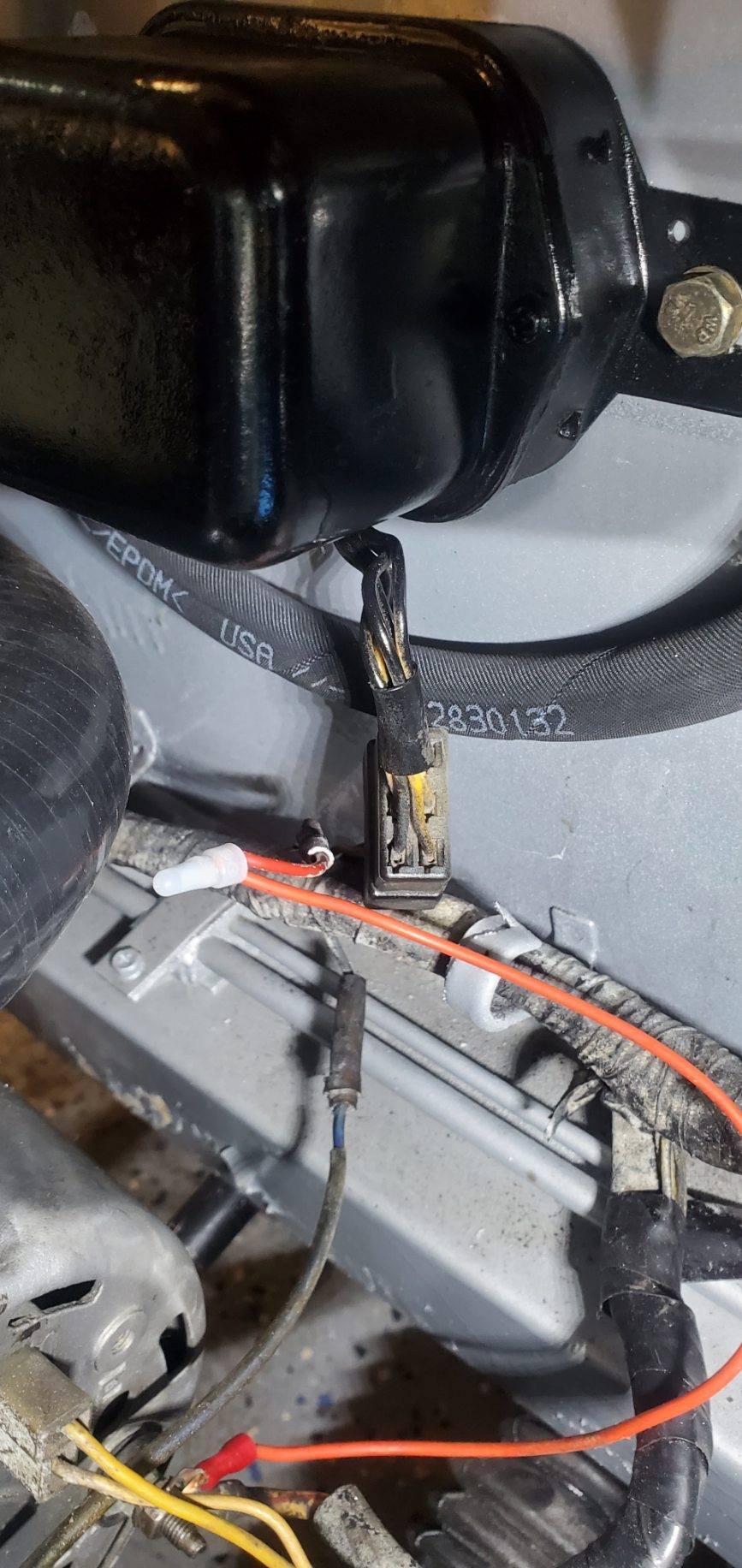

My 240Z starts just fine, but it keeps running after I turn off the key and remove the key.  It runs smooth as if I never turned it off.  The car does stop when I turn off the key and remove the lead from the alternator.  Another thing is I thought 240Z had to have the tachometer connected to run, but I could be wrong.  It does run without the tach.  I also swapped the ignition switch and still have the same problem.
Any help pointing me in a certain direction is appreciated.  Ideally, someone that experienced this before.

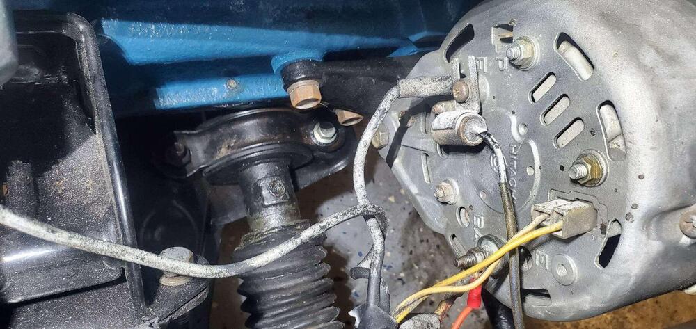

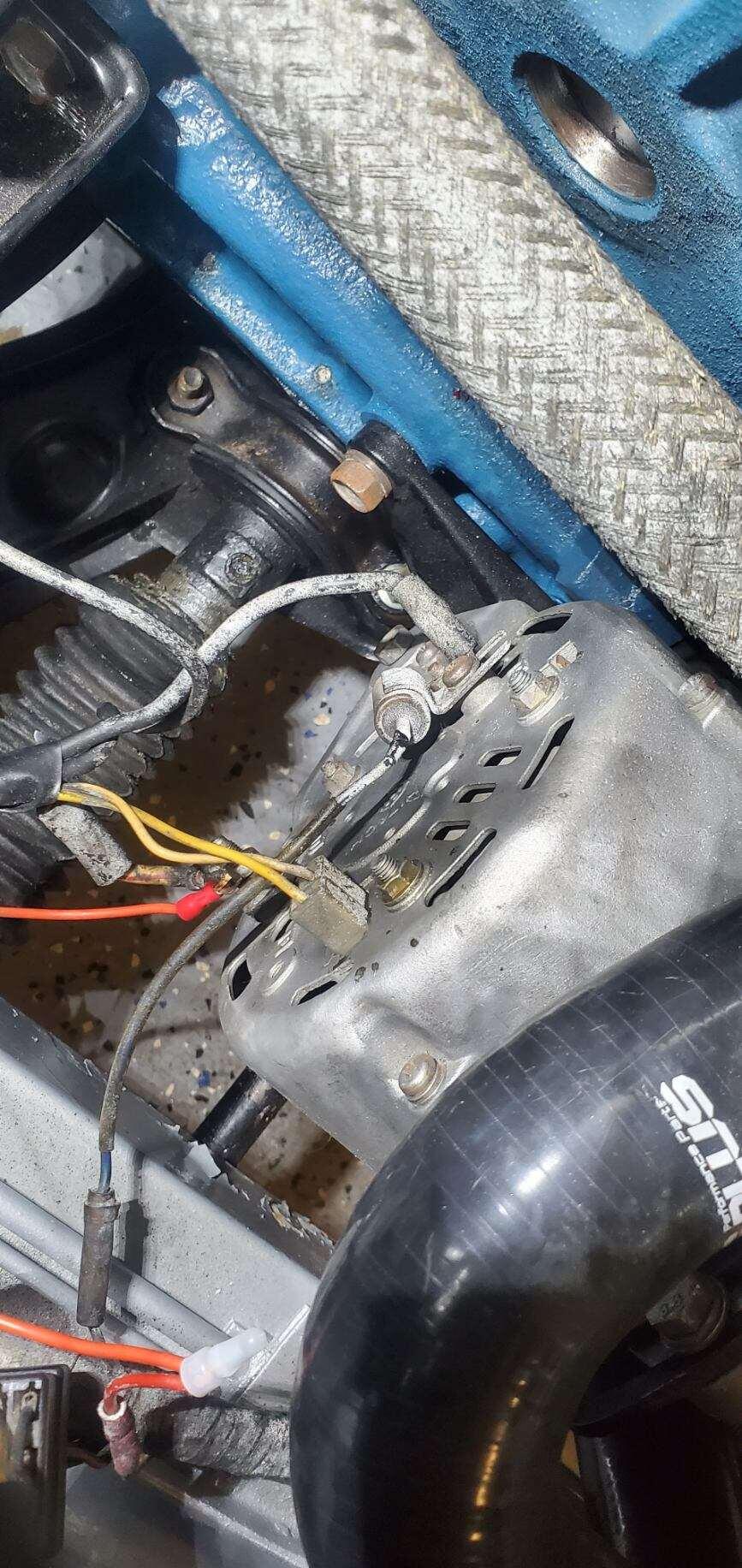

Let's break things down. You said the car will shut off when you unplug the alternator. That means the alternator is backfeeding the ignition. That would be on the white/black wire attached to that plug. You may want to use an ohmmeter to measure the resistance between the white/black wire at the plug on the alternator and the black/white wire on the wiring harness. You'll need to backprobe the connector to get to the black/white wire. If the resistance is low, there is evidence of your problem. You will probably still need a diode to prevent the backfeed.

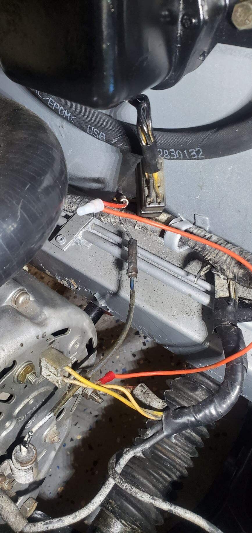

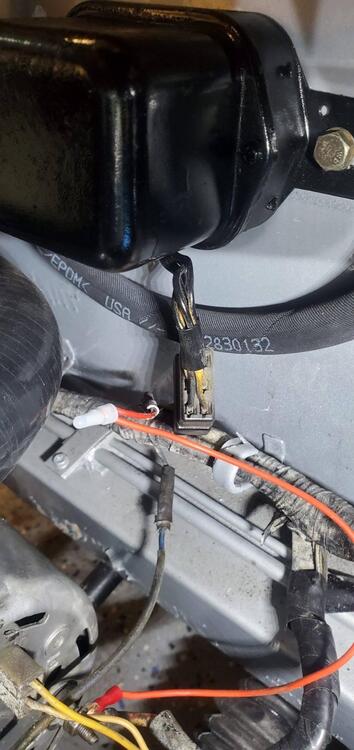

Someone has definitely altered the wiring on your car. Nissan definitely NEVER used a wire nut on the Z wiring... (As an aside, I asked my wife if she could see what was wrong with the picture of the voltage regulator. She picked out the wire nut, too.)
How long have you owned the car? It sounds like the IPO left you some surprises. What ignition system do you have on the car? I'm guessing it's not points. Anyway, you can wire the coil so that the tach doesn't work, and the car will run. Post some photos of the area around the ballast resistor and coil. If it's as I suspect, I have a video to help you sort that out.

With the external regulator doesn't the backfeeding happen at the regulator?  It's mechanical, I don't really know how the things works.  But, the "break" should be there, in the regulator, either a diode or a relay of some kind.  Maybe it's just a sign of a bad regulator.  Might be worthwhile to examine the plug and wiring very carefully, and the bottom of the regulator.  There is exposed circuitry underneath, if I recall right.  Might just need a cleanin'.
Actually it's not too important to find the exact place for the cross connection. The diode could be incorporated at the plug at the alternator.
Of course, it might be easier just to replace the VR if it's bad, hence my suggestion of testing the resistance at the wires.
