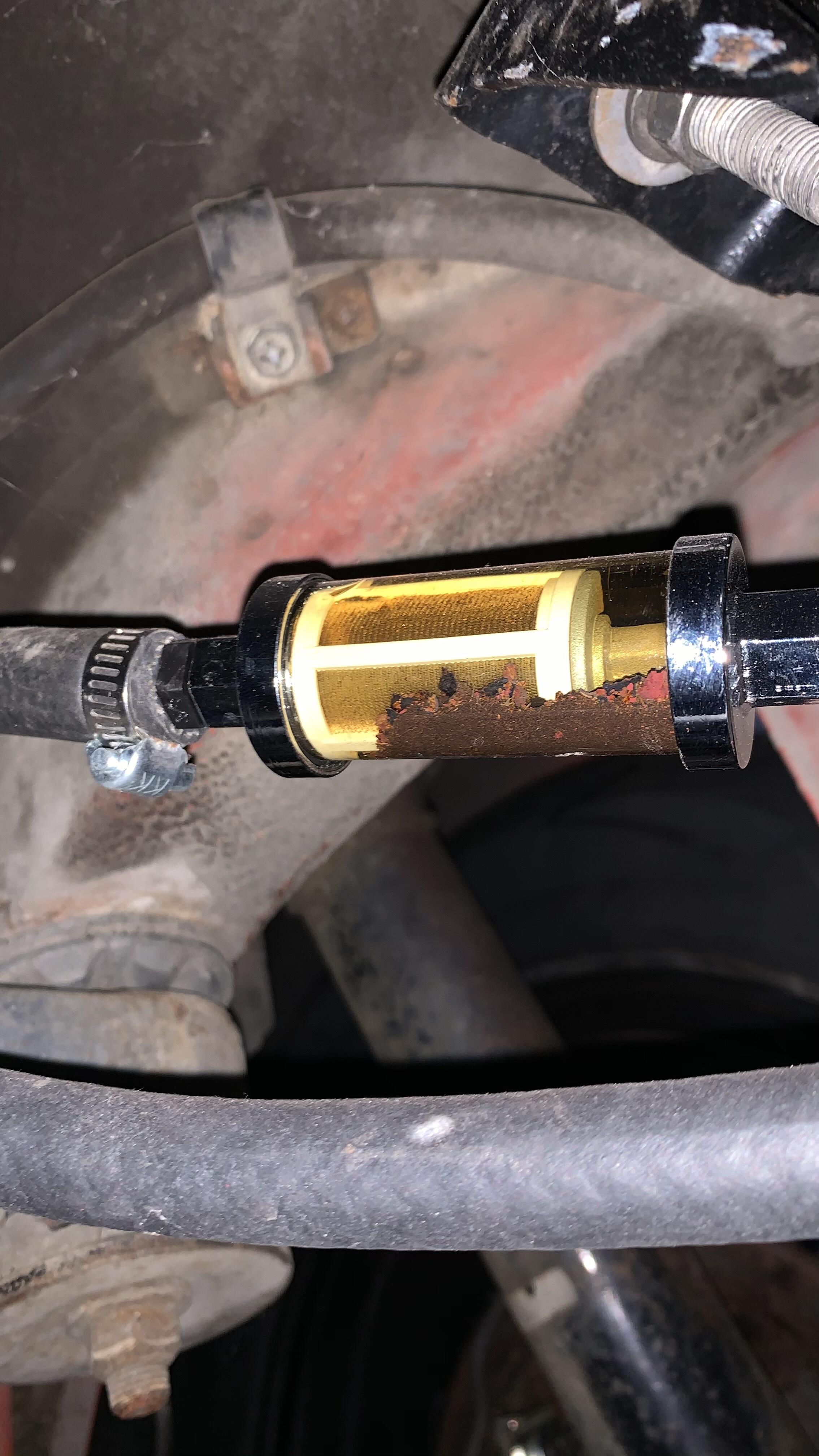

Cliff, I get your position but I’m not driving it yet because I’ve still got work to do.  Welding the floor patches, rear suspension and my latest problem.   I decided to put 5 gallon of fresh gas in the tank yesterday and woke up this AM and the garage was full of gas fumes.  So bad you could smell it in the master bath above the garage.   The tank is leaking where the two metal hoses exit the tank, one goes to the pump and the other is the return line.   I thought stopped it with JB weld but that didn’t hold.   I also had rust particles in my pre-filter.  Bottom line the tank needs to come out and  be replaced or repaired,  I had this tank boiled and sealed two years ago but  it appears to not be working as advertised.

Mine is on the way. Should be here next week. I’ll post pics when it arrives. I’m just happy to find one. Went through the tank at a radiator shop, redcoat etc. still had pin holes seeping.  Good riddance!!

I feel like every corner I make on this car there are three more fallen trees in the road I need to get around.  I thought my tank issues were in my rear view mirror.   While that tank is a bIt expenses you won’t ever mess with it again or be suck on the side of the road with rust backed up in your.   If I drop my tank now I run the risk of fuel leaking in my garage from lines while I’m flying Christmas gifts around.  My wife would be pissed so, I’ve drained the tanks and leaving it alone.  Once I get the tank out I can make a better assessment but will probably end up buying the same tank you got.
