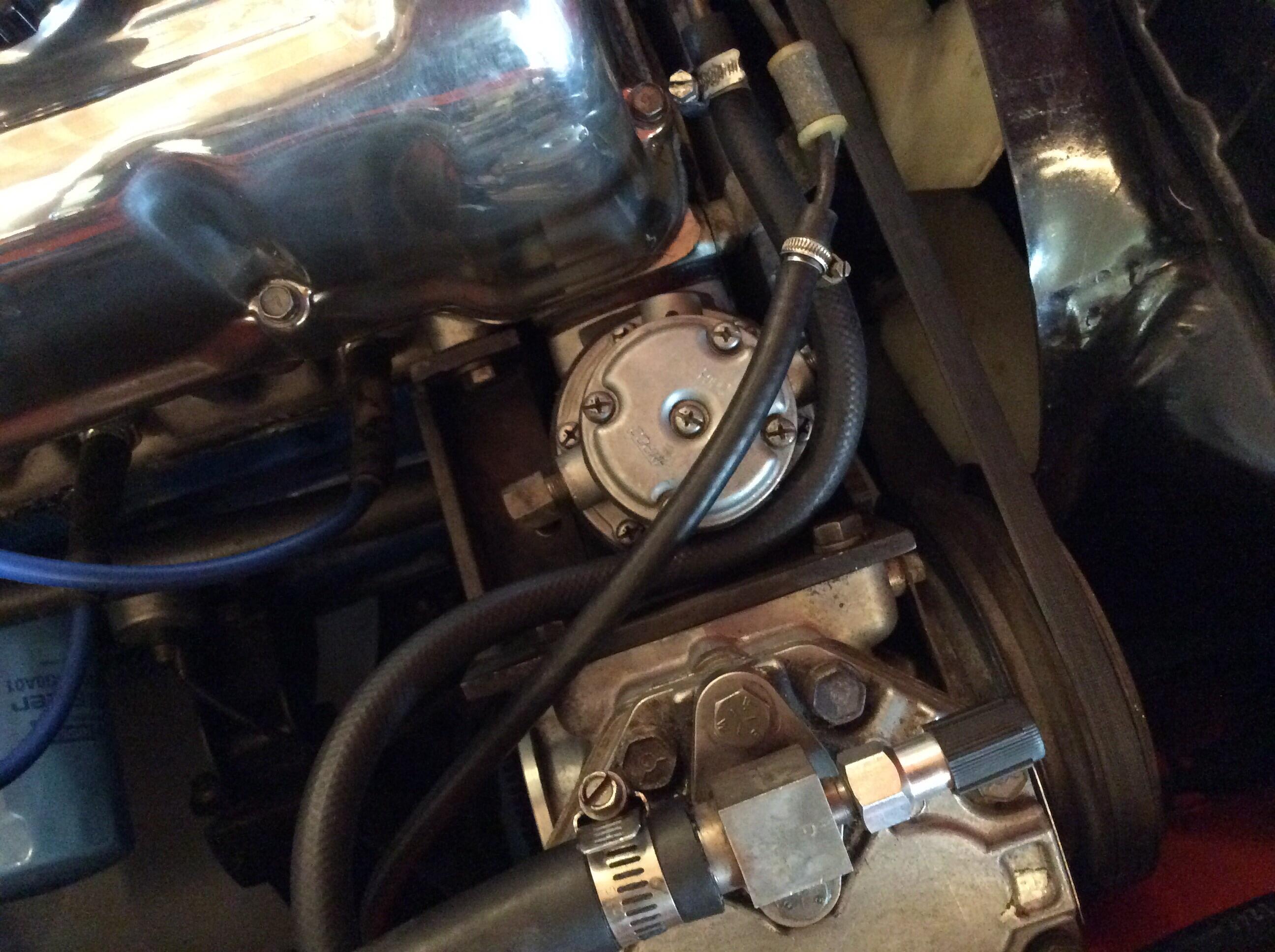

....now the electric pump is mounted and then I will keep the mech.pump sitting on its place to keep the look original.
Is that possible just to let it sit without dismantle some part from the pump or should I do something else?
Sorry my bad english.
Yeah I'd leave it too. That York compressor bracket is a huge pain to deal with just to get the pump off.
Maybe cap the open IN and OUT holes with something though. Your electric pump probably had those rubber caps on it.

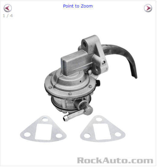

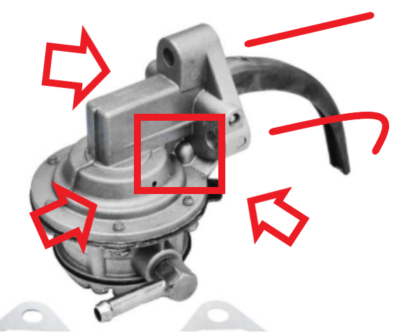

Now it works great with the electric pump but after a ride today there was a mess with oil on the engine, filter, generator, the whole right side of engine and I discover oil is coming from the mech fuelpump, from a little hole on the side of lover body on fuel pump pointing backwards just beside of one of the screws which hold the pump to engine.
I just left the mech pump on its place so it looks original.
Why is there oil coming out from there?
You could even draw on SteveJ's picture.  Do something.  There's a lot of different mushroom shapes out there.  Might be that the diaphragm has blown and since there's no fuel passing through the pump it lets oil leak out.  When fuel is flowing sometimes they leak fuel in to the crankcase.
