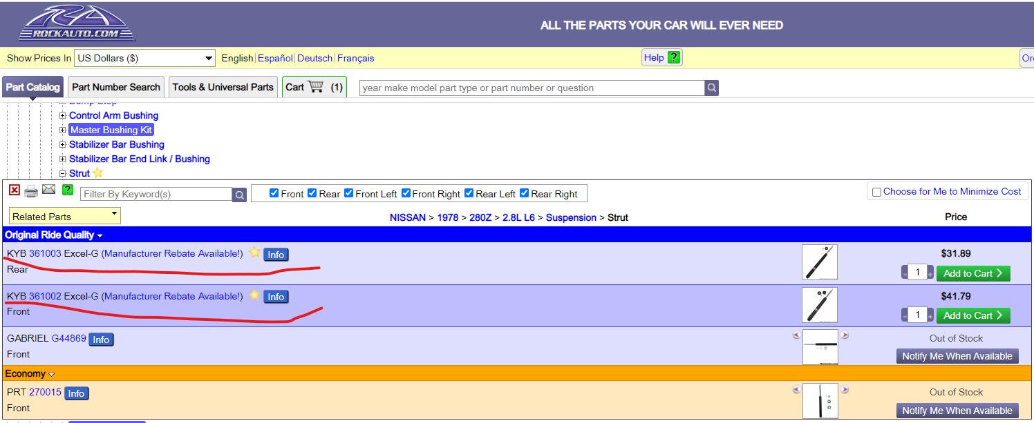

December 13, 20213 yr comment_633064 Rockauto The second link in your post was for a 280ZX. Those would not work on a 78. The price from Rockauto would be better than the other ebay link, plus there is a rebate available if you buy before 12/31. Link to comment https://www.classiczcars.com/forums/topic/66149-strut-replacement/#findComment-633064 Share on other sites More sharing options...
December 13, 20213 yr Author comment_633065 2 minutes ago, SteveJ said: Rockauto The second link in your post was for a 280ZX. Those would not work on a 78. The price from Rockauto would be better than the other ebay link, plus there is a rebate available if you buy before 12/31. Sounds good - I'll grab them from rock then. Are they tough to replace? Link to comment https://www.classiczcars.com/forums/topic/66149-strut-replacement/#findComment-633065 Share on other sites More sharing options...
December 13, 20213 yr comment_633067 Not that it matters now since you're going to get them off rockauto, but the answer to your original question is... The first link you posted above is the correct parts for your 78 while the second link is for the ZX starting in 79. Link to comment https://www.classiczcars.com/forums/topic/66149-strut-replacement/#findComment-633067 Share on other sites More sharing options...
