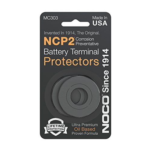

I've used Super Start Battery Terminal Protectors from O'Reilly's Auto Parts. Part #:01396
They come in a package of 2 that have a couple of different size felt washers pre-cut in each. Just separate them to find the right size for your linkage posts.
Grease them with some white lithium grease.
Or--this from Walmart:
NOCO Battery Terminal Protector, MC303ST
