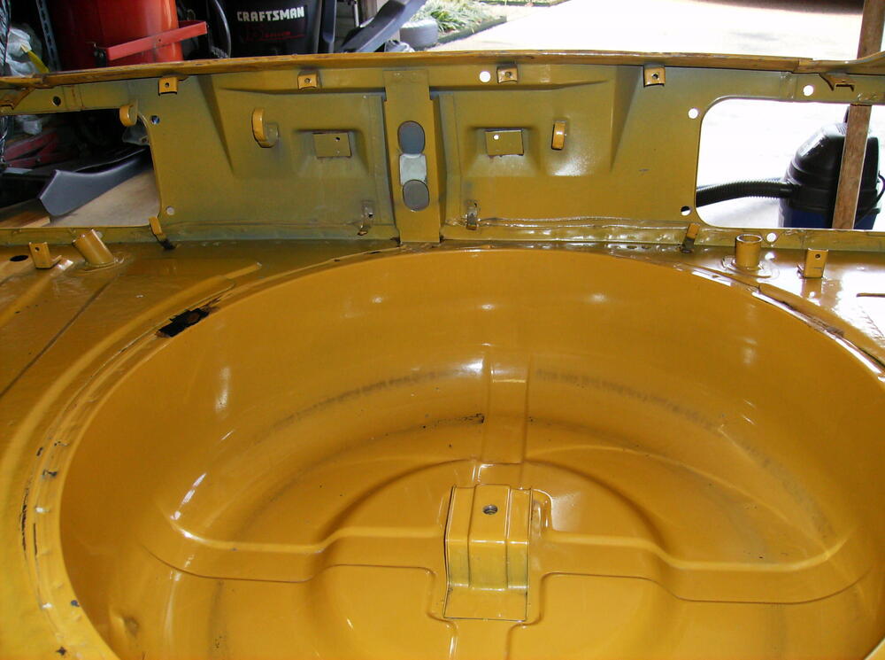

On left hand drive cars, the tank is mounted off center towards the passenger side and the spare tire is off center towards the drivers side
Edited by Patcon
https://www.classiczcars.com/forums/topic/66162-wheelwell/#findComment-633286
The thing that freaked me out was the day I discovered the hatch lock striker bar isn’t in the center of the slam panel. The release button up on the hatch deck is in the middle, but not the actual catch
Sometimes we assume symmetry where none exists.

Ah, but relative to Left and Right hand sides of the car, not 'Driver' and 'Passenger'...
And of course, all this is Domino Effect. The fuel tank is offset to the Right hand side because the exhaust is on the Left hand side of the car, because the exhaust manifold is on the Left hand side of the engine. Design Concession in action.

I was originally going to reference left and right but was concerned that might cause confusion based on whether they knew that was based on looking from the rear of the car
https://www.classiczcars.com/forums/topic/66162-wheelwell/#findComment-633321
We could go to what Mariners use... Port = Left side of car when looking to the front of the car from the rear and Starboard = Right side of car when looking towards the front of the car from the rear.  🤪
