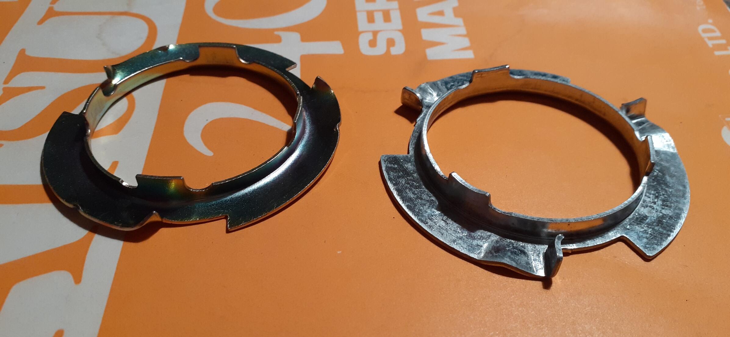

A new Z lock ring from ZCarDepot is on the left. The Honda lock ring seems to have the same inner and outer diameters as the Z lock ring. It only has 3 inner tabs as opposed to the 4 on the Z lock ring.
I plan on trying the lock ring on an old tank in the near future to verify fit. Given that the 240Z lock rings are cheaper, there isn't a need to switch, but we never know when supply will dry up.

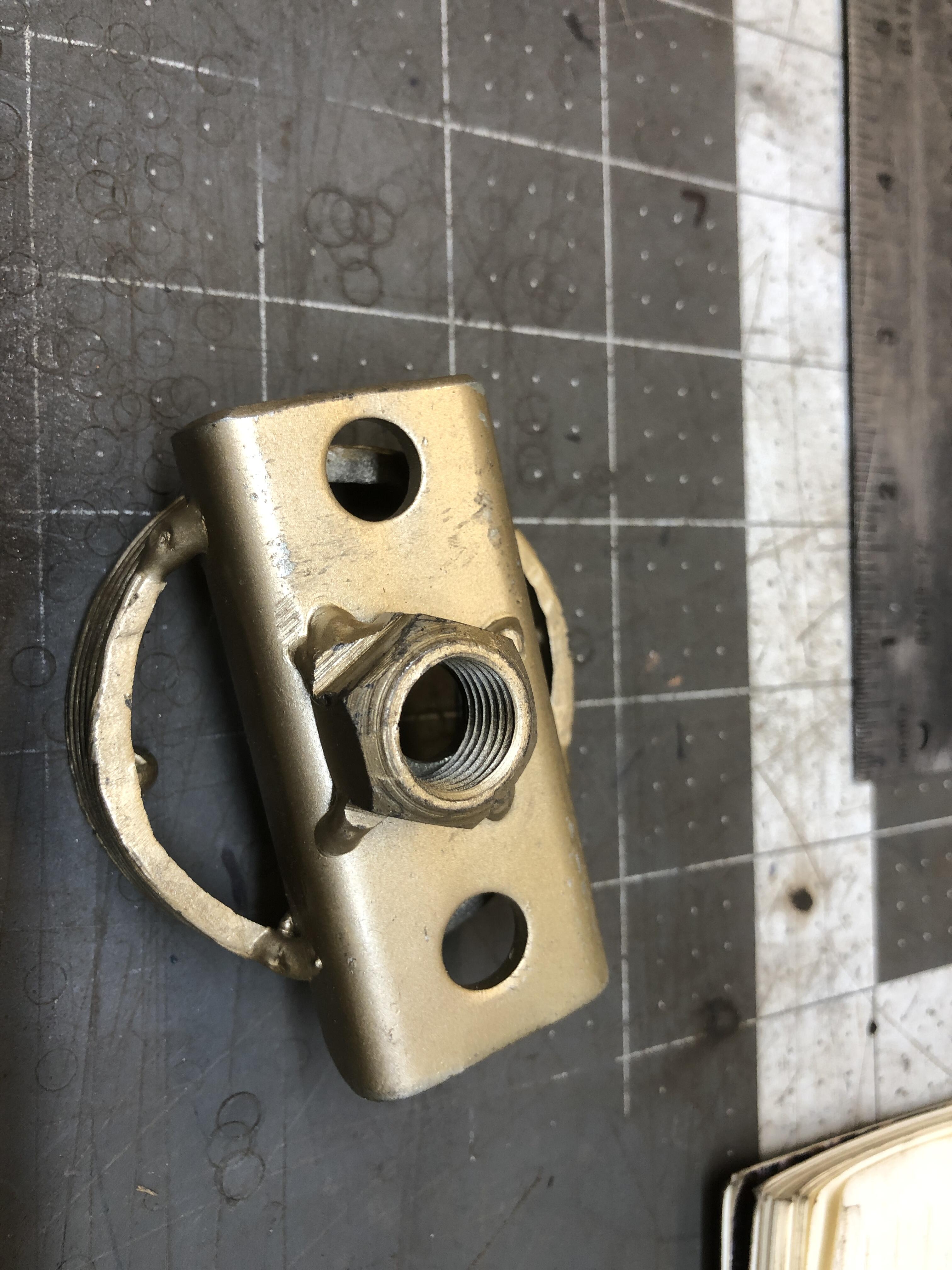

As for a lock ring tool, I decided to make one myself.
A friend who has worked on a lot more Z cars than I have told me he made a similar one.

Here's the follow-up.
I made a tool like @dmorales-bello did out of a Schedule 40 threaded cap. The downside is that it didn't fit with the tank strap in place. The good news is that the angle iron tool I made worked very well.

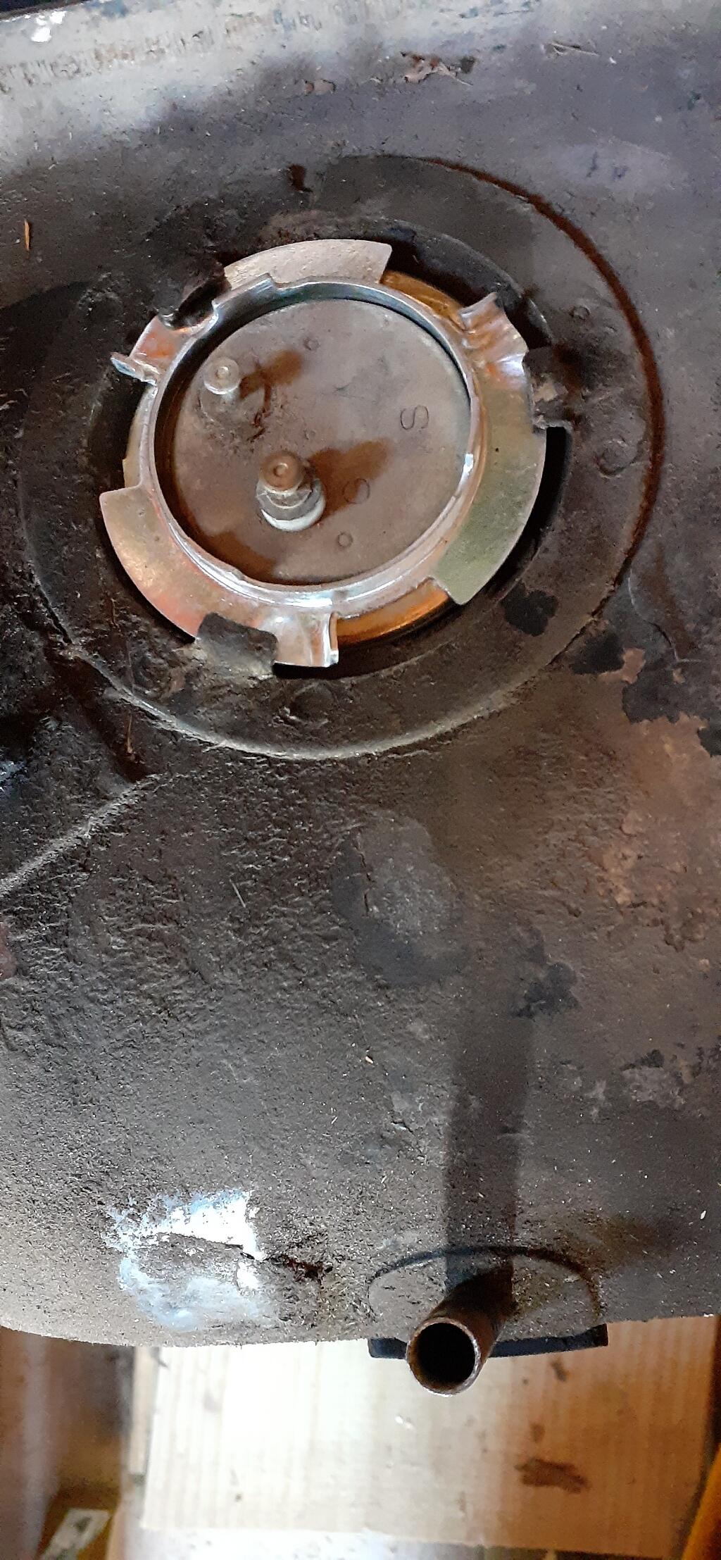

It looks like I pinched the o-ring on the sender when I installed it. I used a new o-ring, and I haven't seen a leak.
I tried the Dorman lock ring on my old tank. It had to rotate to the bump to have enough pressure to stop moving.
I definitely prefer the Nissan lock rings, but it's good to know of alternatives should the good ones dry up.
