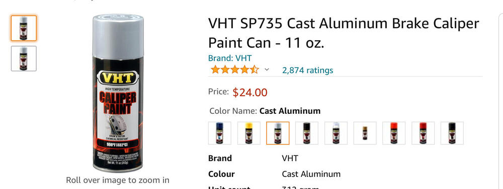

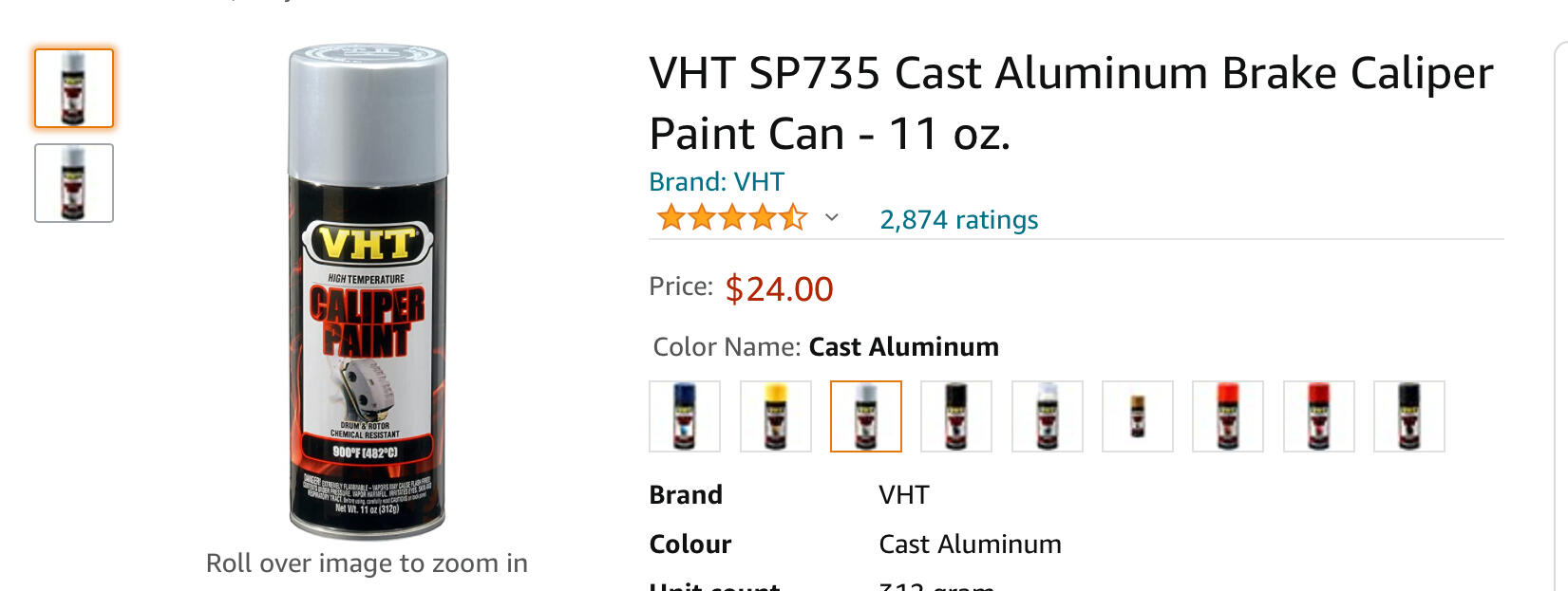

December 30, 20213 yr comment_633679 Glass beads will work, as will a wire brush. Brass or SS. Cleans up aluminum very nicely. Then an oil based sealer like Gibbs to preserve the finish. I’ve even used the cast aluminum caliper paint from VHT. Link to comment https://www.classiczcars.com/forums/topic/66196-wanted-nikki-271070-fuel-pump/#findComment-633679 Share on other sites More sharing options...
December 30, 20213 yr Author comment_633684 That is good scoop. I do not have ready access to a blaster…how about a Tumbler? Will that work? The VHT paint is a good fall back…in stock at my local Autozone. Thanks Jim Link to comment https://www.classiczcars.com/forums/topic/66196-wanted-nikki-271070-fuel-pump/#findComment-633684 Share on other sites More sharing options...

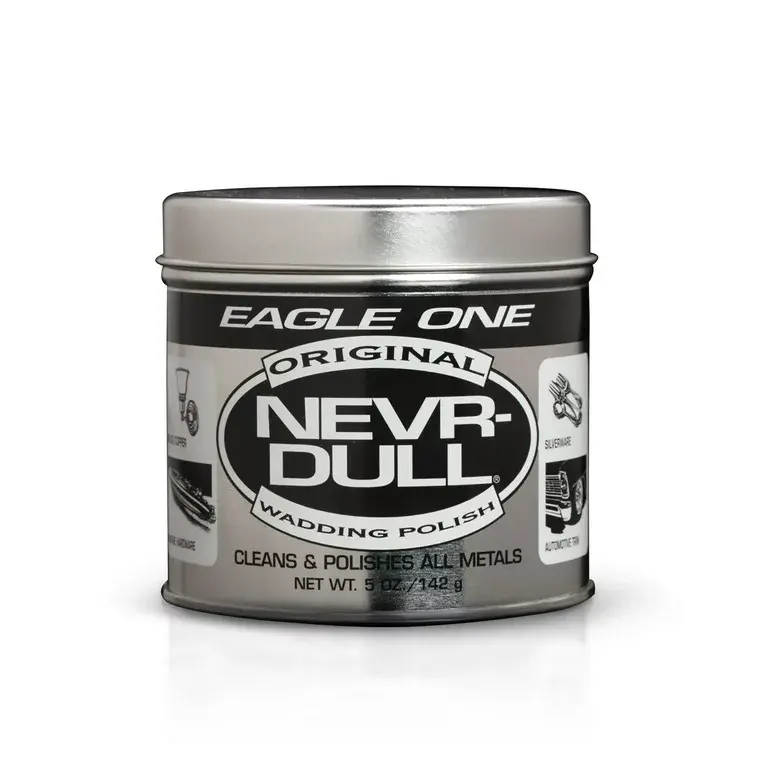

January 23, 20223 yr comment_634787 I used this on my last SU rebuild and they look great. It's a polishing wad, whatever that means, wipe it on then buff it off. Link to comment https://www.classiczcars.com/forums/topic/66196-wanted-nikki-271070-fuel-pump/#findComment-634787 Share on other sites More sharing options...
