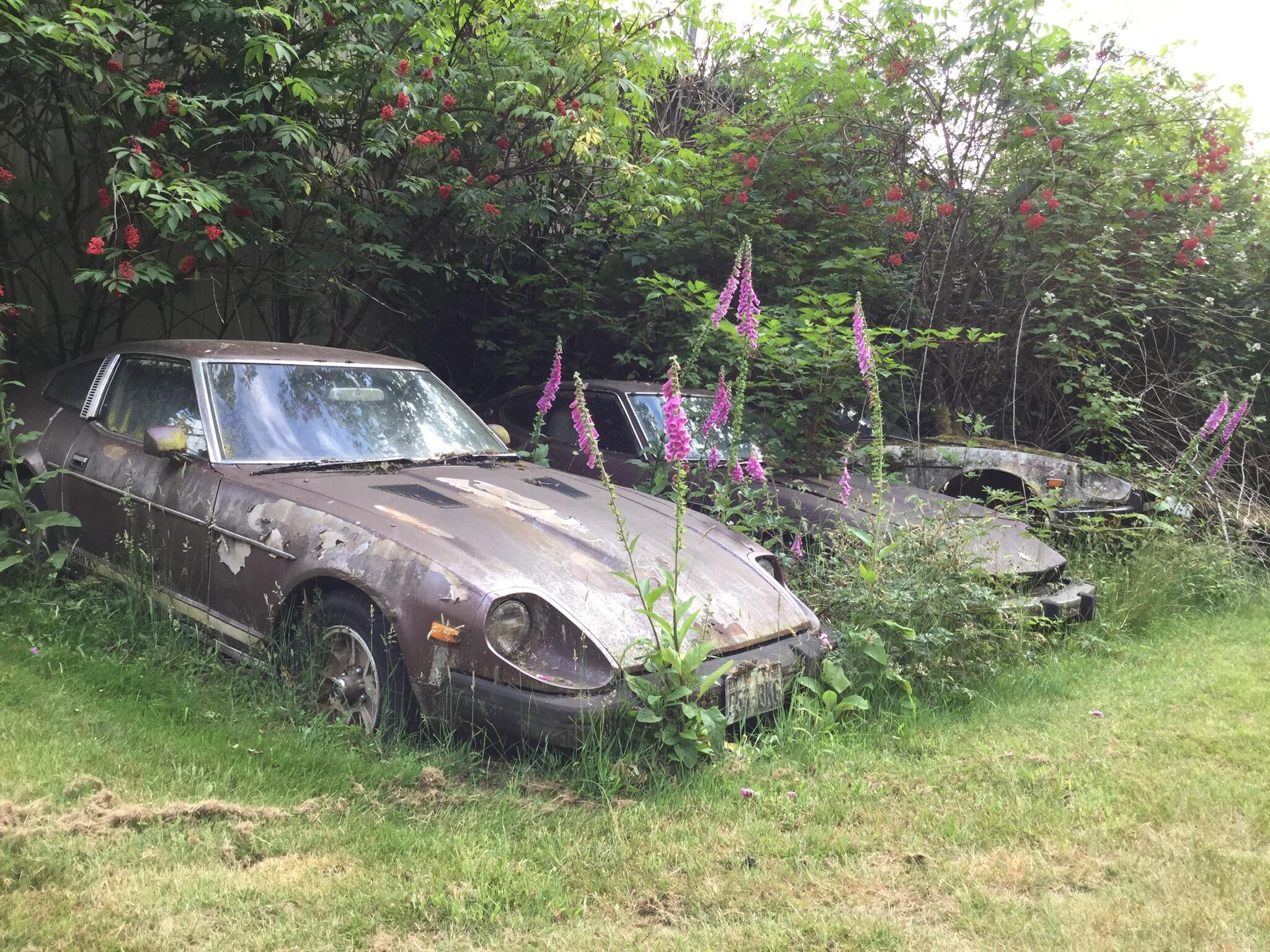

August 17, 20222 yr comment_644099 On 8/17/2022 at 1:41 AM, SteveJ said: Actually I’m going to be offering them for sale soon. On 8/17/2022 at 8:08 AM, dutchzcarguy said: Whhahaha... they are standing there for some time.. a tree growing out the engineroom??? wow... It is a shrub, a woody sort of thing that grows on the forest floor around here. The 280Z also had one, growing up through the vent in the hood. I left these eight Z cars here 18 years ago, when we bought this property. The 280ZX, and the 280Z were both running when I parked them. Link to comment https://www.classiczcars.com/forums/topic/66201-2022-what-did-you-do-towith-your-z-today/?&page=7#findComment-644099 Share on other sites More sharing options...
August 17, 20222 yr comment_644100 18 years is a long time to sit in the grass... Link to comment https://www.classiczcars.com/forums/topic/66201-2022-what-did-you-do-towith-your-z-today/?&page=7#findComment-644100 Share on other sites More sharing options...
August 17, 20222 yr comment_644106 On 8/17/2022 at 10:59 AM, Patcon said: 18 years is a long time to sit in the grass... Actually the brush grew up around them, and they were mostly hidden from view. Link to comment https://www.classiczcars.com/forums/topic/66201-2022-what-did-you-do-towith-your-z-today/?&page=7#findComment-644106 Share on other sites More sharing options...
August 17, 20222 yr comment_644110 Lawn art....better than those plastic pink flamingos. 😎 Link to comment https://www.classiczcars.com/forums/topic/66201-2022-what-did-you-do-towith-your-z-today/?&page=7#findComment-644110 Share on other sites More sharing options...
