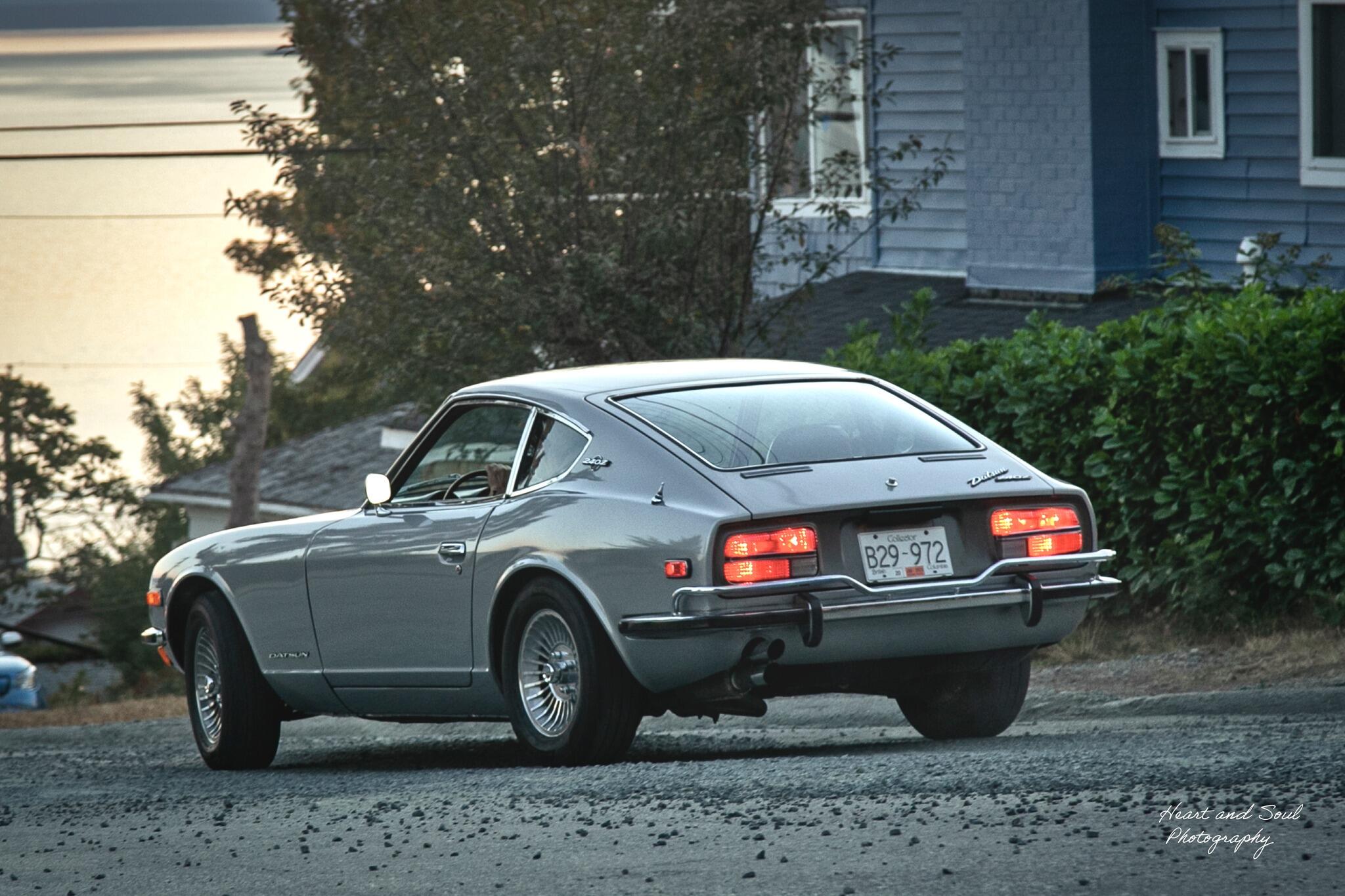

Went on a memorial cruise for a local car guy a few weeks ago and just found this photo posted. Nice photo of my car.
