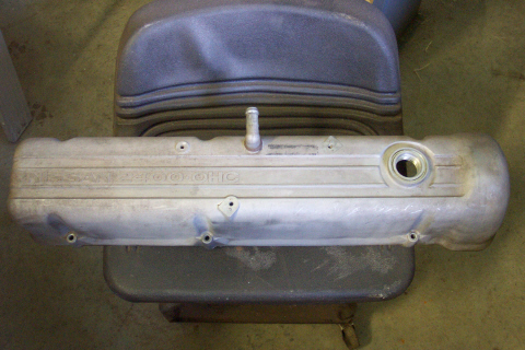

June 13, 200321 yr comment_40864 Victor has it right.. you have so sand it smooth or you'll never get that reflective finish that looks so good. You'll end up with shiny matte surface if you don't sand. I just did one of my valve covers and it is a lot of work. I used a buffing set that I bought from Eastwoods with the stand, motor, wheels and compounds. Plus it took a lot of sanding with the air sander, Dremel tool and by hand as well. It isn't as nice as I'd like, but it looks better than it did when I started. Here's the before pic. Link to comment https://www.classiczcars.com/forums/topic/6621-polishing-carbs-intake-and-valve-cover/#findComment-40864 Share on other sites More sharing options...

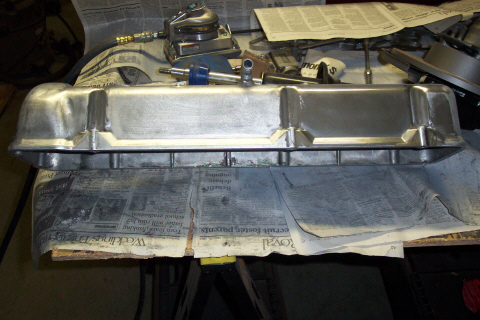

June 13, 200321 yr comment_40865 And after about 4 hours or more of work. Had to keep re-sanding sections that didn't meet my approval, the left side has just been sanded with 220 and the right side is after a quick buffing to check the finish. You have to be very careful not to sand the curves wrong and end up with flat spots... Takes some patience on these sections... BTW, for those of you who want to try it, Eastwoods has a pretty good video that explains the steps as well as all the tools to do the job the easy way.... Link to comment https://www.classiczcars.com/forums/topic/6621-polishing-carbs-intake-and-valve-cover/#findComment-40865 Share on other sites More sharing options...

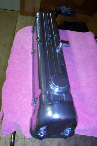

June 13, 200321 yr comment_40866 Finished.. I'd rate it a B+ for a first attempt. I learned a lot of little tricks that should make the second time go faster with better results.... Link to comment https://www.classiczcars.com/forums/topic/6621-polishing-carbs-intake-and-valve-cover/#findComment-40866 Share on other sites More sharing options...
